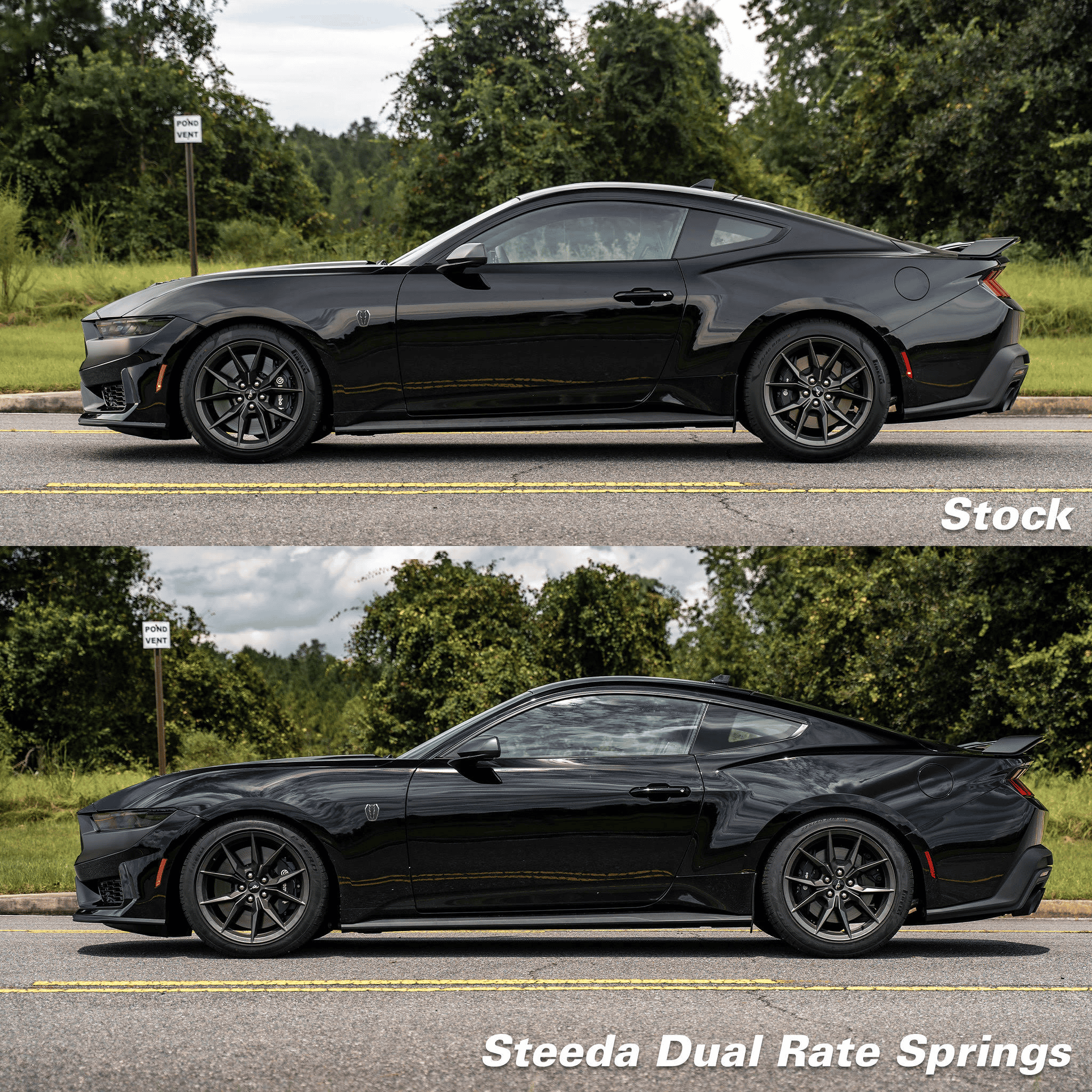

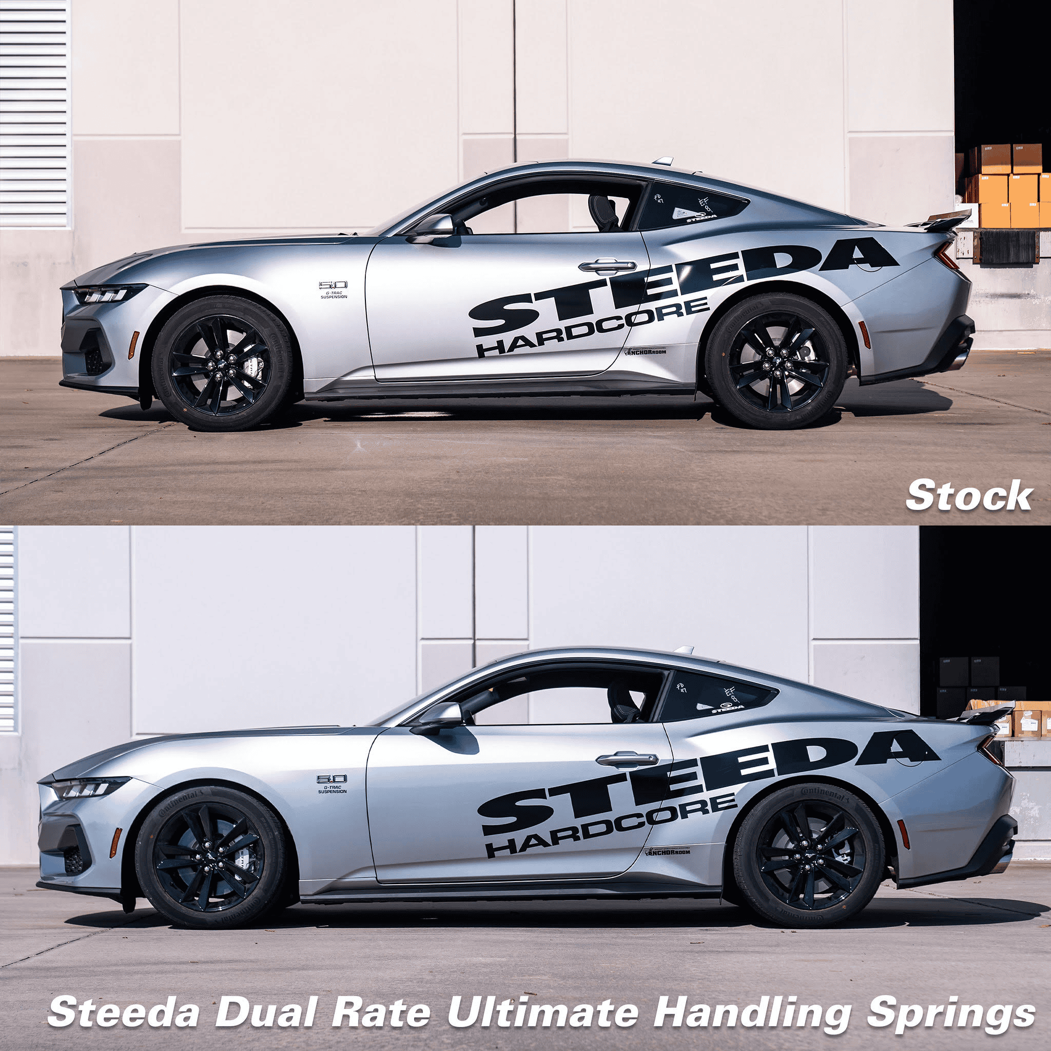

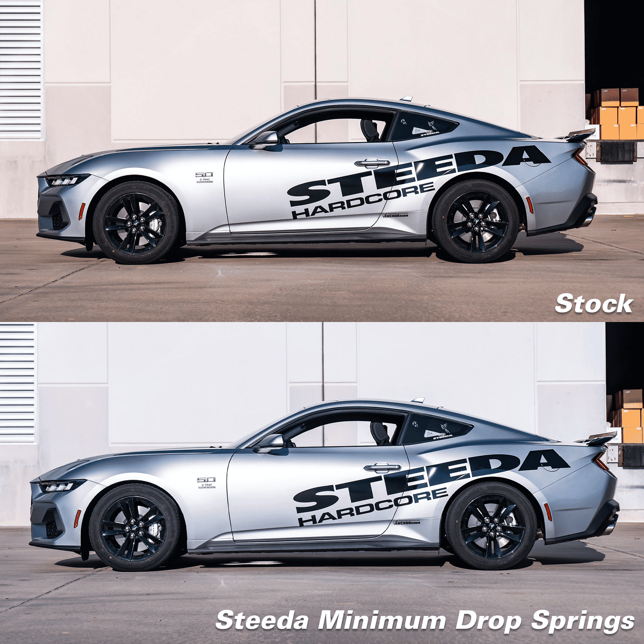

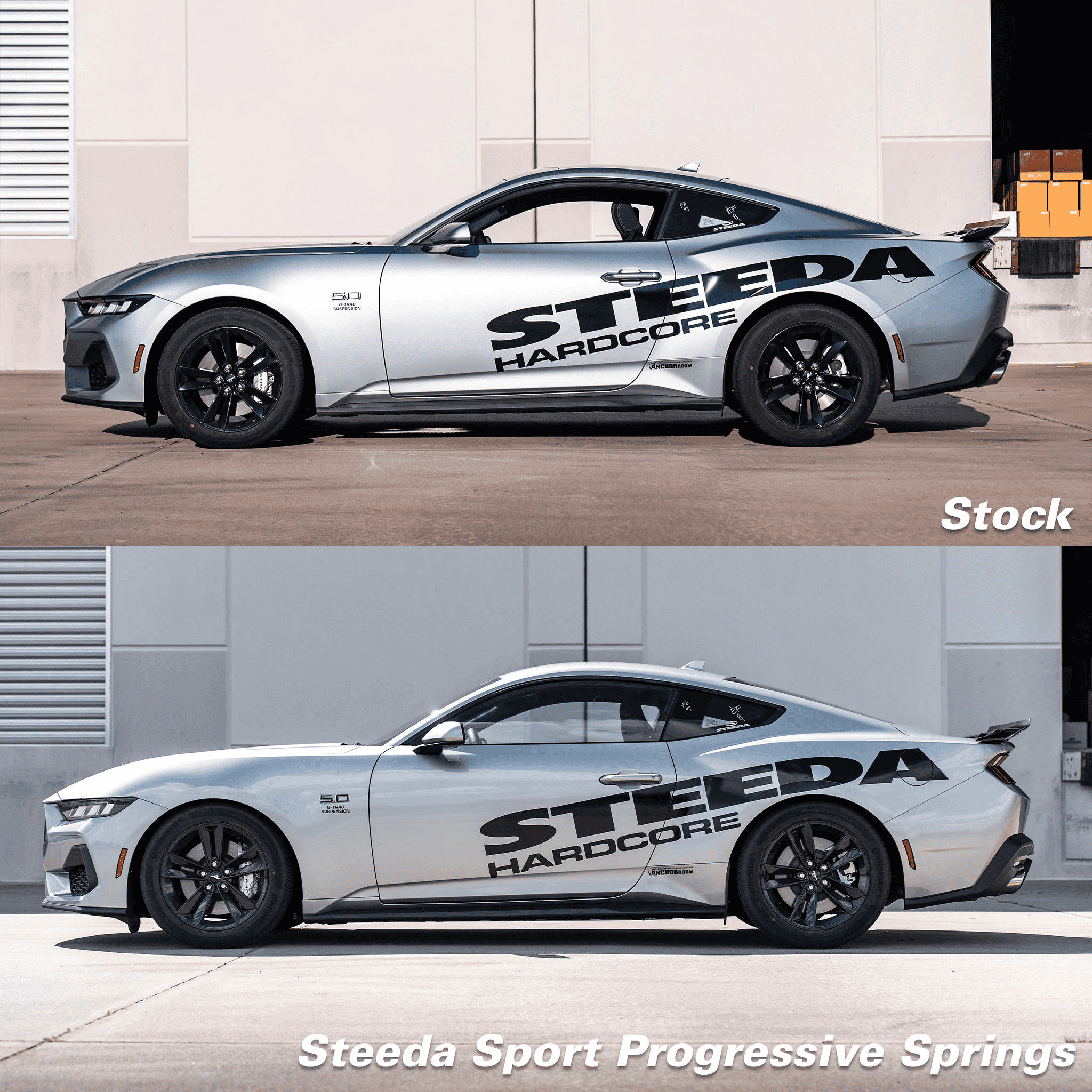

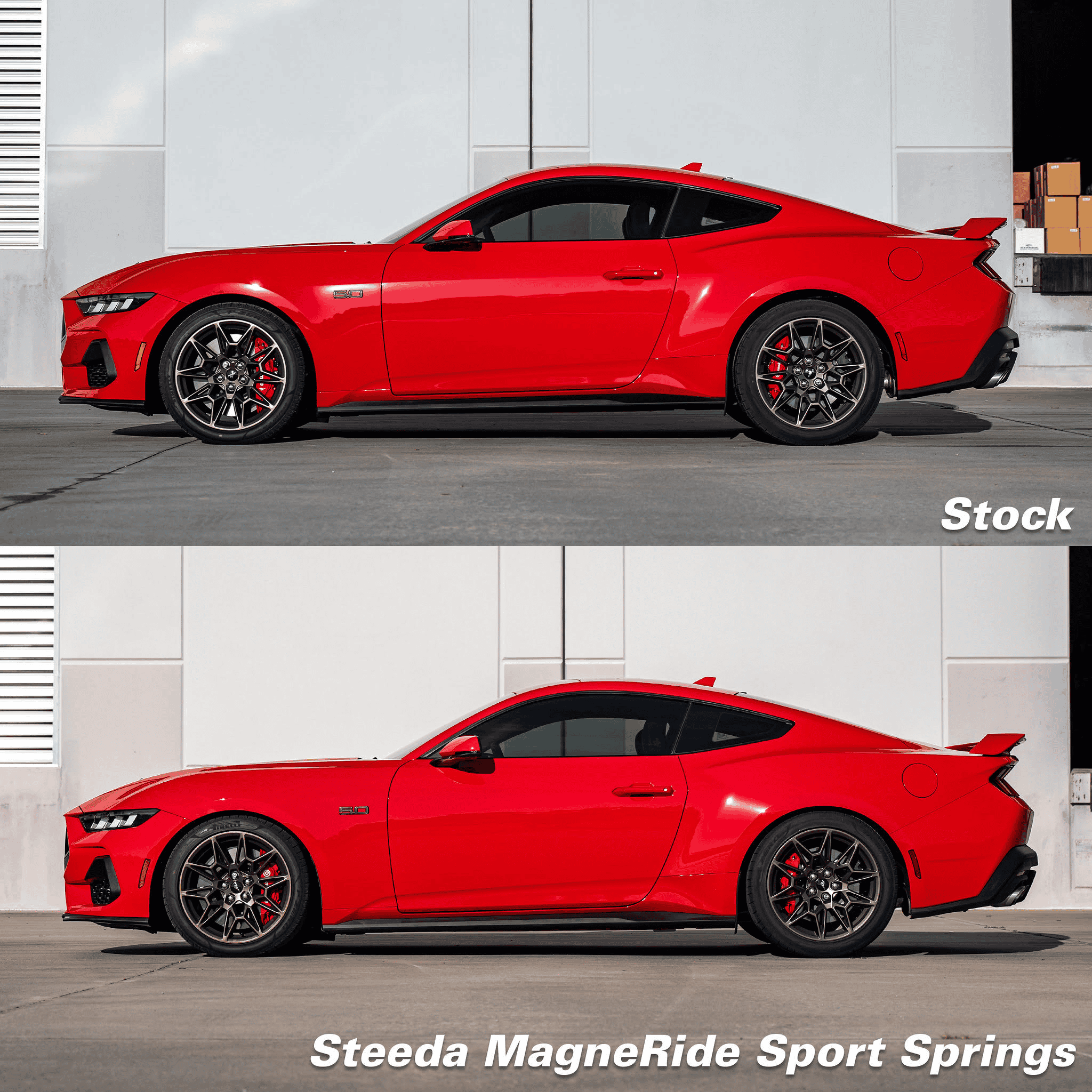

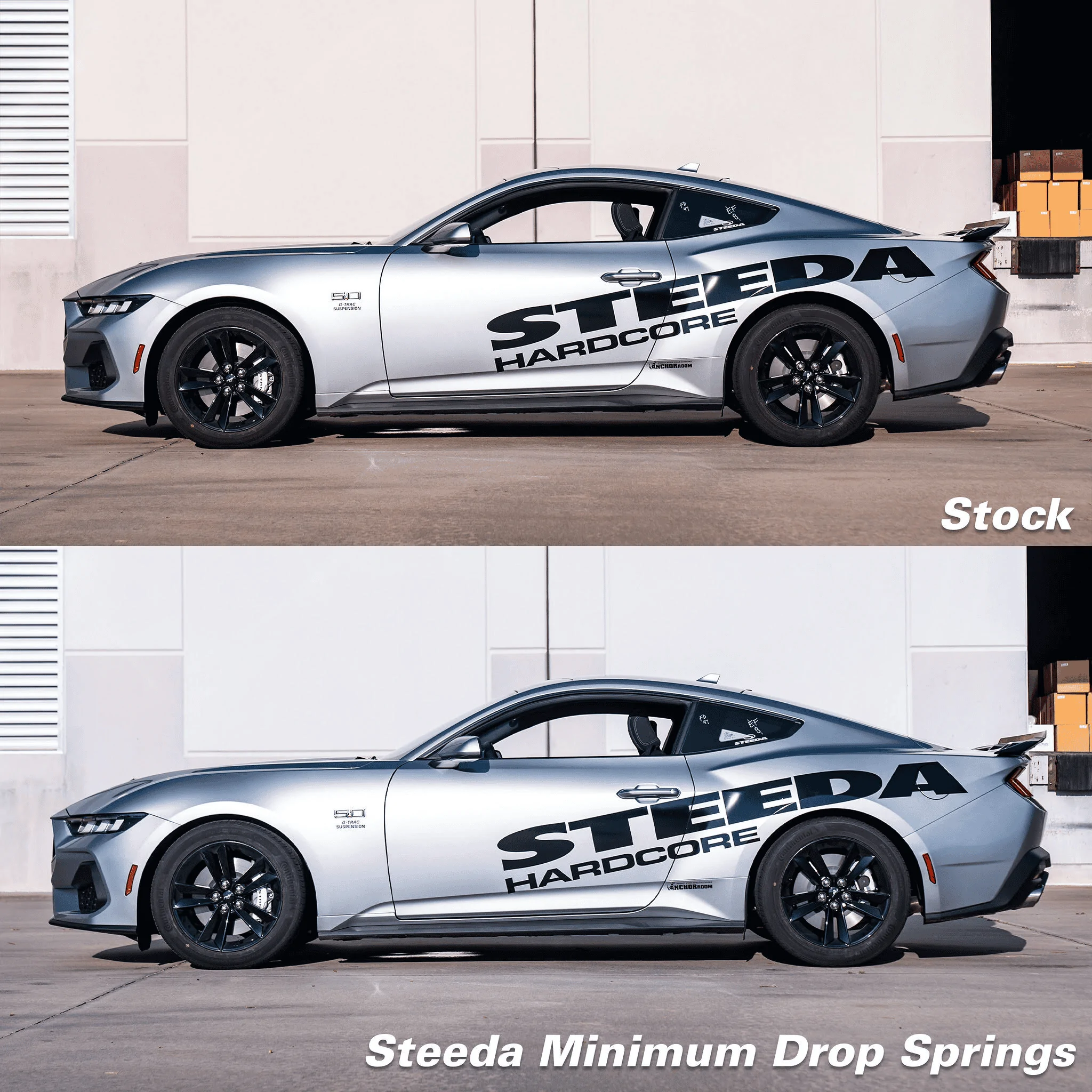

Greetings everyone,
Steeda has been hard at work conducting extensive testing and successfully installing springs on the latest S650 Platform. We are pleased to announce the confirmed fitments for the Sport, Minimum Drop, Dual Rate (applicable to both Magneride and non-Magneride models) - check out our selection of S650 parts here - https://www.steeda.com/2024-mustang-parts
Steeda Mustang Sport Lowering Springs - Progressive (2015-2024)
https://www.steeda.com/steeda-mustang-progressive-sport-lowering-springs_555-8210
555-8210
Front Drop: 1.3” / Rear Drop: 0.8125”
S650 Mustang Steeda Lowered - Sport / Minimum / Dual Rate Springs! 1695773419025
Steeda Mustang Minimum Drop Lowering Springs - Linear (2015-2024)
https://www.steeda.com/steeda-555-8223-s550-minimum-drop-lowering-springs
555-8223
Front Drop: 0.75” / Rear Drop: 0.375”
S650 Mustang Steeda Lowered - Sport / Minimum / Dual Rate Springs! 1695773433627
Steeda Mustang Dual Rate Ultimate Handling Lowering Springs (2015-2024)
https://www.steeda.com/steeda-555-8246-s550-dual-rate-lowering-springs
555-8246
Front Drop: 1.3” / Rear Drop: 0.75”
S650 Mustang Steeda Lowered - Sport / Minimum / Dual Rate Springs! 1695773463417
Steeda Mustang MagneRide Dual Rate Ultimate Handling Lowering Springs (2015-2024)
https://www.steeda.com/mustang-magneride-lowering-springs_555-8243
555-8243
S650 Mustang Steeda Lowered - Sport / Minimum / Dual Rate Springs! 1695773483076
Steeda Mustang MagneRide Sport Lowering Springs (2015-2024)
https://www.steeda.com/steeda-555-8242-s550-magneride-sport-lowering-springs
555-8242
Front Drop: 0.8125” / Rear Drop: 0.8125”
S650 Mustang Steeda Lowered - Sport / Minimum / Dual Rate Springs! 1695773501415

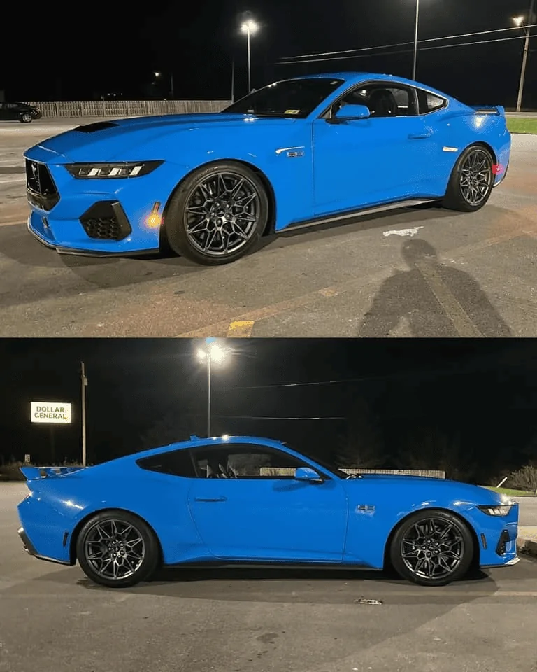

Some more lowering springs were installed!
Another #S650 lowered on Steeda Sport Progressive Springs
S650 Mustang Steeda Lowered - Sport / Minimum / Dual Rate Springs! 2705
S650 Mustang Steeda Lowered - Sport / Minimum / Dual Rate Springs! 1695687824990
HWill
Aug 14, 2015
277
165
Buckeye, Arizona
Nice, I'm looking at buying these Sport Progressive Springs tonight. Does this vehicle have spacers installed? And do you recommend any additional upgrades for a PP 5.0L?
tj@steeda
tj@steeda
Mar 21, 2014
51
2,002
188
2015 Steeda Mustang
It does not have spacers & we have not done our testing yet to see what different spacers will yield different results.
We always highly recommend the camber plates - from the factory, the OE components are designed without any camber adjustment for alignment purposes.
With the addition of our new adjustable camber plates on your Mustang, you will be able to correct excessive negative camber and increase your front steering response, and running the correct camber will eliminate uneven tire wear.
Those camber plates can be located here - https://www.steeda.com/steeda-s550-mustang-camber-plates-15-16-all-555-8139.html
Best Regards,
TJ
