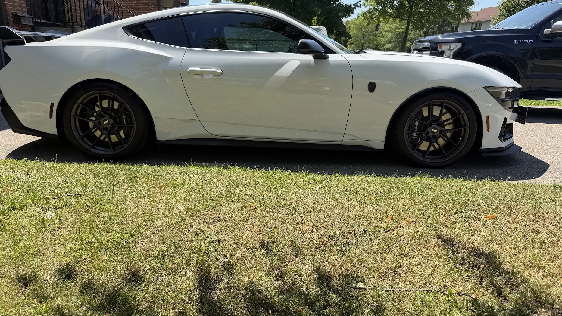

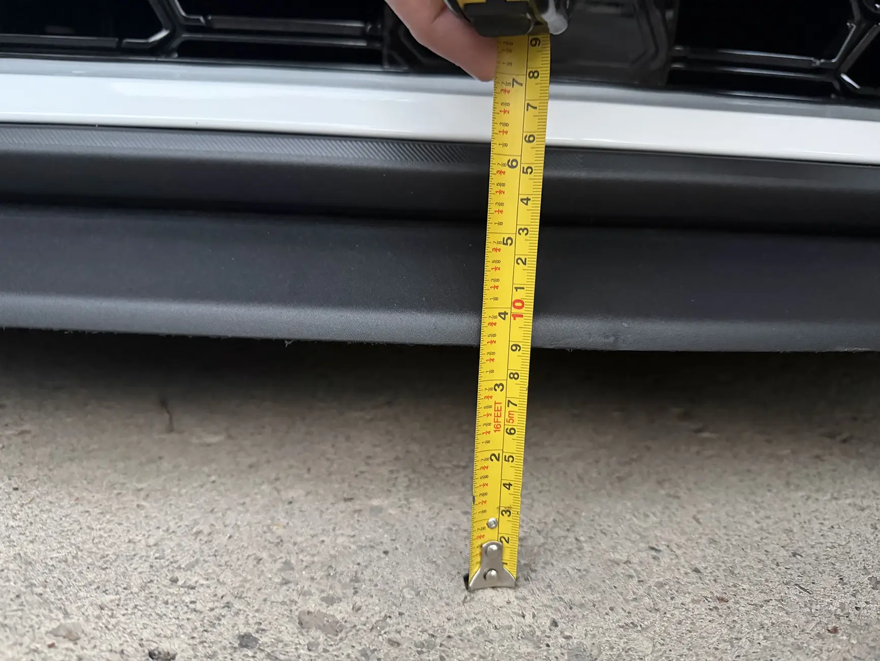

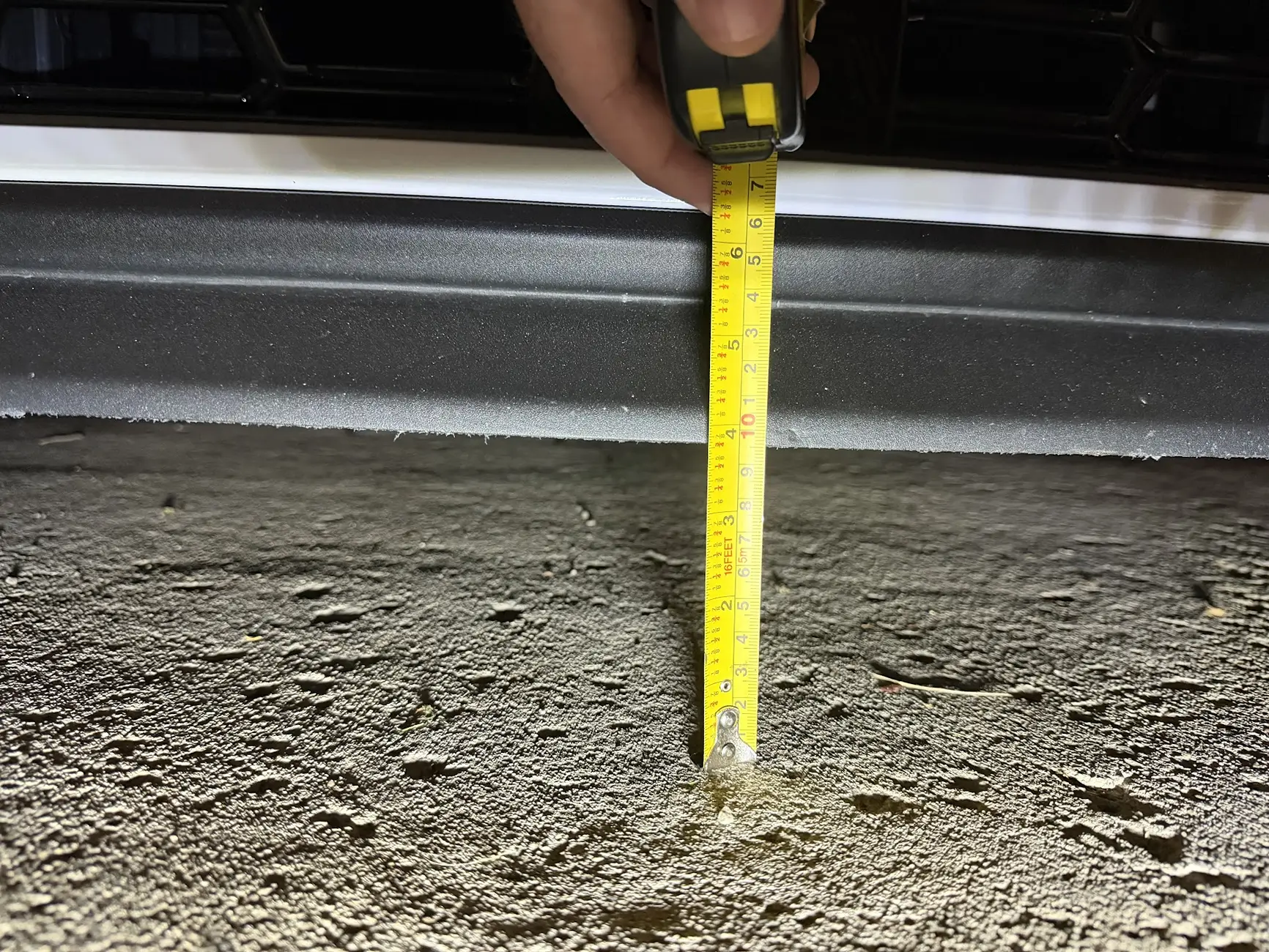

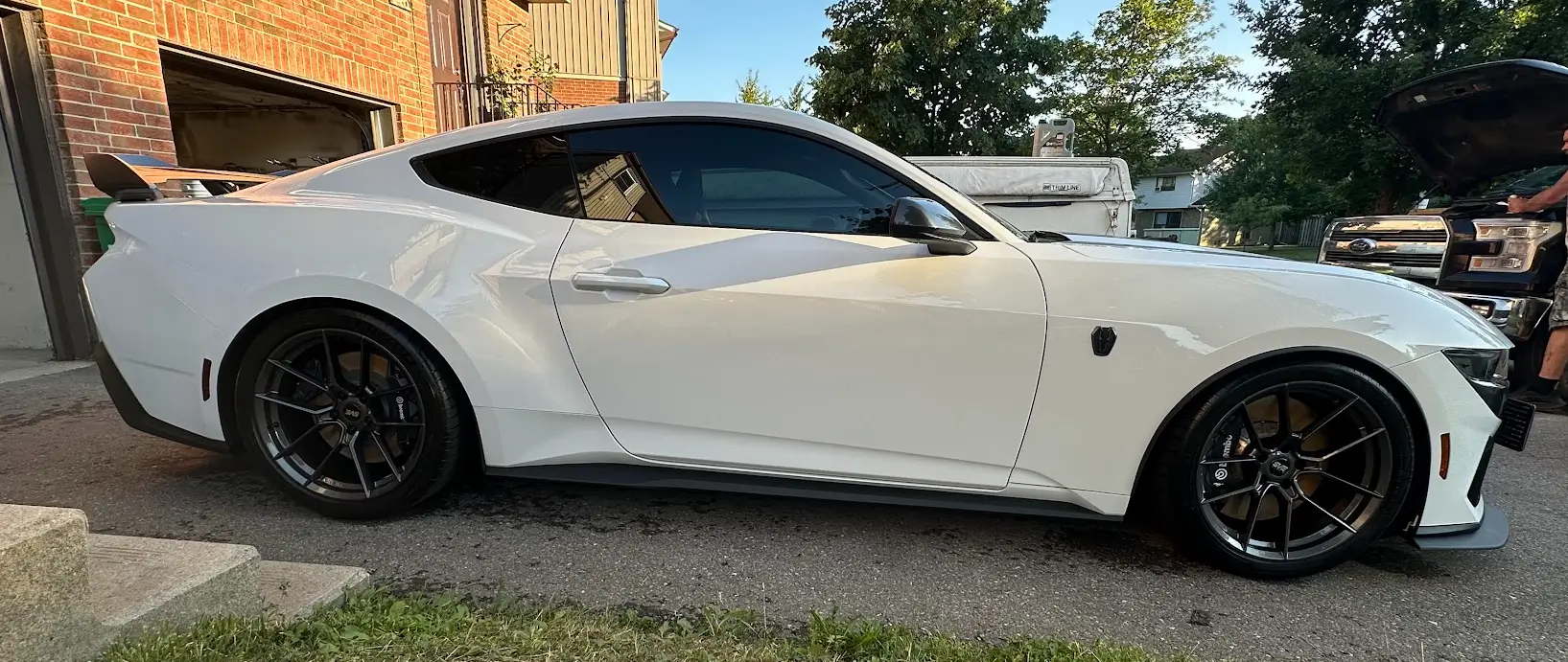

I am lower, but the dual rates are great.
Curious, did you measure the drop? Only ask because I'm think the dual rate springs in concert with the Steeda spacer kit might allow me to keep the ride height (or just about) and support the SC.
Ninjak
Posting from the Shadows
Aug 19, 2013
1,491
476
The Shadows
Curious, did you measure the drop? Only ask because I'm think the dual rate springs in concert with the Steeda space kit might allow me to keep the ride (or just about) and support the SC.
I'll get a measurement for you.
