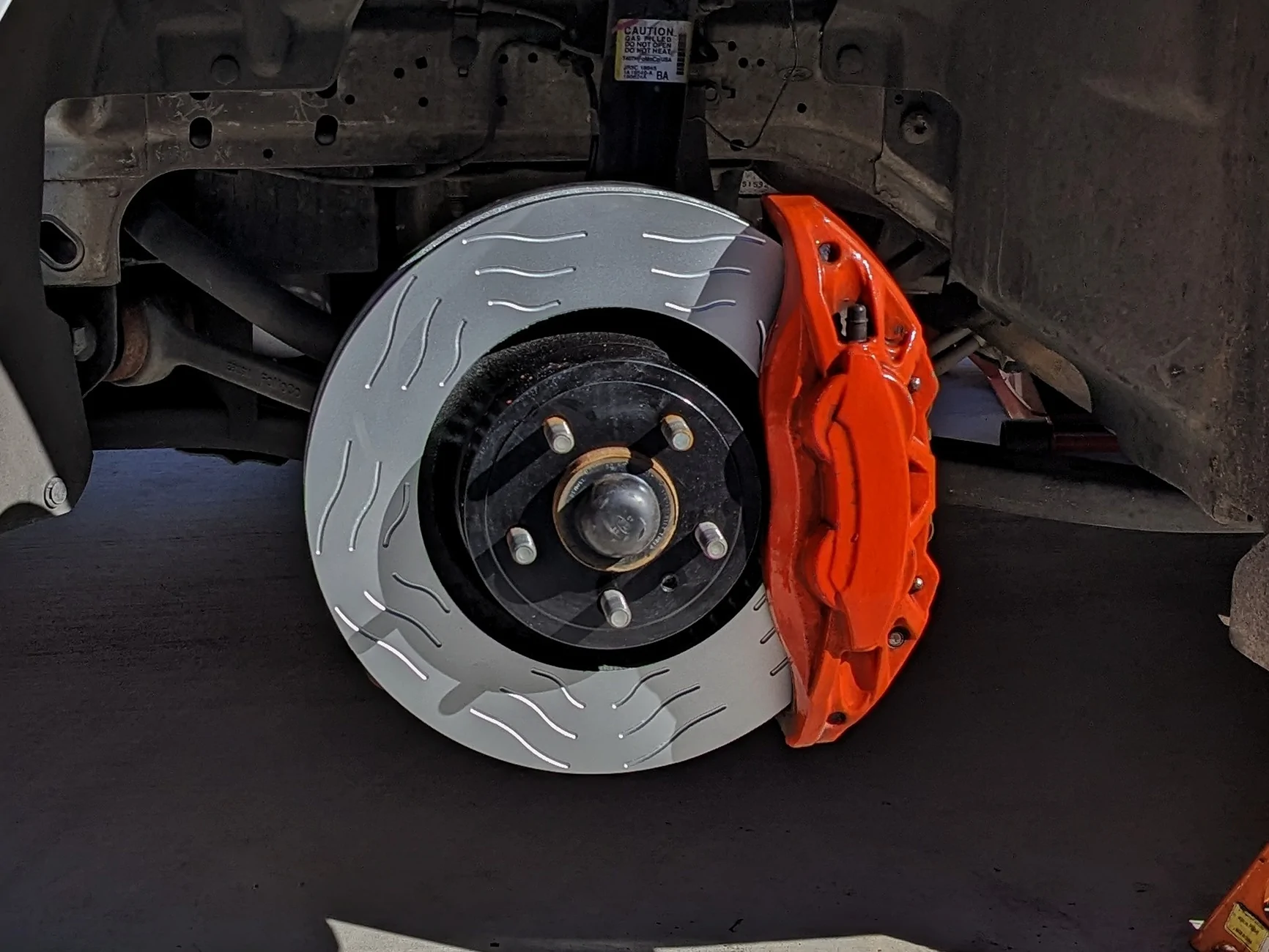

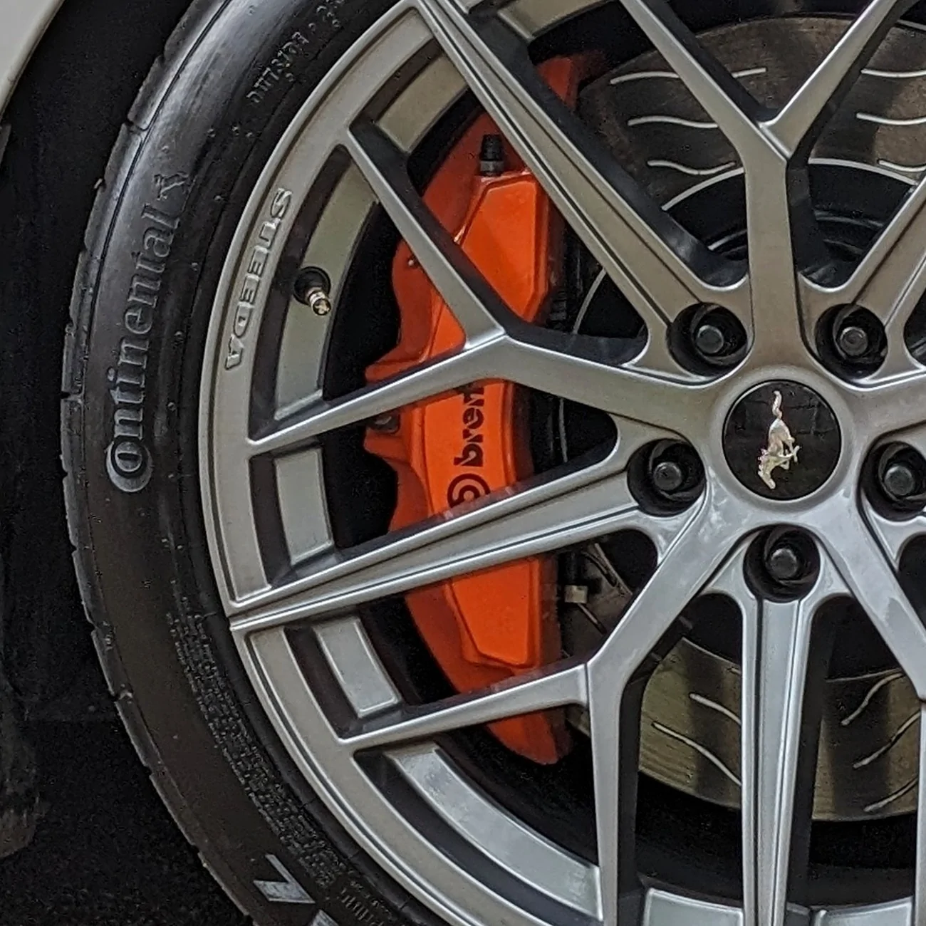

On the S550 there weren't any 4 piston Brembos. I think they were made by Continental. Stopping power was actually pretty decent but they overheated more quickly. I upgraded my brake lines to steel braided ones. Pics of a base 4 piston GT brake and the Brembo replacement.
S650 Mustang Has anyone replaced the 4 piston front brakes with 6 piston? 1000002092
S650 Mustang Has anyone replaced the 4 piston front brakes with 6 piston? 1000015349
