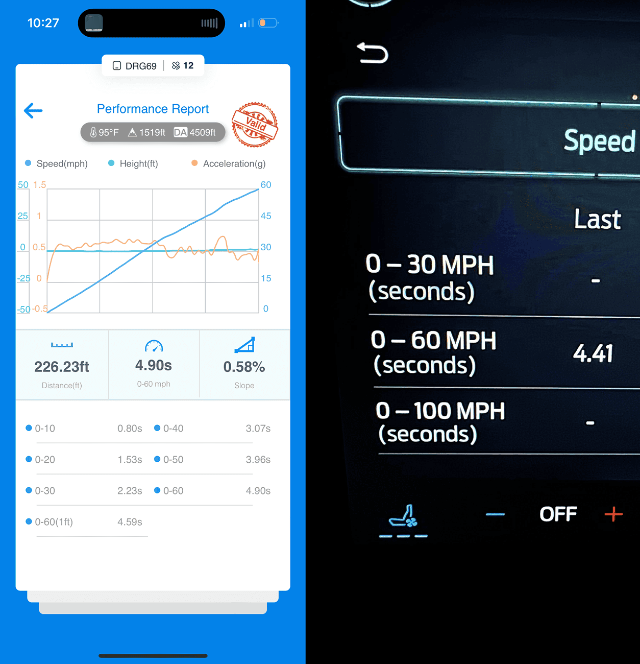

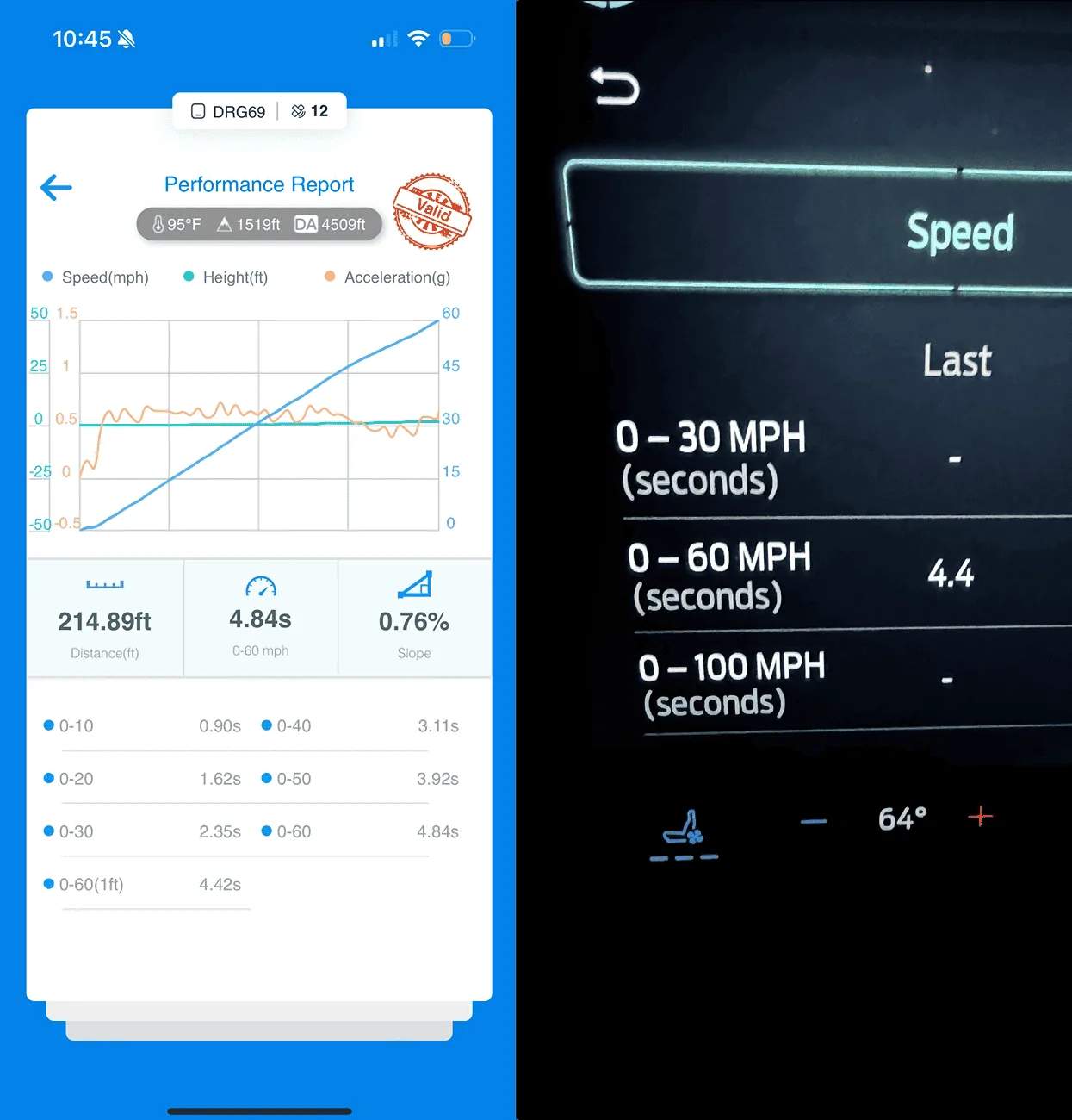

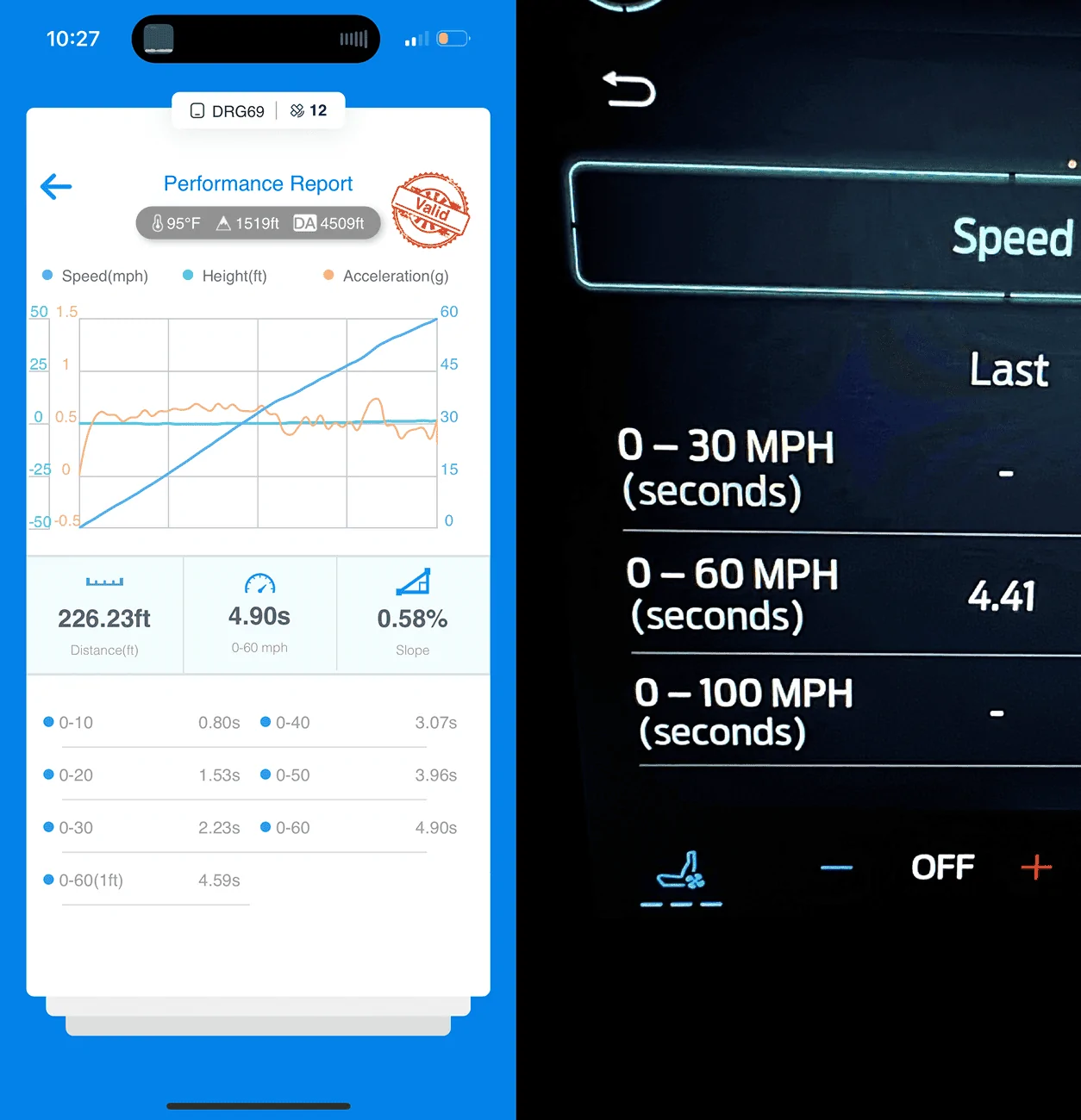

There's been some contention lately on the accuracy of Ford's Sync4 performance timers built into the car's infotainment system. (See thread: "S650 is fast")
Many people know the displayed numbers are bogus, but I thought I'd compare them to GPS readouts to put the nail in the coffin.
I've even seen established personas like StangMode use these in-car timers and frankly it's embarrassing.
2024 Mustang GT Premium Non-PP, A10, 3.55:1 ratio.
275/35/20 front tires, 315/30/20 rear tires. These are within 0.4% and 1.1% total circumference delta to the 265/35/20 that came factory with my car and that my speedometer is presumably calibrated to.
  • 95 degree heat even at 11:00pm
  • 4,500+ density altitude
  • 91 octane fuel.
  • 37psi in the tires
  • Arizona, yikes.
Virtually the least ideal possible scenario - every variable is pretty much a mitigating factor for performance. Yes your car will likely be quicker.
Results:
S650 Mustang Debunking the S650 Acceleration Timers & Track Apps speedfile2
S650 Mustang Debunking the S650 Acceleration Timers & Track Apps speedfile1
As you can see, on 0-60 tests alone, the car is claiming you're about 0.5 seconds quicker than you actually are.
I bought this Dragy unit in 2021 and have used it on 70 total 1/4mi passes at Wild Horse Pass Motorsports Park in Chandler, AZ. The Dragy readouts are within 0.02-0.05 seconds and 0.2mph to my printed track timeslips, every time. It's as feasibly accurate as you can get on your own.
What I think is happening: Ford's software is built to extract an estimated 1ft-rollout, possibly from both the 0-60mph and the quarter mile, and then display that figure. If you have aftermarket wheels and tires without recalibrating your speedo, the more inaccurate it will become.

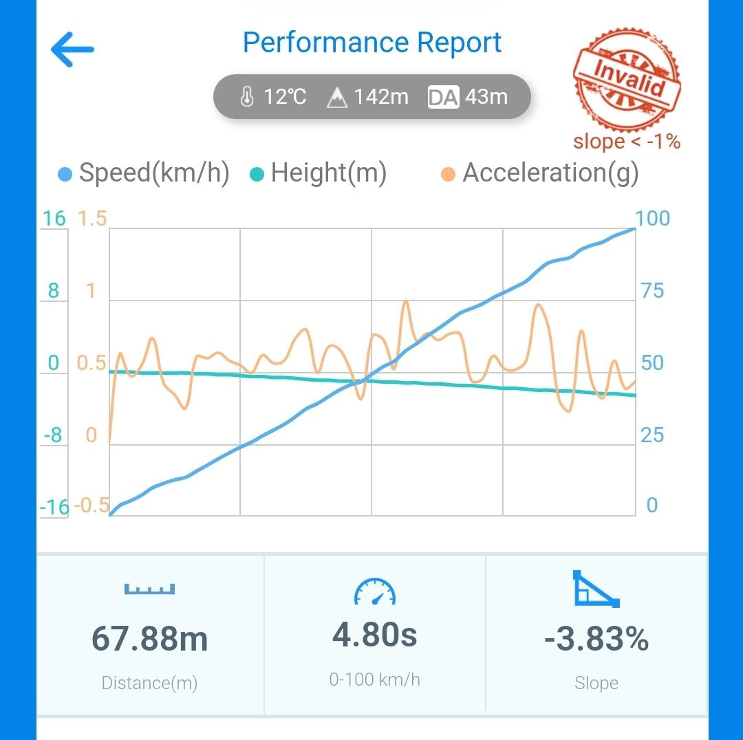

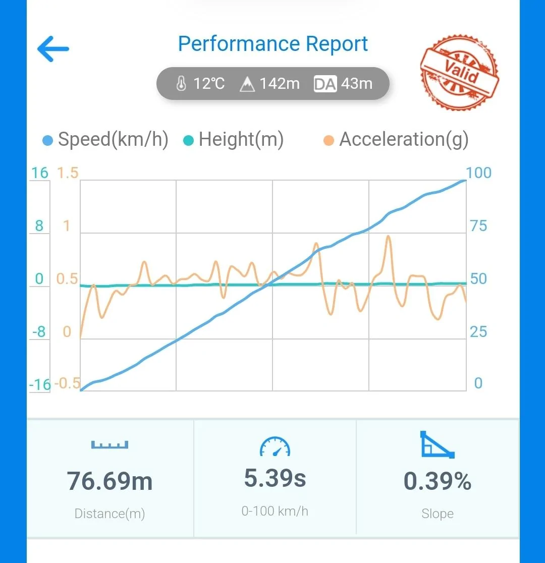

Thank you for that, these look like the numbers I know. And yes the cars themselves usally have 1ft rollout programmed into it while dragy or racebox has not.
I drove the European Dark Horse with 10AT and was quite a bit disappointed of the power output. It's rated about 50hp lower than US model. Measured was 0-100kph, so about 0-62kph, but without huge drop of elevation it was not possible to go below 5 seconds.
95er Benzin drin? 🙈
That's waaay slower than the S550 and as slow as a S550 EU manual... The A10 S650 should do ~4.6 seconds. Still somewhat slow in 2024 but not that slow.

95er Benzin drin? 🙈
I was told Vpower was filled in. heard from another source the 100-200kph run took 10,9s in EU DH which is just not great for the horsepower it should have

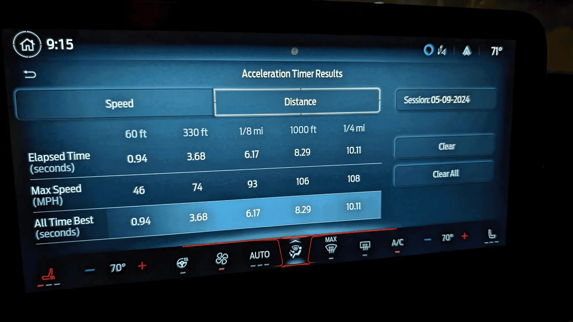

I think there is more to it than just rollout, as this was in a bone stock A10 car with less than 1,000 miles on it. It's clearly horribly inaccurate on every single metric. There was little to no wheel spin on this pass either.
For reference my 2,000 horsepower X275 car doesn't cut a sub 1.0 60 foot.

HAHA wow, that's actually the craziest one I've seen yet... 0.94 60 foot 🤣 might as well be an NHRA Pro Stock. The 10.11 is also wildly off too, by at least ~2 seconds.
