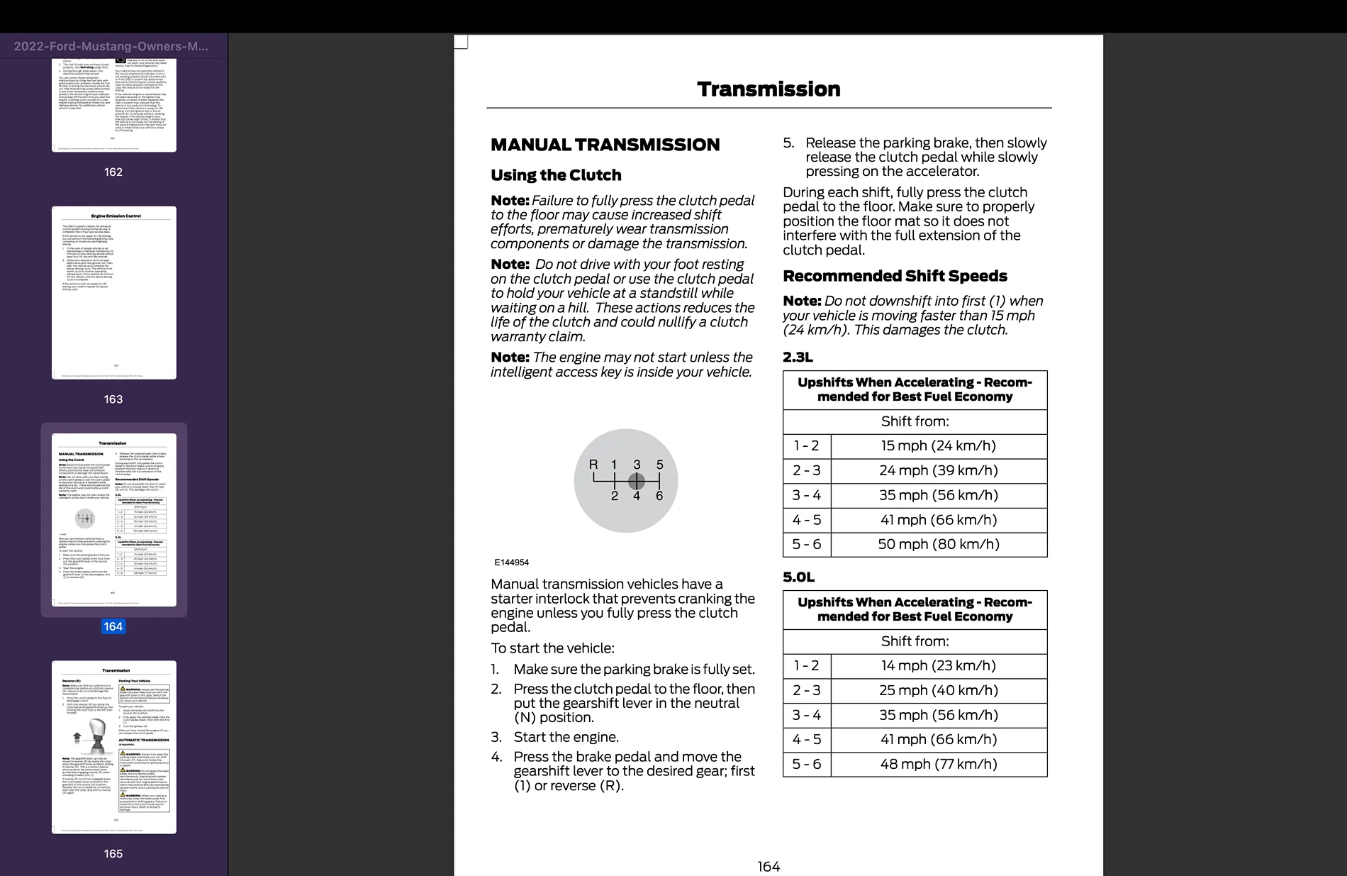

I looked in the 7G manual for shift recommendations for a Manual Transmission and couldn't find any. Looking at the 2022 owners manual, there are some (attached). These are based on speed and not RPM. I think anyone could use these as an initial basis for regular driving in town. These are guidelines and not hard rules. Notice these are also mentioning fuel economy.

those shift recommendations are insane. the shift to 6th at 48 is the most ridiculous. even on the highway I seldom use it except it is really empty and it's just free cruising.
But are they?
Really depends on the driving experience.
Casual drive or a spirited power at the calling drive.
I have the A10 with 3.55 gears, driving 40 miles mostly highway & a little city, the car wants to level out at around 1800rpm at around 65mph. When I'm nice to the throttle, I get around 24mpg; when in sport is goes down with the throttle response given. The car is not bogged down, yet if going up a hill too much, the throttle will require a downshift. So to put all this in perspective, my previous daily driver was a Honda Fit, which was ALL about MPG, cause power at 153HP is lame in comparison. So crusing along with 486HP is a breeze. Heck, I passed a couple of vehicles that couldn't figure out the speed limit and hit 120MPH. :cool:
