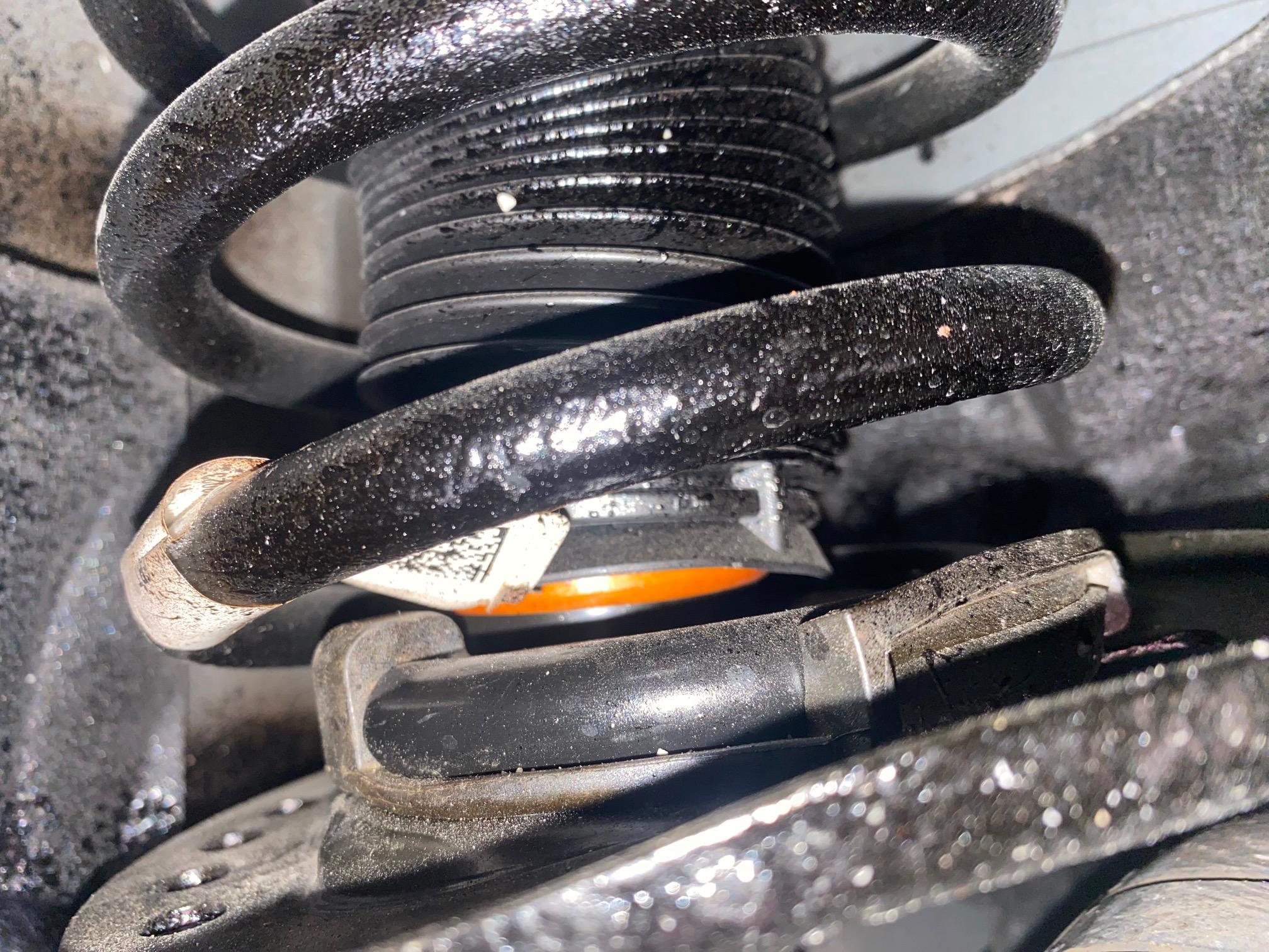

Check that the shipping spacers are out of the springs... some dealers neglect this.

I just checked you can easlie see them in the front they are yellow. I assume the ones in the back are there too but they are much harder to see. I have an appointment with the service manager at 0800 tommorrow. Gives you faith in their shop huh. I wonder how many more are running around like this? Dealer removed the shipping spacers all the noises are now gone and the ride is much better and the car sits 1/2 an inch lower.

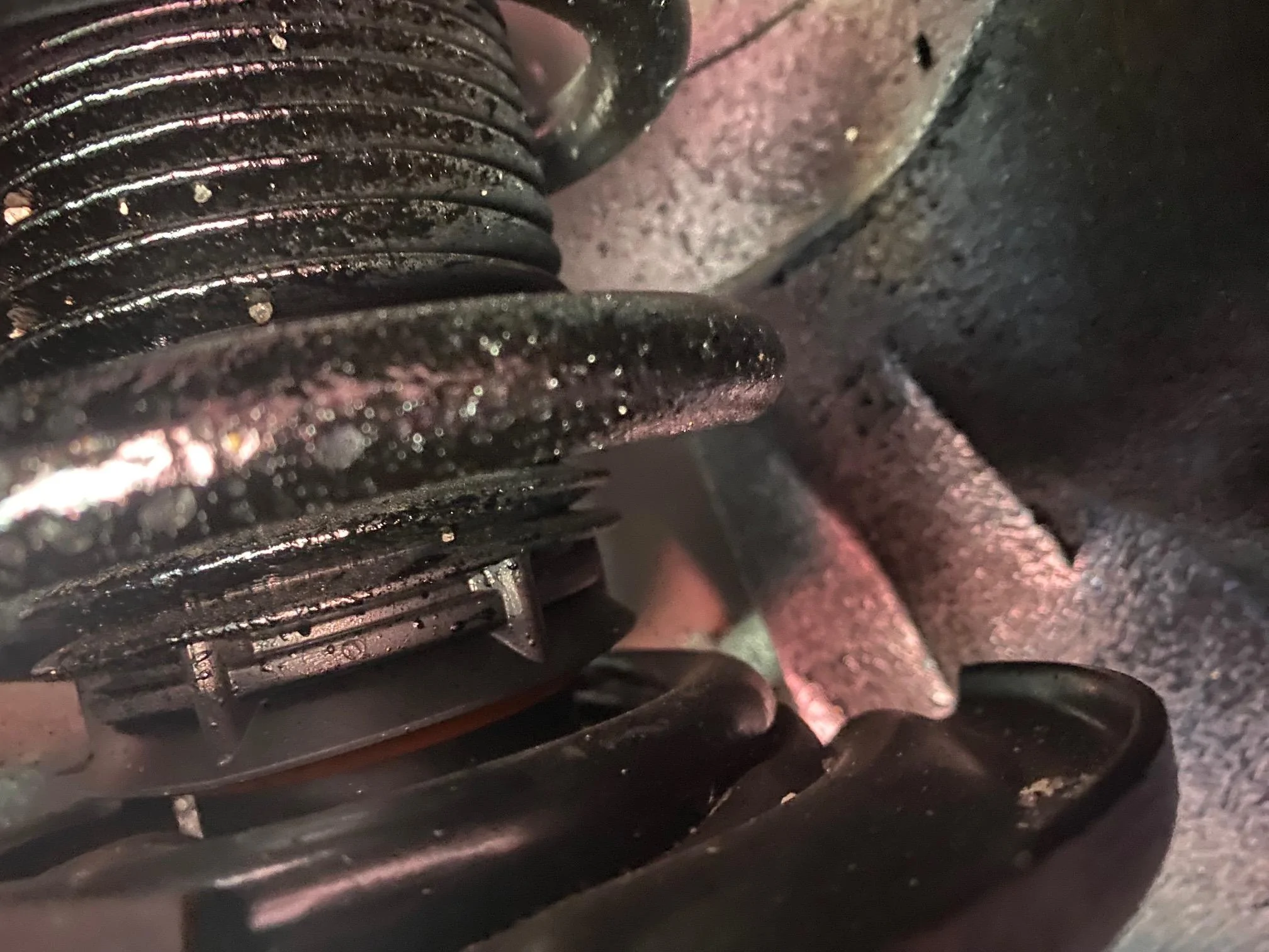

DRKKNITE
DRKKNITE
Mar 11, 2024
Courtice, Ontario
2024 Dark Horse (Handling Package)
So would this be a shipping spacers? This the right and left side of the front end. NOTE: I had a rust proofing done before pickup.
