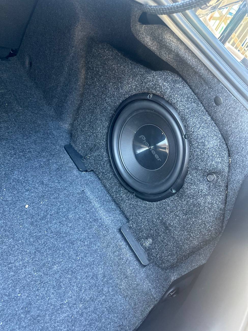

If you want to start with a simple and cheap sound upgrade to make your life easy, I recommend swapping out the subwoofer in the back. You’ll need the Pioneer TS-A250D4, some harness plugs (Red Wolf), Polyfill and sound deadening. There’s a few write ups on this site on how to do it so I’ll link the easiest one to follow. I went the extra mile & wrapped my enclosure in carpet to help reduce rattles.

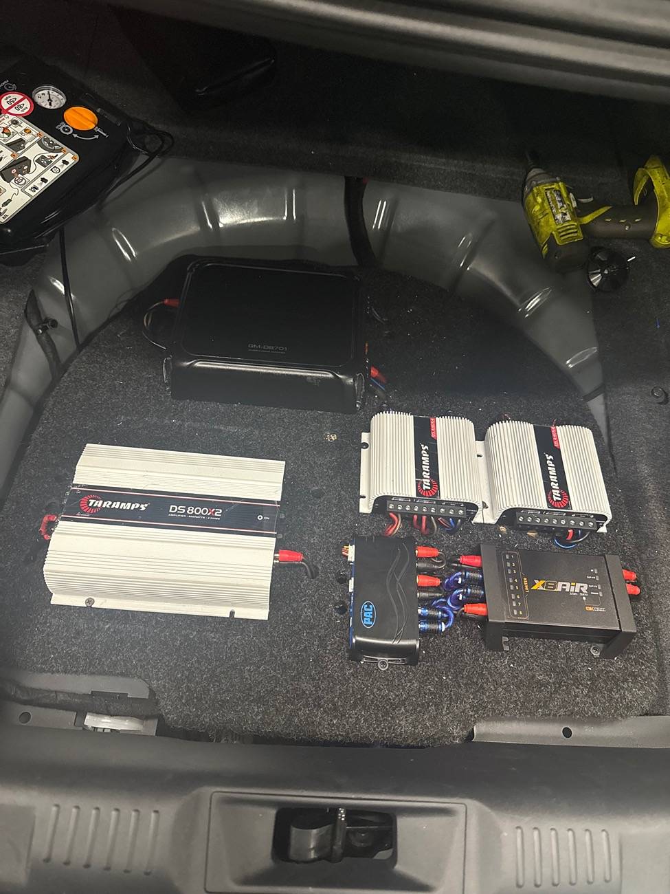

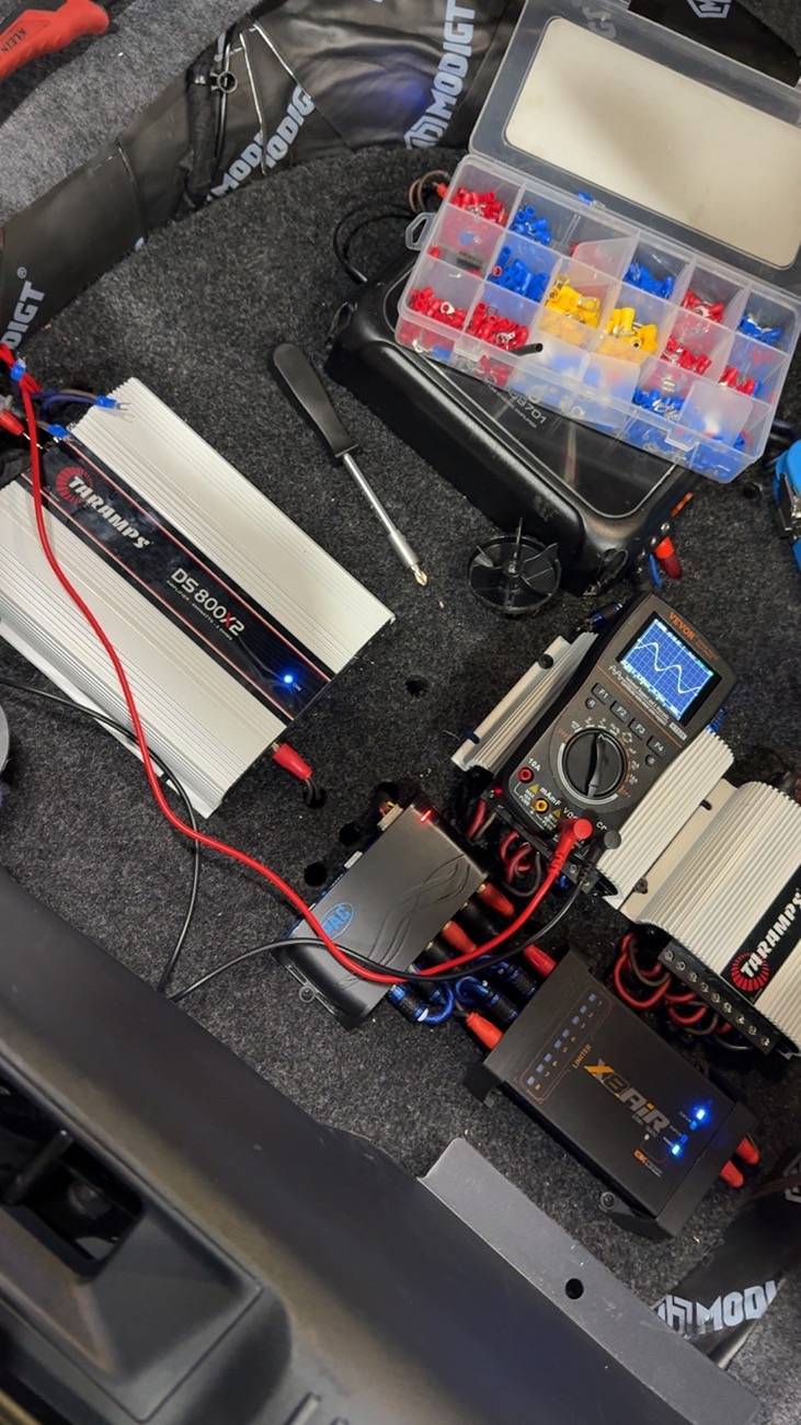

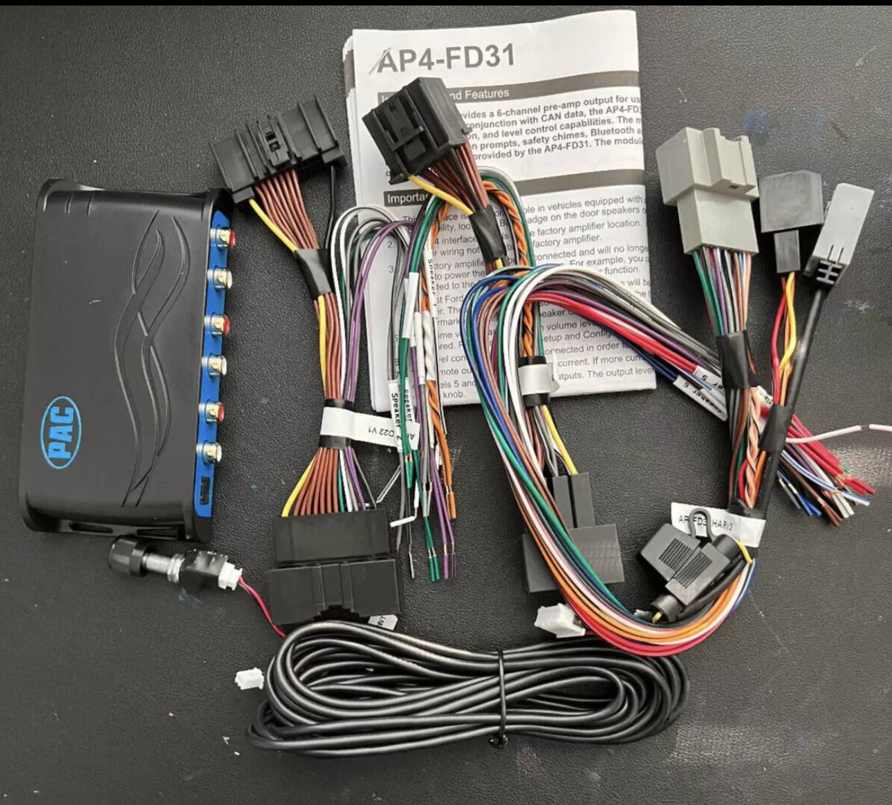

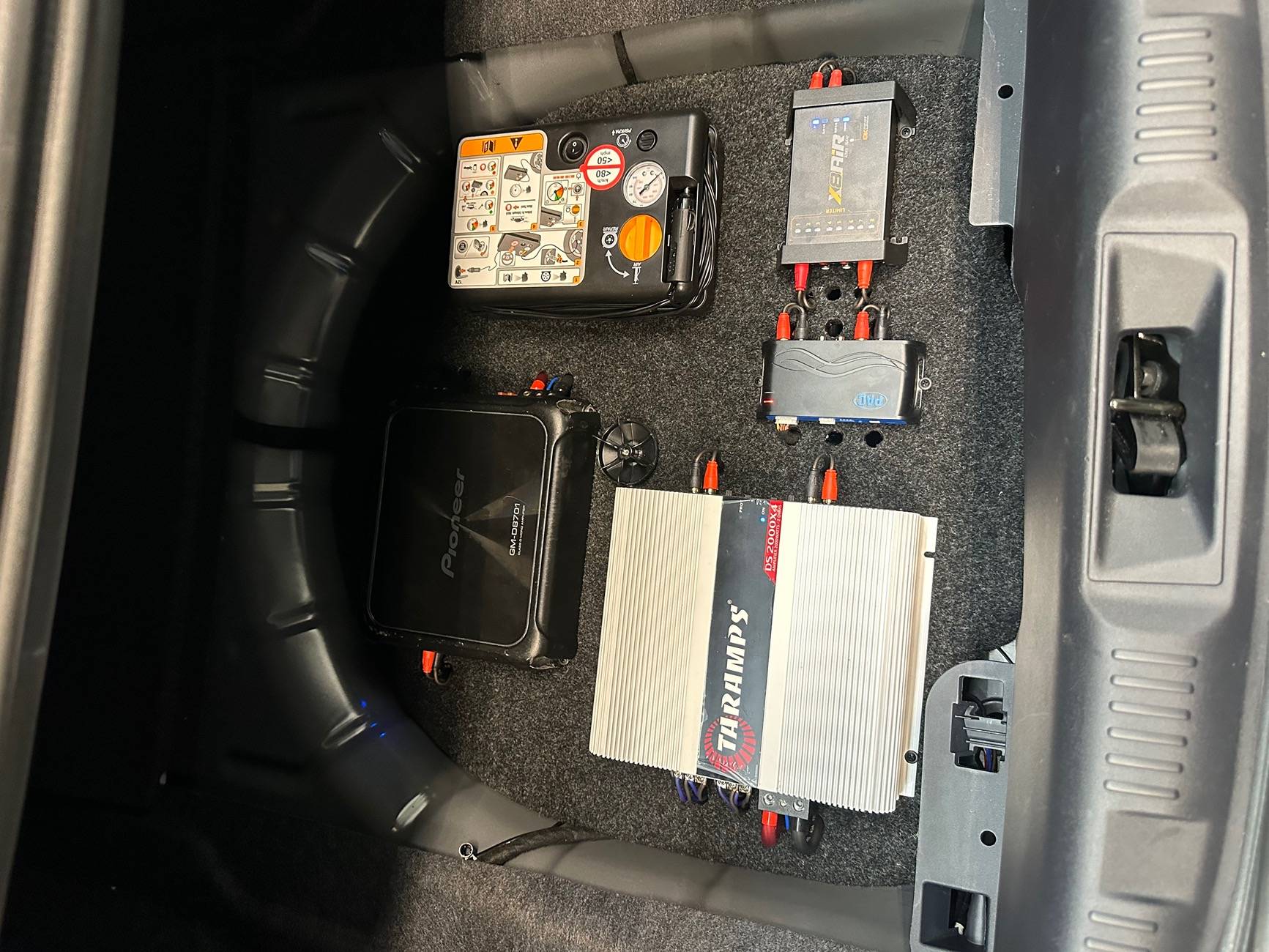

Just like your basic amp install, run power through the right front (make sure you drill the power wire to the positive battery connector, not the BSM sensor) and ground underneath the backseat bracket (sand your grounding surface prior to install) I honestly did not install the PAC unit but I can assume it is very straight forward if you’re experienced in installing 4 channel drivers. It gives you a remote lead and signal for 6 channels. It also plugs in to the wiring of the factory system. The PAC bypass includes three wire harnesses and a knob. I believe one of the harnesses plugs to the amp and the other is for behind the radio (one of the two will fit it). I honestly found it easier to run my own wiring to the back instead of taking apart the radio and running wires through the middle. You’d have to identify which speaker belongs to which pair of wiring as the PAC wires aren't really labeled. This is why it is easier to run speaker wire from the dash & pillar speakers to the trunk as they will need to be amplified. Run these speakers on the left side (away from the power wire). I believe my installer wired the pillars and dash to the rear channel as the front channel required a bit more power. Also, the DSP (OEM Amp) is installed on the left quarter panel, making the wiring insanely easy. Your DSP will be discarded after this install.
The factory subwoofer is installed pretty easily as well. You can snip the plug coming out of the factory pigtail (you’ll have a make and a female plug) and wire it to your amp. You only need two of the four wires coming into the subwoofer. I’ll post a picture of how to wire a dual coil subwoofer with only two leads coming out of the amp

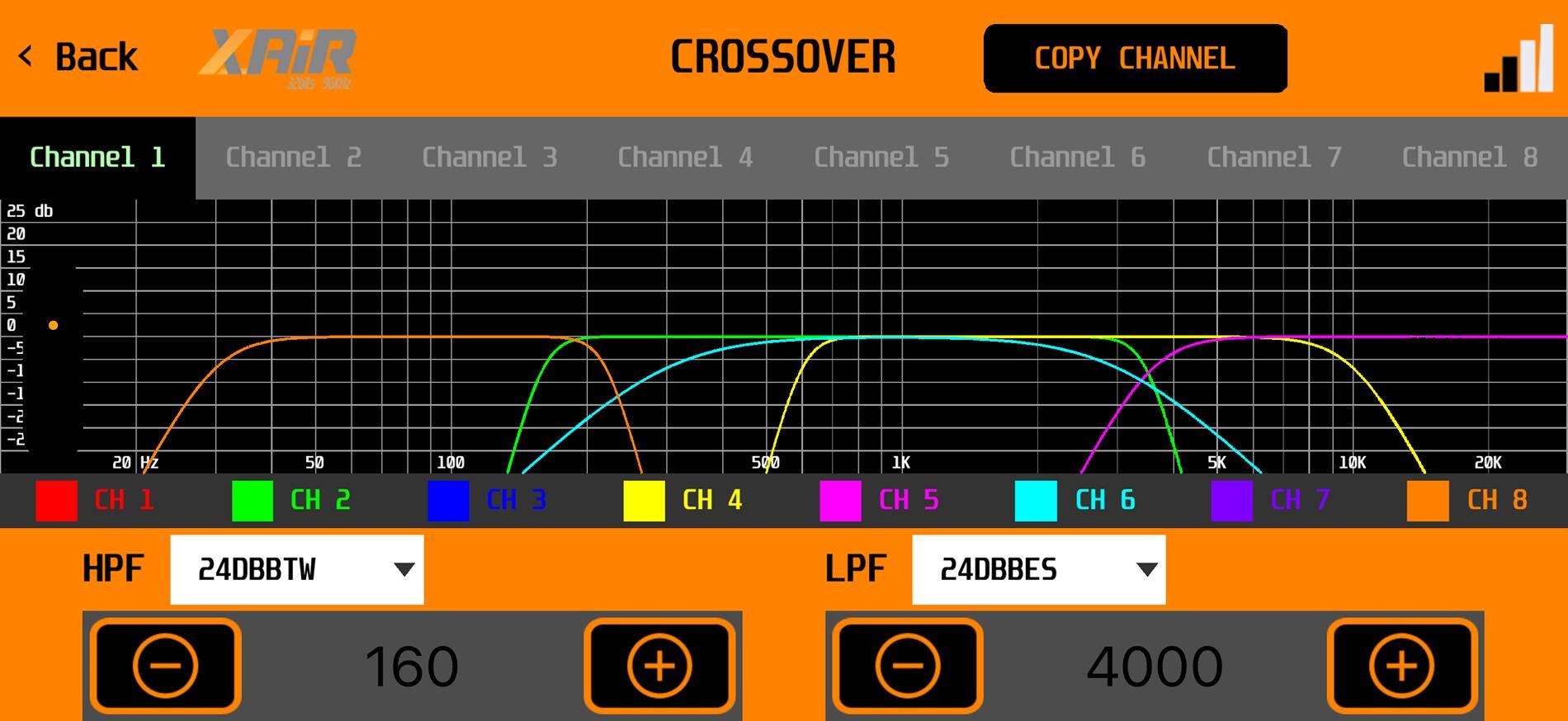

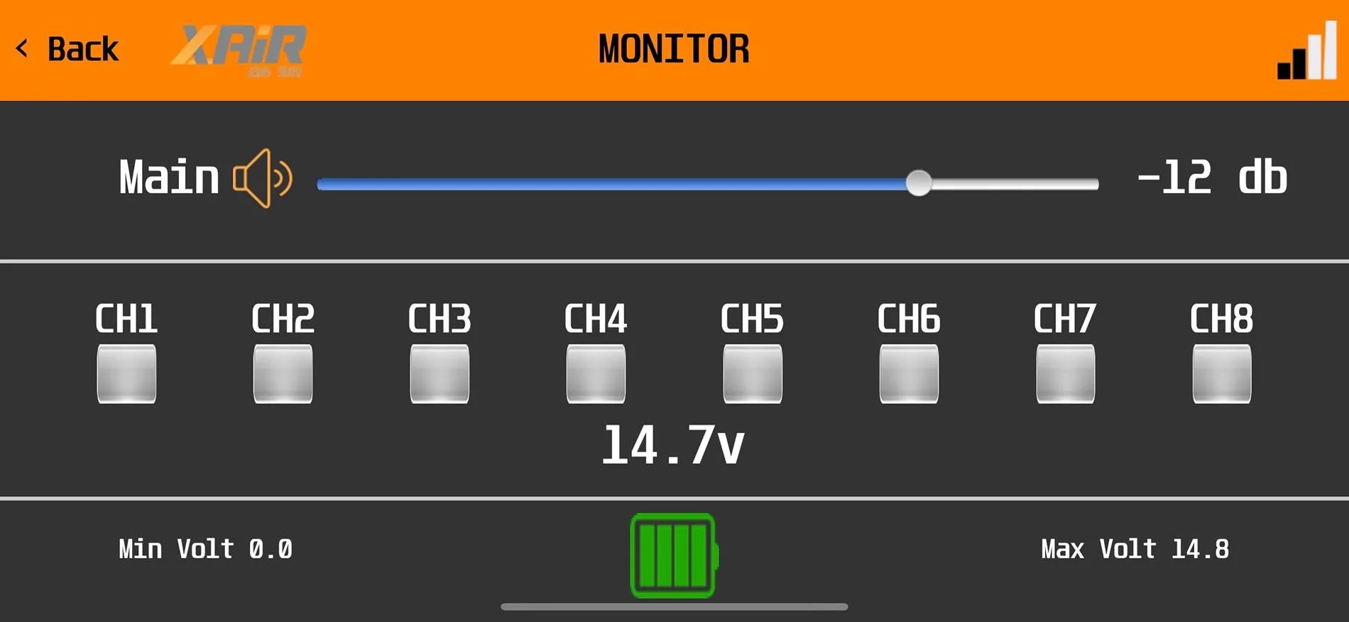

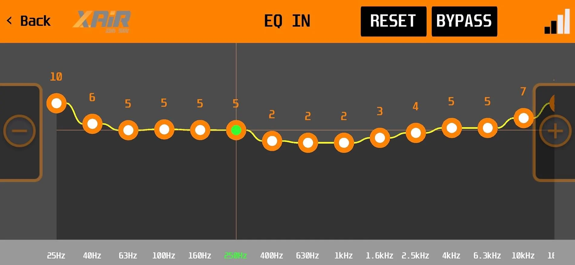

My installer recommended an Expert 8 CH 32Bit device to basically equalize the frequencies from your phone. You have to play with the settings for your own liking but make sure you’re not pushing your speakers past their limit. I’ll post pics of my calibration. It’s best to leave the tuning on the radio as all in the middle (bass, mid & treble) & fine tune through the Xpert all.

Having done Car Audio Professional for over 40 years, I applaud your effort, but this is not the way to go about this. First, you cant just replace speakers in this system and it be ok. You are undoing Millions of dollars worth of tuning. And while you say you're retuning it to your liking, you are not even close. To properly retune this thing, you need a RTA, and a full DSP with Crossover, EQ, Time Alignment, and level settings and you need to know how to use it. The amount of stuff you are screwing up, far out weights anything you thought you were correcting. And for those who dont know, louder is not necessarily better, which is what happens when you replace these speakers without proper retuning. You took something that was mediocre and made it much worse.
I have a DSP you fool lol. I did time alignment, adjusted each speaker to each individual frequency and used an oscilloscope to make sure everything is calibrated. The sound system is designed by B&O not made by them. It’s fords shitty tuning.
