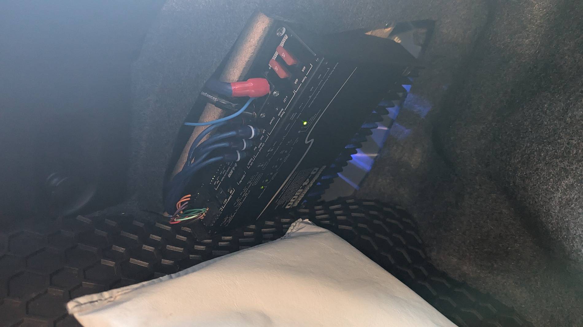

I added some more useful information to the write up! Be sure to relocate your factory DSP to the position depicted below.

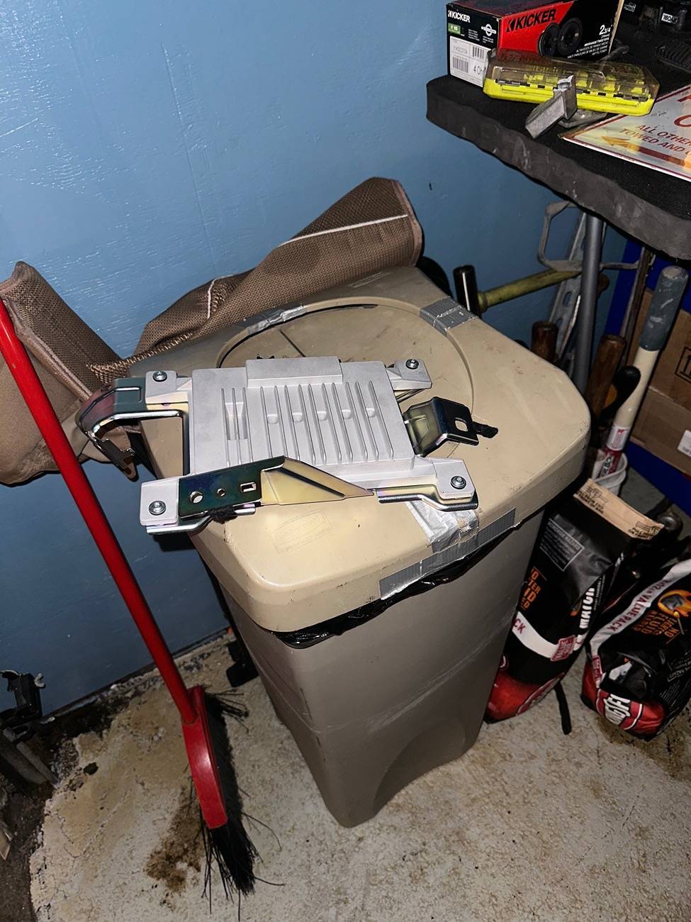

What's the mounting area for that? I wonder if I can make a decent amp fit in the factory location... /hm

Thats hilarious.
It’s about 6x12 inches. Mounts on left inner quarter panel below tail lamp. Word lol fuck that factory dsp

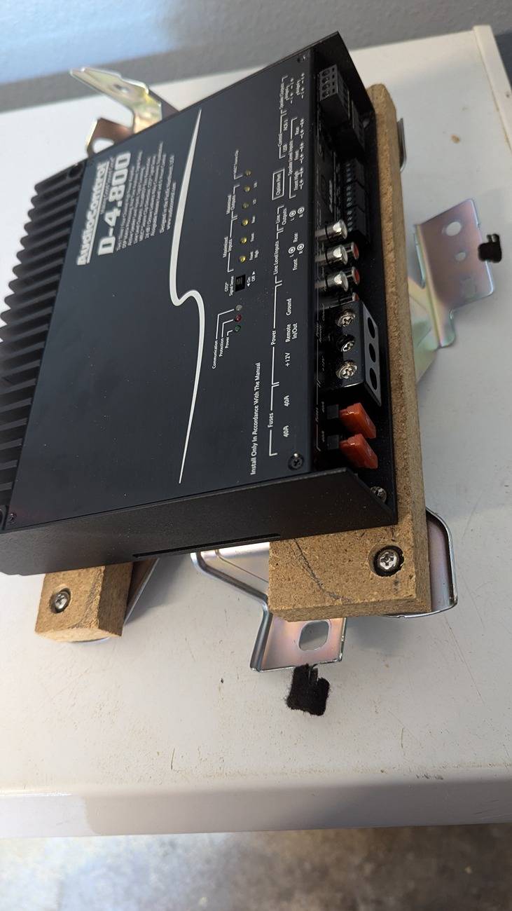

I ended up making a wood mount for my amp and the factory mount :) I cut the carpet in the trunk to give it an access "window"
I have 2 3-channel passive crossovers wired in now and sitting on the carpet next to the amp. thinking i will maybe rewire the things, but I will likely tuck the crossovers in with the Pac interface that i have behind the carpet. Stealth look is what i was going for, as i also use my trunk.
I did NOT upgrade my speakers, but I did run the tweeter cables from the ACM to the crossovers. even with stock speakers, the sound is SO MUCH better. highs are still harsh as hell, but boosting the low and mids actually gets the doors rocking.

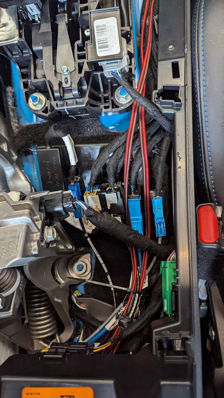

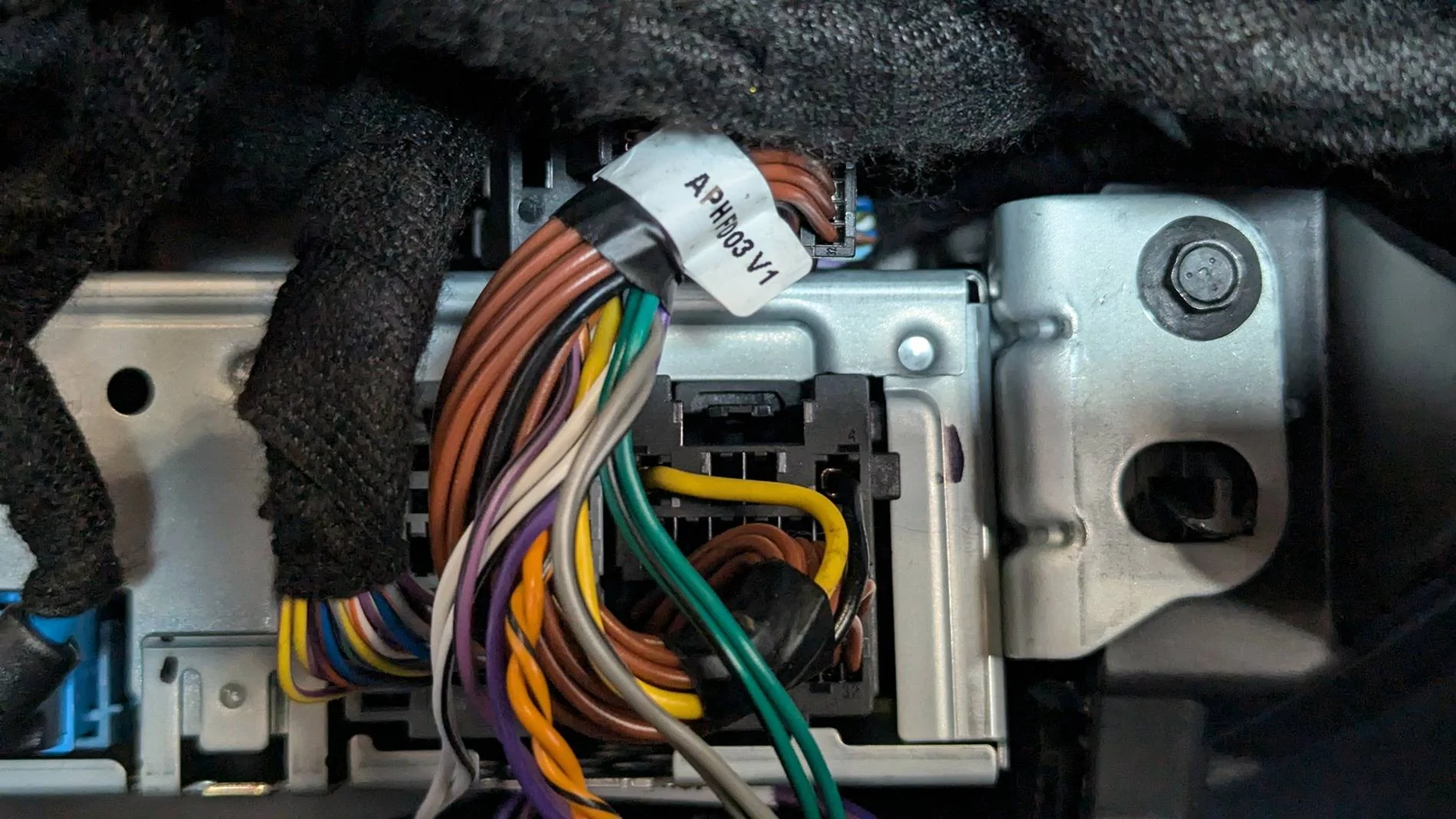

The PAC unit made this a piece of cake really. Aside from pulling the center dash apart to access the tweeter harness and running the wires back, everything is right there is the driver's corner in the trunk.
I updated the other thread in the INfotainment section, but the AC 1200 watt amp is PLENTY for the cabin speakers, and i only have a 500 watt RMS amp pushing a single 12. it sounds VERY good compared to the stock amp/dsp even with stock speakers. On to the task of finding the speakers i want now lol
