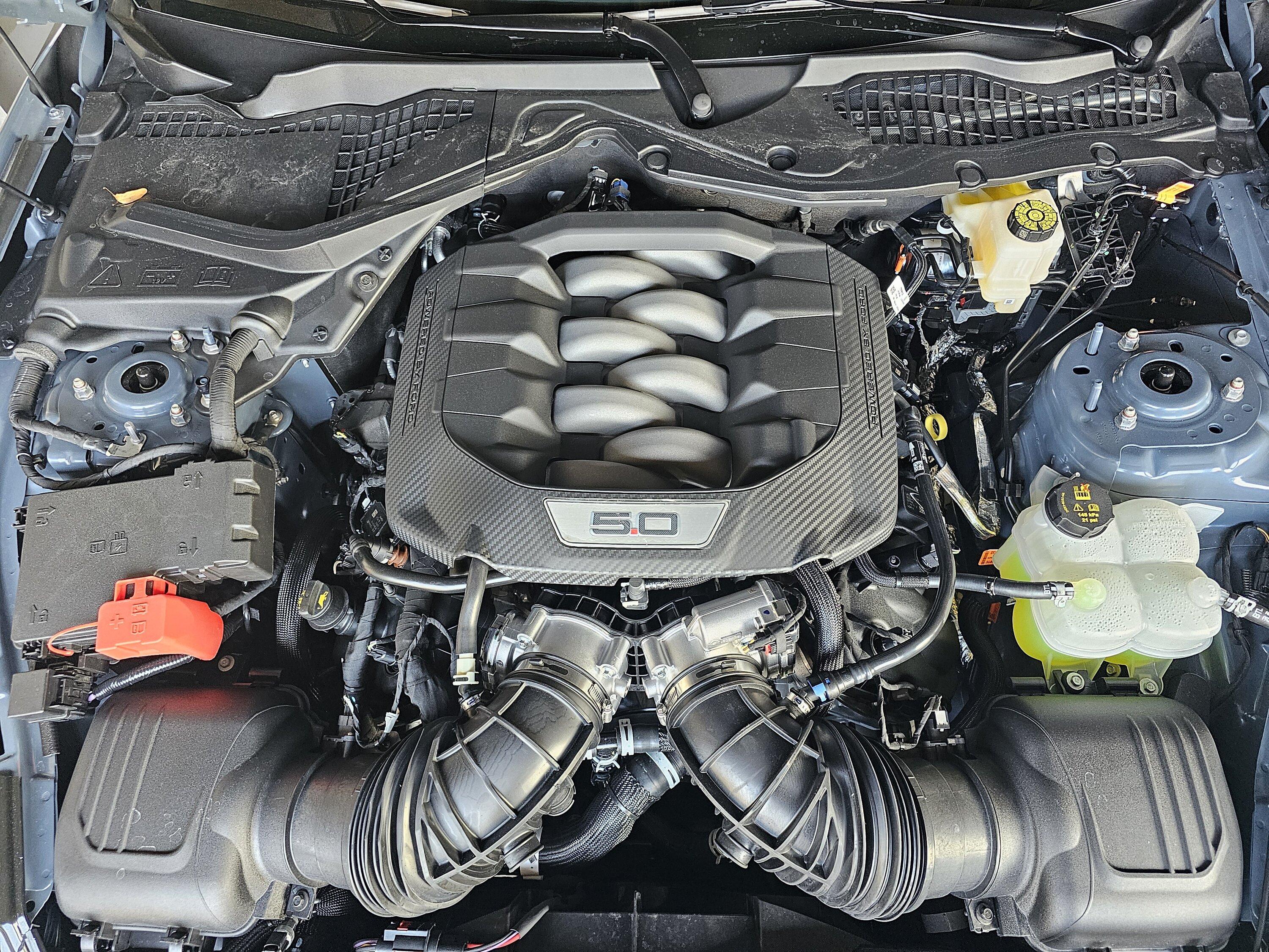

I took a look at the wheel wells and atleast they took the blocks out. Another question if you can answer it.
S650 Mustang Car feels floaty at high speeds? 20230923_175220
On the driver's side, am I supposed to have a k brace there? There's those 2 bolts sticking out and it looks weird for there to be nothing there.
No only if you have the optional performance package.

@dusman59 is correct. From the 2024 Order Guide:
GT Performance Package
• 19" X 9" (F) 19" X 9.5" (R) Carbonized Gray-painted Aluminum Wheels with 255/40 (F) 275/40R19 (R) (Summer Only) Tires2
• 19ā€ Brembo Brake System w/ Performance Linings and Black w/ White Logo Brake Calipers
• Accent Stitched Center Console Lid
• Electric Hand Operated Parking Brake (Drift Brake)
• Front Tow Hooks
• Grille – Painted Ebony Black
• Heavy-duty Front Springs
• K-Brace
• Performance Raised Rear Wing – Painted Body Color
• Black Painted Strut-Tower Brace
• TORSENĀ® Differential with 3.73 Axle Ratio (Manual)
• TORSENĀ® Differential with 3.55 Axle Ratio (Automatic)
• Unique Chassis Tuning
• Unique Stability Control, EPAS and ABS Tuning
• Upsized Rear Sway Bar
Given a bit, I'm sure the aftermarket will make one available.

Awesome! Thank you guys for the help!
