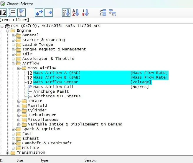

Quick update: I've been going MAD trying to get to the bottom of the AD Counts issue. There's a sensor parameter I can add to graphs and histograms, but it won't populate:
S650 Mustang Calling all S650 Roll-Your-Own Tuners using MPVI/VCM Editor... 16408_Won't_Load
When I look for a channel to add tho:
S650 Mustang Calling all S650 Roll-Your-Own Tuners using MPVI/VCM Editor... Where_Are_Other_MAF_Channels
Womp womp... Asking HPTuners folks for some help. Part of me wonders if there's a channel missing that I need... Updates when I've cracked the nut, but by all means, let know if I'm missing anything.
