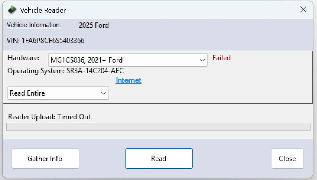

I'm getting stuck here:
S650 Mustang Calling all S650 Roll-Your-Own Tuners using MPVI/VCM Editor... 1752256038147-am
S650 Mustang Calling all S650 Roll-Your-Own Tuners using MPVI/VCM Editor... 1752256073578-w8
Just hangs...

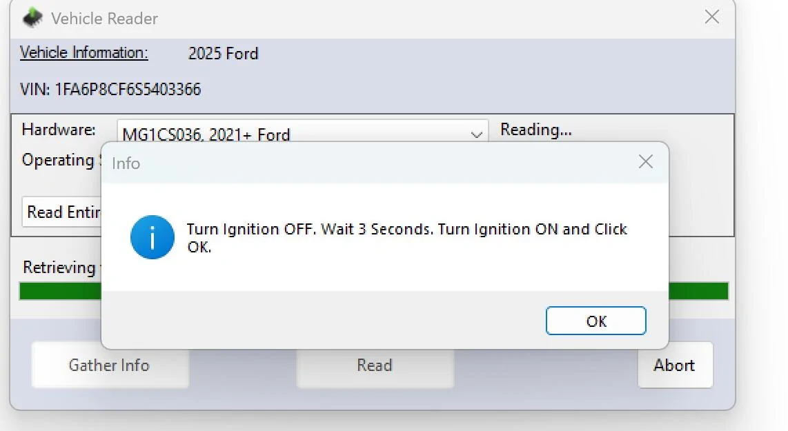

5.1.4620 made a little more progress reading the stock tune, but still times out after asking you to turn off, turn on car...
S650 Mustang Calling all S650 Roll-Your-Own Tuners using MPVI/VCM Editor... 1752280309775-99
Talking to HPTuners tech staff about it again...
dealing with the same exact issue when trying to read the car using the MPVI3. Wish HPtuners would have fixed this issue before even releasing it. Kinda upsetting.
