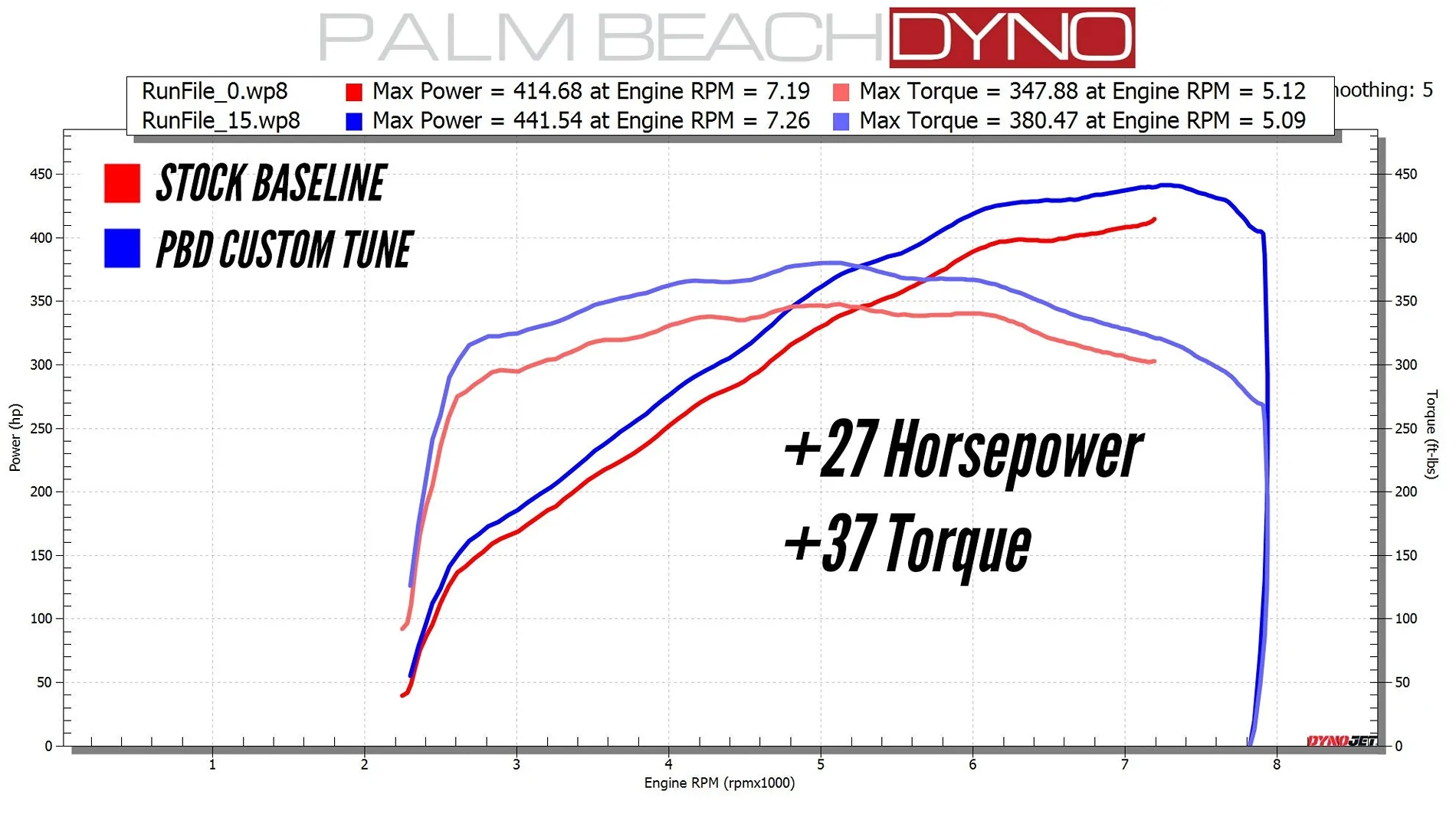

As far as tuning, as long as you have all the OEM ECU components, they should be able to dial you in. We work with tuners like Palm Beach Dyno, Shoemaker Performance, and Lund Racing so if we can help with anything, let us know! They will want the HP Tuners RTD4 device used too.
https://www.lethalperformance.com/s...024-2026-mustang-gt-dark-horse/custom-tunes-2
