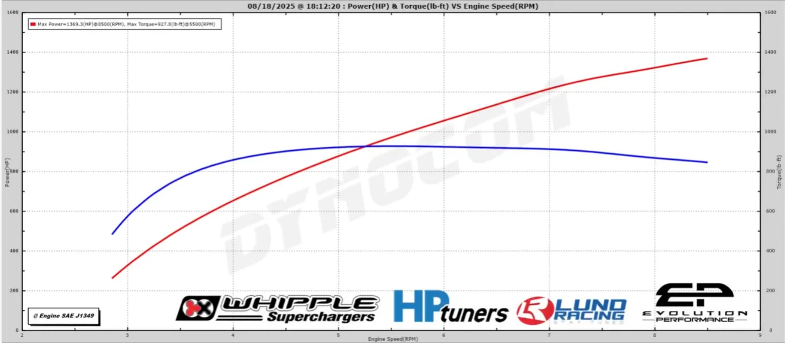

S650 Mustang 1,369 WHP 2024 Mustang Dark Horse by Evolution Performance / Whipple / HP Tuners / Lund Racing 1755697139833-dk
What are you guys thinking about this?
Evolution Performance, Inc.
Dx1400S Serial # 001
• Built 5.0L GEN 4 Engine
• Whipple 3.0L GEN 6x Supercharger
• Whipple 10-Rib Pulley System
• Whipple 120mm Throttle Body
• Whipple Competition Air Boxes
• Whipple Dual Intercooler Pump
• ICChiller Interchiller
• 170 Degree Thermostat
• GripTec 10-Rib Pulley
• ID1750 Fuel Injectors
• -10 Fuel System
• Brisk Racing Spark Plugs
• Kook's 2" Longtube Headers
• 3" Titanium Exhaust System
• Billy Built 10R80 Transmission
• Circle D Torque Converter
• Carbon Fiber Driveshaft
• Amsoil 5W50 Oil
• Sunoco Race Fuels E85-R
Evolution Performance, Inc. 2024+ S650 Mustang Turn-Key Serialized Builds.

They do have an interchiller on this build.
I'd love to see the pre/post IAT's on this.
I think it might do 850 wheel on 93, not sure I'd want to risk it, however DI is kinda magic.
Also please note these numbers are from a hub dyno, and is attempting to calculate drivetrain loss, so the numbers are likely inflated to a degree.
Dynojet whp numbers which seems to be a popular dyno for mustangs would read lower.

I'm curious what is meant by built gen 4 engine. What was done to it? Rods and pisstons?

I know a few people who run 1400 WHP TT stock block forged rods and pistons setup - F-150 and Mustang coyote blocks, not sleeved. I've seen centri units at 1400 but never actually seen a positive displacement blower run this high. I'd be worried about the crank and have support. I don't see crank support here.

Where are the three electric motors? That's what the corvette needed to make that type of power.
