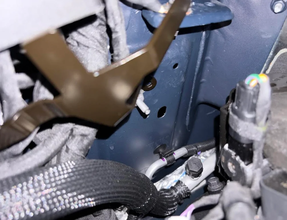

I bought an M-6766-A50D (https://www.ebay.pl/itm/196362561935) and I cannot install the passenger bracket because of an not aligned stud bolt. Comparing mine passenger side studbolt location with installation photo from the PDF I can see huge difference with it:
PDF:

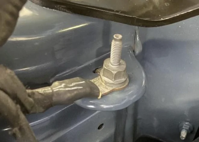

My Mustang:
S650 Mustang OEM Ford Performance Oil separator kit on new Dark Horse 2026 issues 1781034128350-8v
So the bracket is misaligned

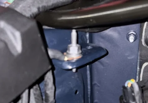

S650 Mustang OEM Ford Performance Oil separator kit on new Dark Horse 2026 issues 1781034163512-rt
The only way to to properly install all the PVC and can, I had to install the bracket without an upper screw:

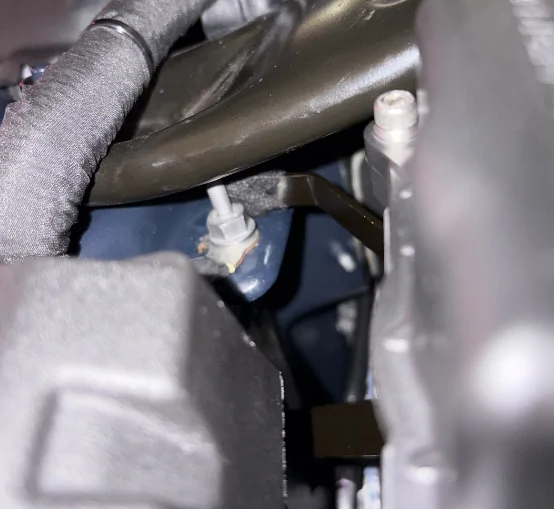

S650 Mustang OEM Ford Performance Oil separator kit on new Dark Horse 2026 issues 1781034191678-7i
So for sure this bracket needs an update because of the screw placement change (which are not centered like in 2024/2025):

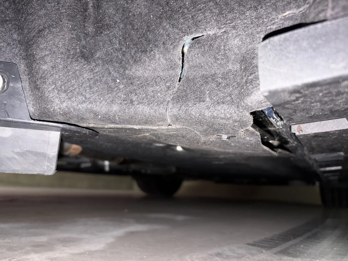

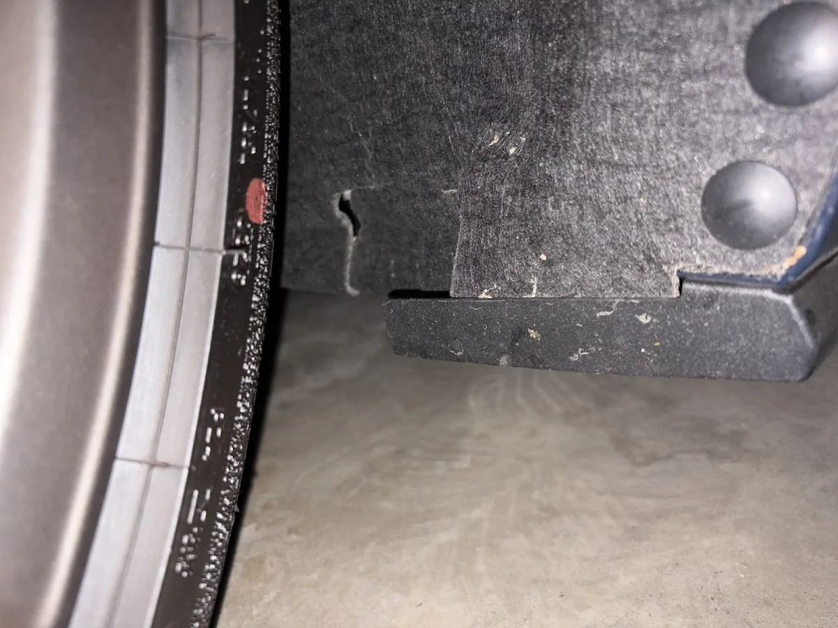

From my perspective passenger bracket is for 2024/2025 models (driver side is ok). In 2026 there is a change with the studbolt location holder which moved ground cable slighty to the left. I sent an email to Ford Performance guys about it - will let you know what they answer is. Ford made some changes in 2026 (for example in my 2026 model they covered this holes in chassis - I will send the picture later) ->
