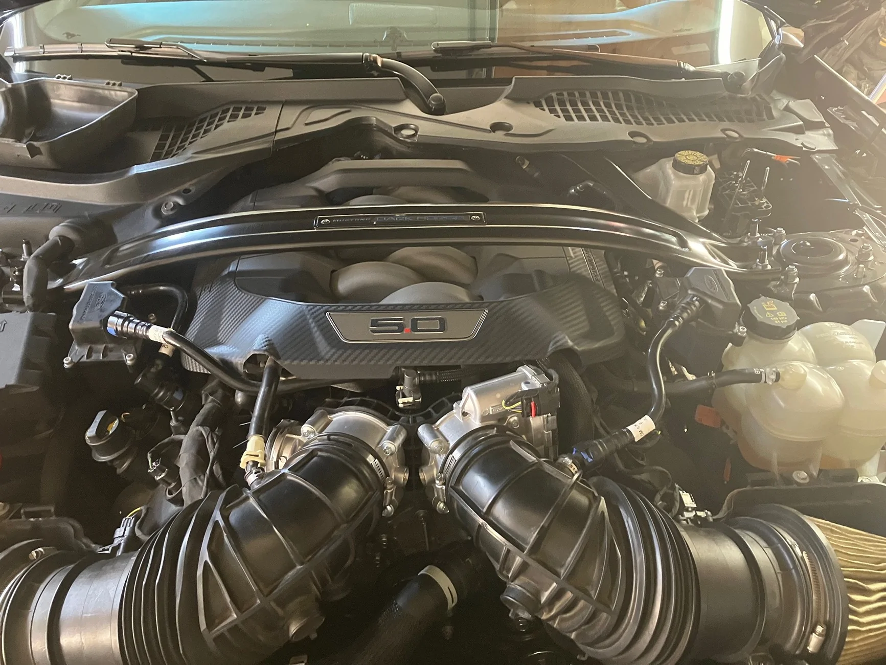

I have them installed, drivers' side almost nothing of oil residue, passenger side there is a lot of oil between oil changes. The Ford Performance cost more but I like the look better than other aftermarket options. That being said they all work the same.
Why is there such a difference in trapped oil between passenger & driver sides?

I've tried to find the answer to that question before I bought mine but could not find the science behind it. I bought the set because at that time Ford only sold them that way. You may be able to find the Passenger Side only now if you don't want both.
