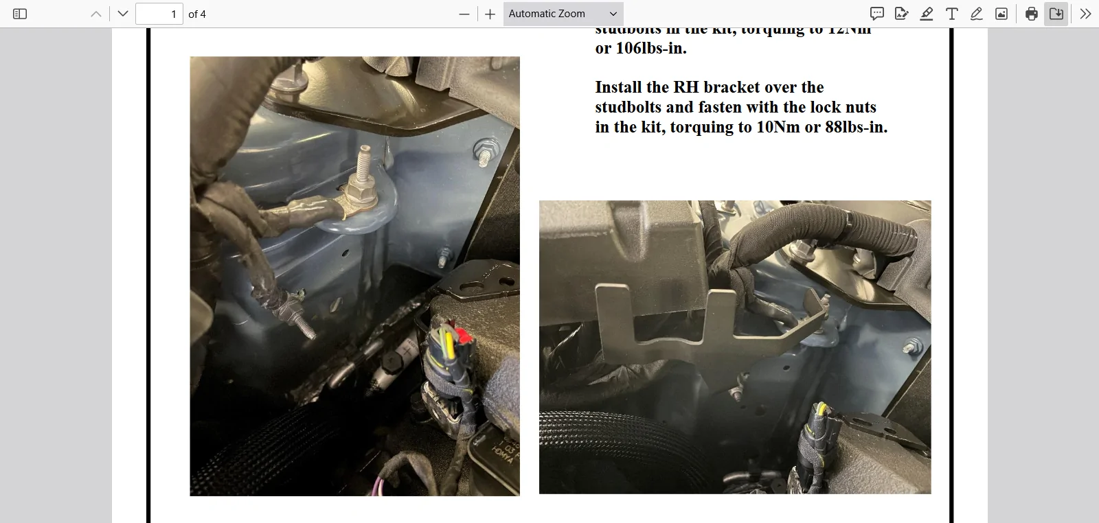

The passenger side seperator mounts to the shock tower area. The instructions say to replace the two ground wire bolts, mount the bracket and reconnect. But it doesn't say if you need to disconnect the battery, and it doesn't say if the bracket goes under the new bolt, or over the nut on the new bolt.
Im probably overthinking this, but before I start disconnecting things id like to know the proper way to mount the bracket. The instructions are not good at all. Can anyone who has this post a picture or two of how you mounted it? And did you disconnect the battery before changing the ground wire bolts? Thanks!

Thanks. I got the passenger side on. The ground cables have tabs that keep them secured to the frame. So I just carefully swapped the bolts one at a time with no issue.

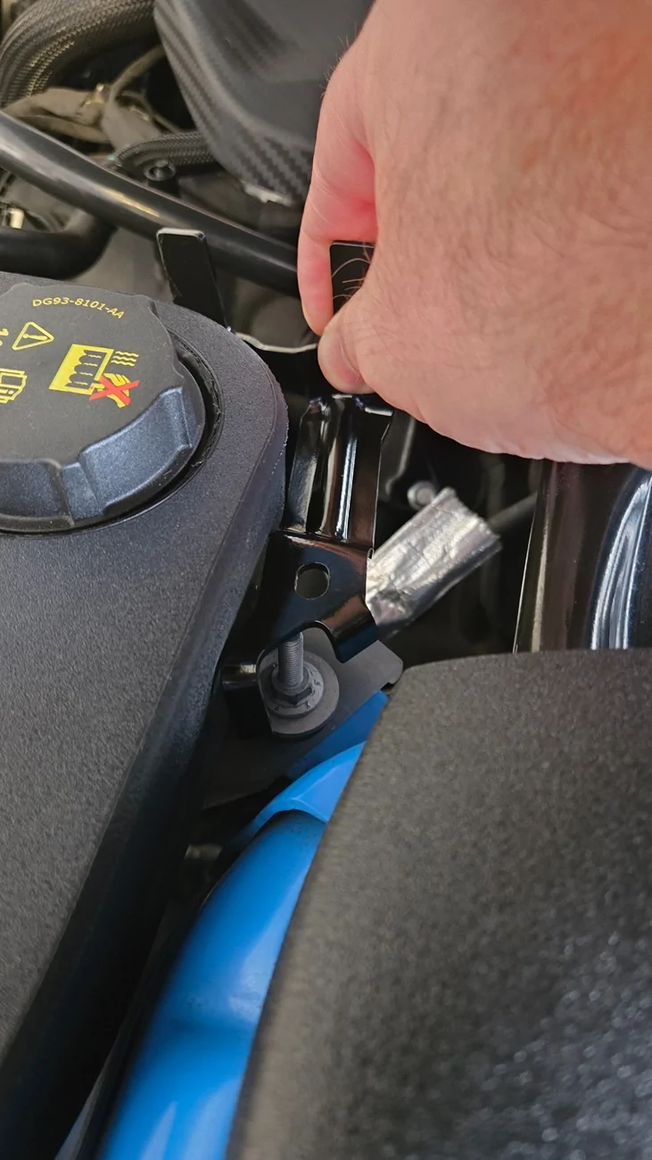

I cant get the driver side bracket on because I have the anchor room coolant tank cover, and it shares a bolt that you need to attach the bracket and doesnt leave enough room. So im just leaving it off now as im pretty sure the passenger side is the important one anyway. Oh and I dropped the bracket down onto the belly pan trying to get it to fit. So my 10 min job turned into 45 mins and lots of cus words for only one side to be finished. At least I was able to use a magnet to fish the bracket out. 😔🤦

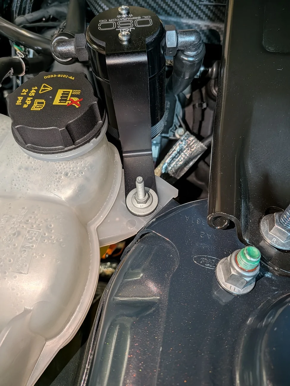

@AZ_Ryan ,
I was thinking about getting a coolant tank cover as well. I have a J&L catch can for the passenger side. It's bracket mounts to the rear post on the reservoir. Do you know if I will have a problem with the cover? Thank you kind sir.

@AZ_Ryan ,
No idea as I cant see the bracket in the picture. My guess is you will have an issue.

Good morning I'll get you a better picture today. :sunglasses:
The back of the Ancor Room coolant tank only leaves about a 1/4" between the cover and the bolt. Some modification to the bracket or cover will most likely be needed.

You good with your installation?
I can take pics if needed as I have PORT & STBD installed

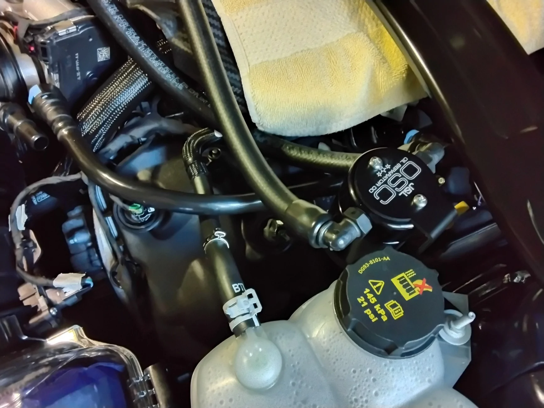

Sorry for the delay, here's the pic.
Not sure if that will work or not. The good news is the bracket secures under the nut (the Ford Performanceversion fits over that nut). But the ancor room coolant tank cover tab also secures in the same location, and I suspect the corner of the tank cover will hot that bracket. Can you rotate the bracket clockwise toward the shock tower?

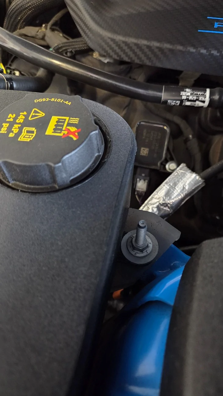

Ill post a picture of the tank so you can see what I mean.

Here are the pictures of the Anchor room coolant tank. As you can see my bracket is too wide to fit over the nut.
The J&L one might work better since it mounts under the tab. But I still suspect the corner of the bracket may not clear the corner of the cover.
