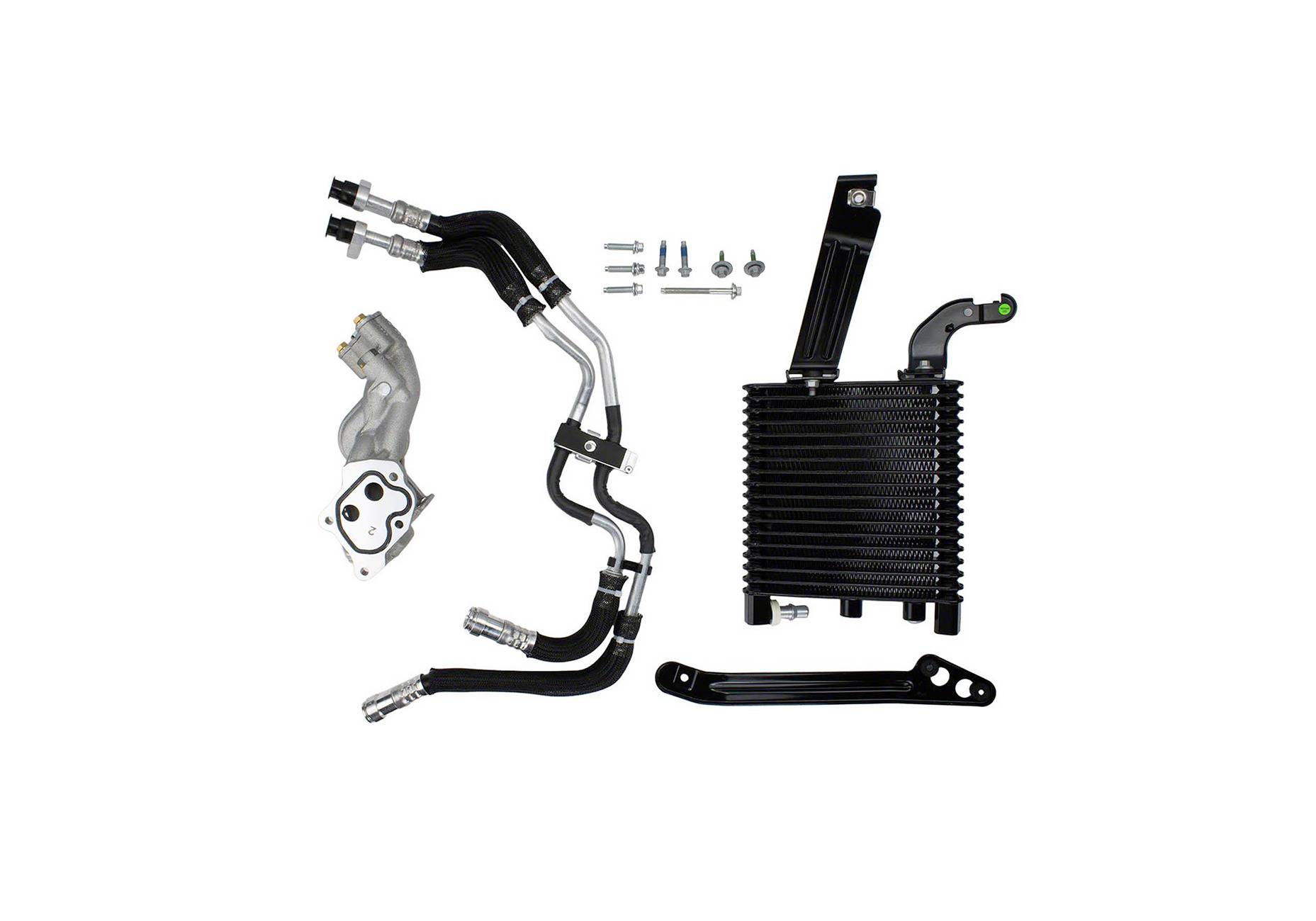

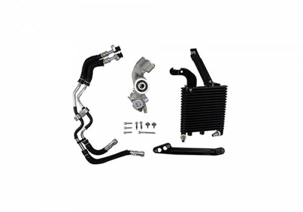

Ford Performance has released their own oil cooler add-on kit for the 2024+ Mustang, using the same factory parts as any Mustang GT Performance Pack or Dark Horse.
https://performanceparts.ford.com/part/M-6642-M50D
The kit uses the same type of oil filter as usual in contrast to how MMR's kit uses the more expensive cartridge filter from the GT500. the fact that this is made with OEM parts means that you will likely even be able to install the air guide from the Performance Pack models too, which appears to be part number PR3Z-8311-A, though i do not make any promise that it will work; this is an assumption based on the information i have
S650 Mustang Ford Performance Oil Cooler Kit 1745345578839-v8
S650 Mustang Ford Performance Oil Cooler Kit 1745345609811-qr

I think there would be one more part or modification required to pull this off.
Left Front Inner Fender Liner (Slotted) or cutting some slots in the non-PP fender liner. Not sure how the latter will hold it's shape over time (Rigidity speaking).
CAYOTE
May 18, 2024
Alabama
i pieced this kit together last year on my car. I just cut some slots in the fender line and I haven’t had any issues with it so far.

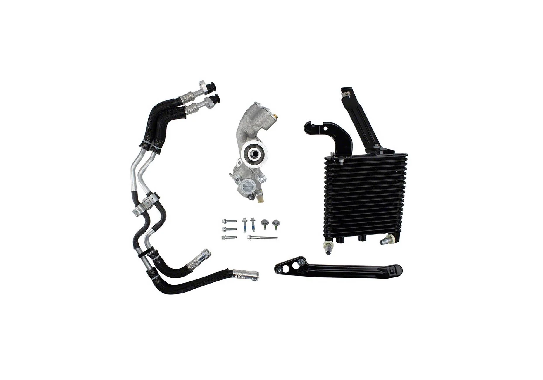

Ford Performance just had a price increase on most of their products. The oil cooler now retails at $770 on their site. We just loaded it onto ours and our retail price on it is $693.00.
Let is know if there's anything we can help you guys with.
https://www.lethalperformance.com/f...ler-kit-2024-2025-mustang-gt-m-6642-m50d.html
You have 2 more options they don’t
Street kit
Or motor sports kit
and the filter socket
what’s the difference?
