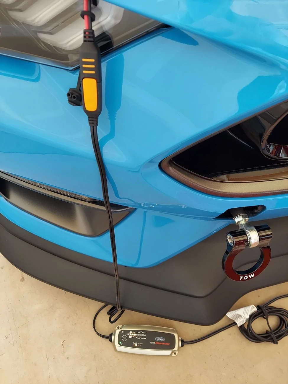

Dear all, any ideas on how to install a SAE cable for a battery tender as a no lift bonnet solution?
Thanks!

let it hang down and secure the pig tail with zip ties.
You'll have to reach/crawl under the car to access it.
Just make sure it is fused as close the the battery as is possible, Battery Tender brand chargers have a fuse holder and 7.5 amp fuse near the ring terminal

Thanks! I do have a fuse, but want a more comfortable location for it. Ideally in the grill or on the edge of the windshield close to the battery. A intermediate comfort location would be on the wheel well, easy to install a “socket”, but dirty and cumbersome to plug and unplug…
