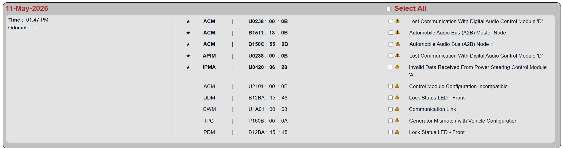

Got your message, but responding here for the sake of the info being out there. As of today, your car started reporting some ACM codes that are 100% related to your issue. It looks like the ACM took a sh*t.

I am also seeing a config related code in the ACM and IPC. I assume you made some FORScan changes at some point that are causing those codes? I don't think that's the reason the ACM crapped out on you.....just an observation.
