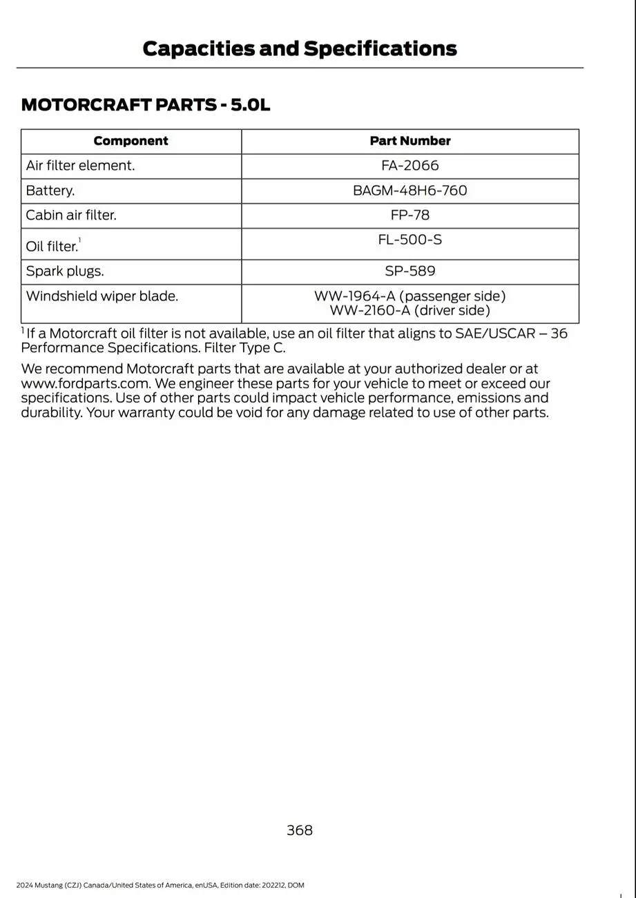

Does anyone know if the standard battery in a 2025 Mustang GT is AGM or lead acid? My battery charger has different settings and I’d like to use the proper one when charging/ trickle charging the car.

FYI, AGM is a form of lead acid. It's design uses a glass matt to hold electrolyte instead of liquid in the case. It does have different charging current patterns based on the difference in electrode design.
