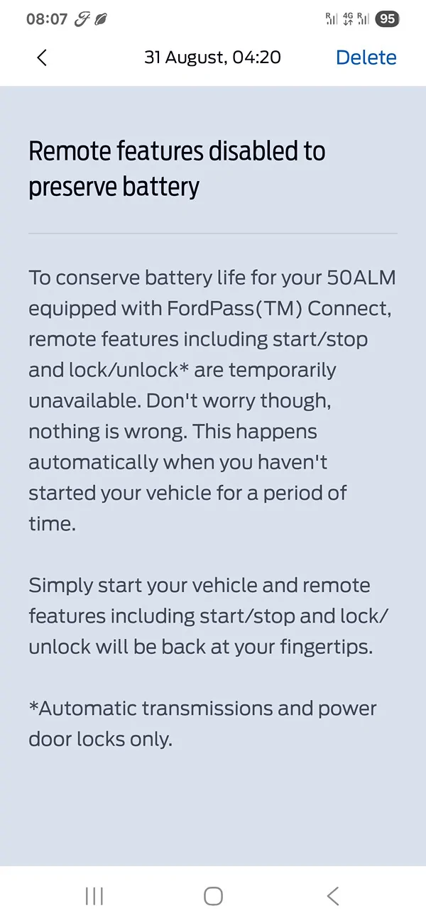

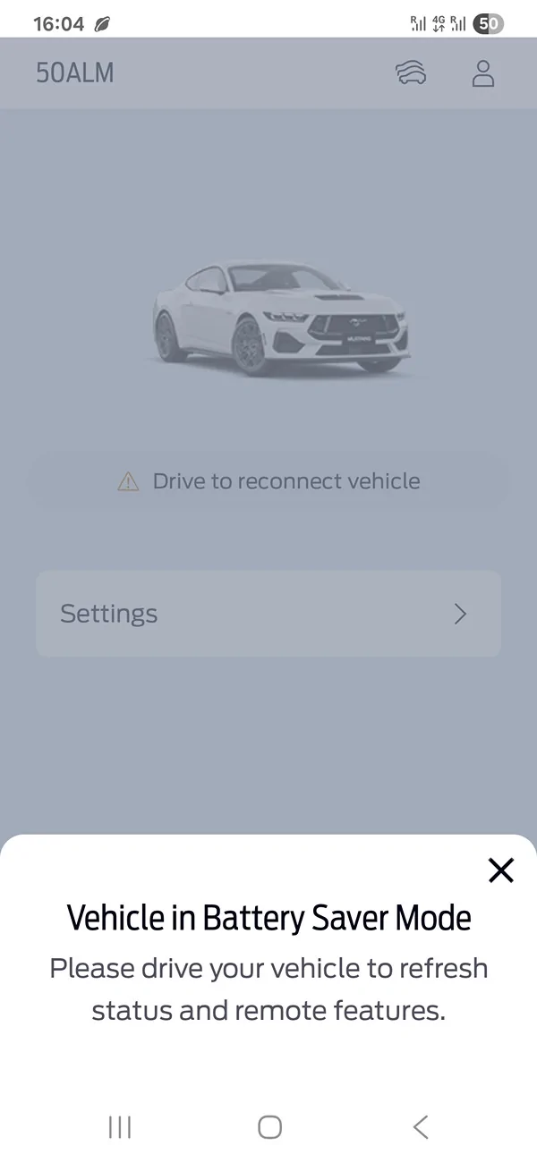

Hi all
As per signature, I have a MY24.5 S650 GT with 6-speed manual gearbox.
I know when the vehicle has not been driven for 15+ days, you get the Ford Pass app "Remote features disabled to preserve battery" notification.
S650 Mustang Battery disconnect - What needs relearning? Screenshot_20250831_080742_FordPass
And this notification:
S650 Mustang Battery disconnect - What needs relearning? Screenshot_20250831_160447_FordPass
These notifications are time-based and are sent irrespective of whether your battery is being maintained with a trickle charger or not.
Not being a daily driver, I leave the CTEK MXS 5.0 connected when parked in the garage.
With the vehicle In "battery saver mode", I know that the tyre pressure units will always revert back to Bar (from my chosen PSI setting).
Sometimes the My Color colors will revert back to factory defaults, but not always.
