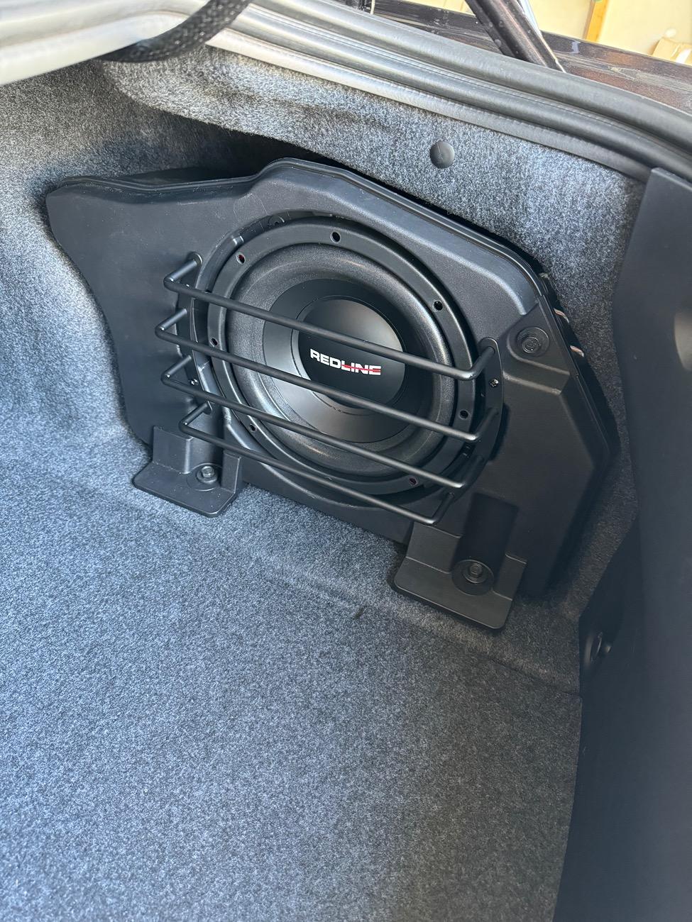

I just installed the DD Redline 10” sub and it sounds incredible versus the stock sub. Took about 45 minutes, added a bag of Acousta-Stuf polyfill and the 4 bar grate. Fits right in the enclosure with no trimming needed but I did grind down the 12 o’clock centering tab for an easier fit.
I stripped the stock connectors(you can get adapters), the black & purple are negative and yellow & green are positive. The DD has push connectors. Piece of cake. The stock amp drives the sub just fine.

Where do you put the polyfill? Along the inside of the enclosure? I’m going to try the subw replacement soon.
cosmo73
Mar 6, 2020
287
282
Berks County, PA
24 GT, 20 A5
Once you remove the stock speaker, pack the entire enclosure loosely with the polyfill.
