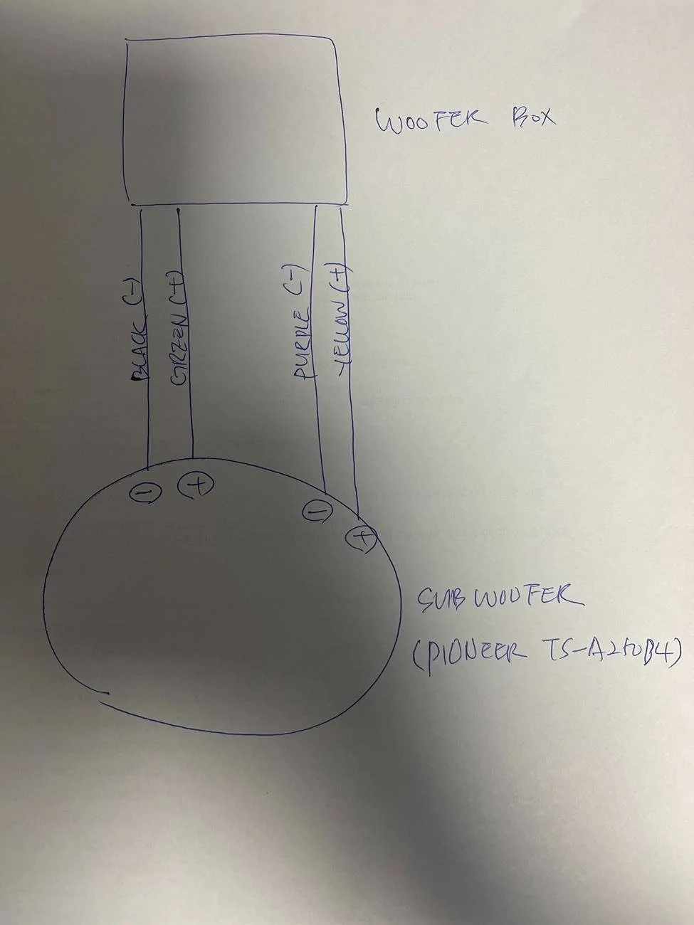

Can you confirm that my wiring is correct?
S650 Mustang B&O 10" sub replacement? KakaoTalk_20250302_094519669
Yesterday, I've replaced subwoofer with TS-A250D4 with above wiring, but it is not worked.
(No sound, no vibration)
If above wiring is not correct, please let me know correct one, if you don't mind.
It is serious for me.

The black and purple wires are negative, the green and yellow wires are positive

Looks correct - you did reconnect the plug at the back of the sub when you put it back in?

Just before, it was solved.
The problem was the volume.
When I volumed up to mid. Sub woofoer started to vibrate.
Thank you for your kind reply. Thank you so much.
