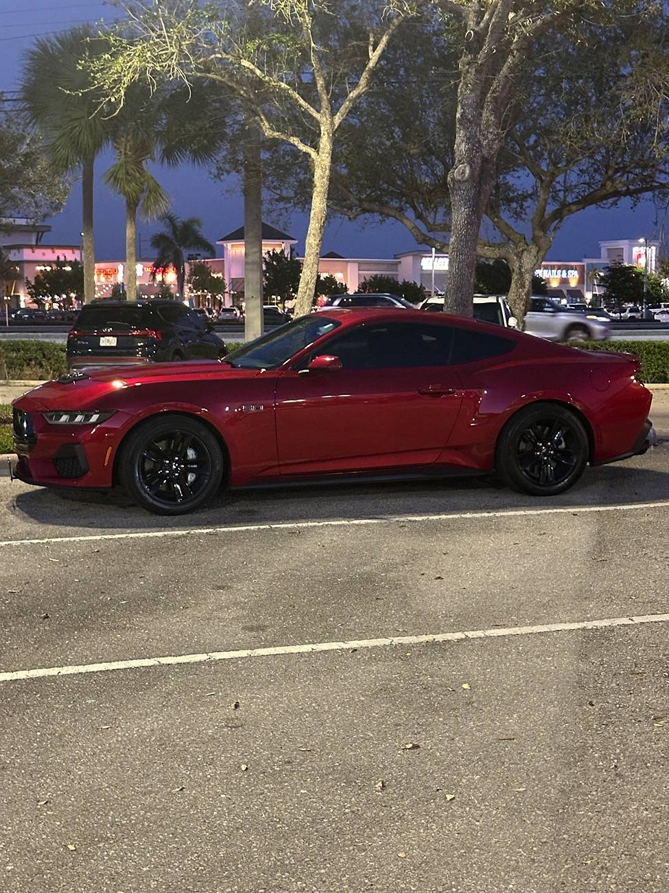

Thank you for updating us. Looks beautiful. Did Ford provide a rental for some of the 73 days?

So...did you ever hear back from Ford on a Buy Back?
We settled with a cash for keep, I can’t disclose the amount as part of the terms of the settlement👍🏻 I can say this , it was brutal going through it, but Ford stuck by me and did right by me. I’m happy now that it’s over got my Horse back , happy af!
