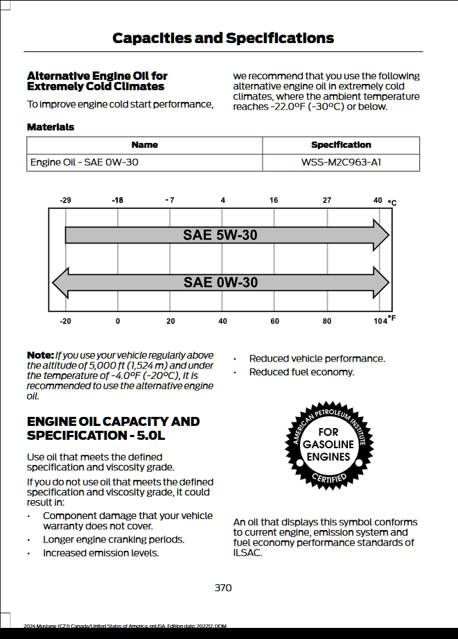

Ford only really recommends the 0W30 when its cold and/or high altitude

I worked for an oil company (Fords oil supplier) after I retired the first time, and when I saw all the testing that goes into what the OEMs say to use, I no longer challenge it. Trust me, they don't use a dart board.

I checked the viscosity scale, how engine oil is measured in the lab. The difference between 0 and 5 is not like between 50 and 55, but between 50 and 250.
Viscosity is a measurement of 1) resistance to flow and 2) shear strength.
I believe it is a given that engines encounter the greatest amount of wear when cold and warming up. Once things are properly up to temperature, conditions within are more stable and better suited for the components.
If operating in a cold climate, let's say Winter, 0 F / -17 C, 🥶I'm not to concerned about shear, the ability of the oil to cling or hold onto engine parts. The engine is naturally looser due to cold temperatures. I'm primarily concerned about flow and volume. I want to ensure enough oil is circulating quickly enough to get to all the right places.
In a warmer setting :sun:, Spring, 50 F / 10 C, initial tolerances within an engine are much tighter. Flow of oil is always important, but now I'm concerned primarily about shear, how the oil can hold onto and lubricate parts under those more physically demanding conditions.
Differences in initial tolerances of an engine for the examples above, while measured in thousandths of an inch or less, are meaningful, especially over the life of the engine. Consistently using an oil which is 5X to "thin" or 5X to "thick" at startup is significant.
As noted above, unless you're operating the engine regularly at those much colder temperatures, the Engineers advise use 5W-30. Using something else, IMO, risks premature wear and engine damage.
I can see when using something other than Ford specified (hot or cold) is warranted: when I've modified the engine, for race duty. If I'd taken the engine out and to a shop for mods, I'd pivot and follow their recommendations and experience for oil while using those components under those conditions.
People deviate from my thoughts and use something other-than-specified all the time, with no apparent problems. I'm not confident enough in my abilities (and education) :crazy: to differ from Ford's guidance. I'll continue to use the recommended weight (5W-30 in my example).

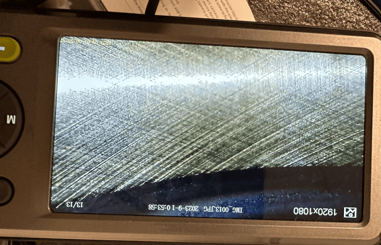

Thanks for the response. I value your opinion as you seem pretty knowledgeable around here :) I'm going to stick with the 5W-30. I found a "Garage Box" that is bulk discounted vs what I used to pay for it in the 5 quart jugs. I exclusively used this oil in my Cruze and the cross hatching is still looking really good at 145,000 miles so I think I will use it in the Mustang too. I was thinking about using the FL-500-S in the owners manual but I'm not sure if there are better alternatives for the oil filter or not. The owners manual does say " 1 If a Motorcraft oil filter is not available, use an oil filter that aligns to SAE/USCAR – 36 Performance Specifications. Filter Type C " so I think you could use something else and not void your warranty as long as it meets that criteria. Still trying to find a drain plug that will make future changes easier but I might wait for the next change. Another poster recommended a Form-A-Funnel thing I'm getting to help direct the used oil for now.
S650 Mustang Any downside to using 0W - 30 ? 1696184954549
Cruze cylinder wall at 145,000 miles:
S650 Mustang Any downside to using 0W - 30 ? 1696185041658
