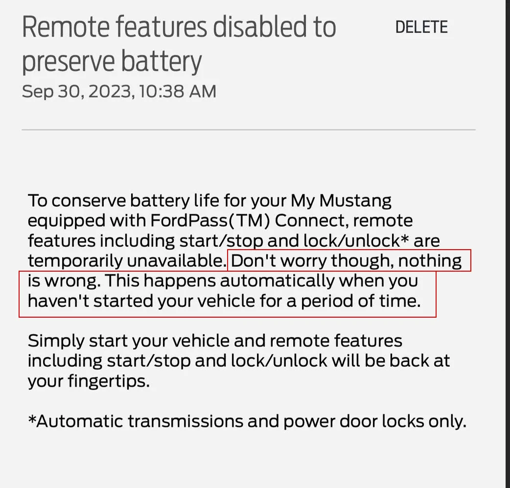

First and foremost: thanks for the heads up.
it seems that message is sent when the battery is approx 50%.
onto the charger she is (current state - no pun intended).

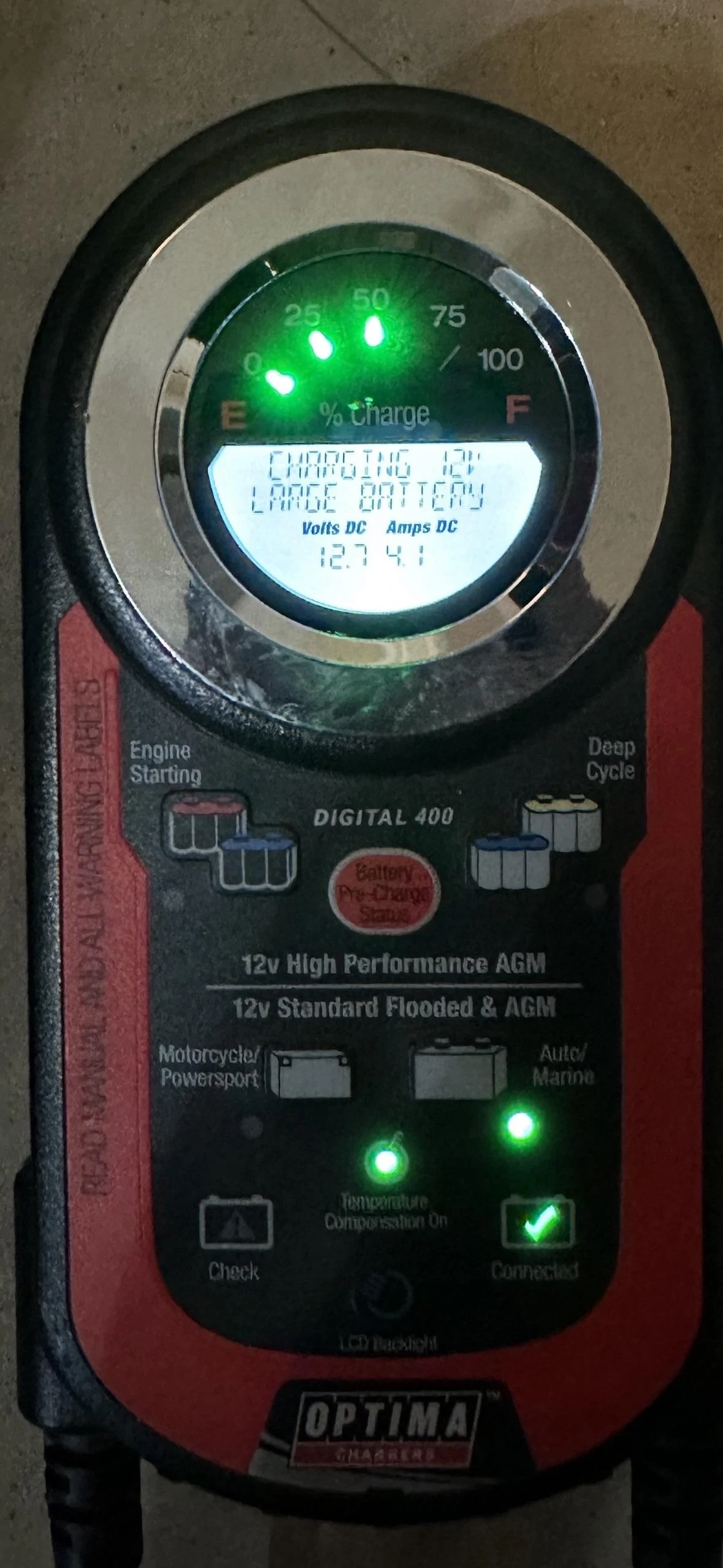

24 hours later:
S650 Mustang Remote features disabled to preserve battery - Fordpass message IMG_0321
Edit:
Image in post #1 is dated - 9/27/23 8:30 am.
Image in post #4 is dated - 9/28/23 8:30 am
Order placed on 6/17/23
Vehicle built on 8/17/23
Took possession/delivery on 9/22/23 (w/20 miles on odo)
drove from there to here. Took a look at various available vehicle settings (started going through the center screen one setting at a time). Found out it takes longer to go through all the settings than the accessory time out allows. Sat for a day or two then drove from here to another there and back again. Now 57 miles on odo. Sat for less than 24 hours and received the aforementioned Fordpass message.

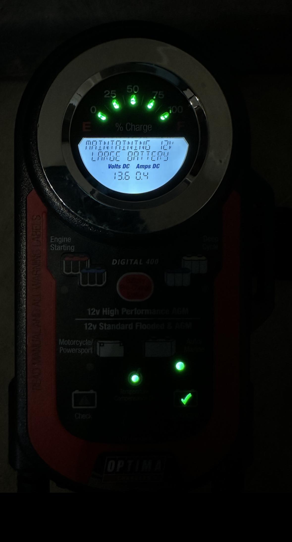

I did reconnect the charger (and made sure to lock the car) when we returned and it reported: 50% - charging 12.6 @ 4.1 an hour later it was 75% - charging 13.6 @ 4.0 one hour after that it was 75% - conditioning 14.7 @ .7 five hours later (got busy) it was 100% - maintaining 13.0 @ 1.6.
