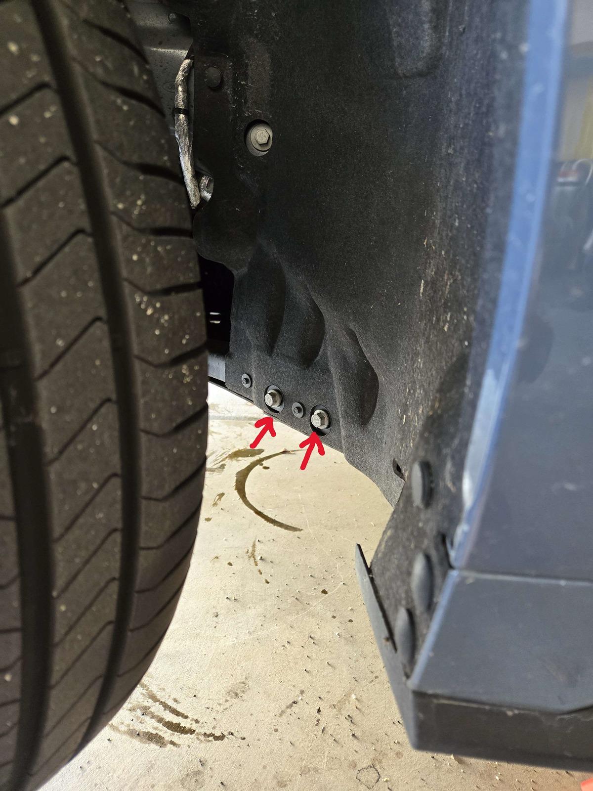

Anyone know the torque numbers for these bolts (don't know what they're called)

I was installing the air deflectors on the performance pack the dealer forgot to install so I loosened up the bolts marked in the pic thinking I needed to remove them, but the aeros already had a pre cut holes for those two bolts. I have no idea what these two bolts are for so I don't even know what to look up for the torque specs.

Tight. Worse case and it’s really a swag of a fudge but if you didn’t break the other side free you ‘could’ potentially use the torque of the others to find the value.

That is for the lugs. 150 ft lbs seems high for those. You can use a torque wrench for the other side like suggested to get a close ballpark.

Take one all the way out and see what metric thread size they have. Match up the markings to see what grade/ class they are. Grab a chart from the internet.
I suspect they are grade 5 and 8mm? If that's the case maybe 20 ft lbs?
