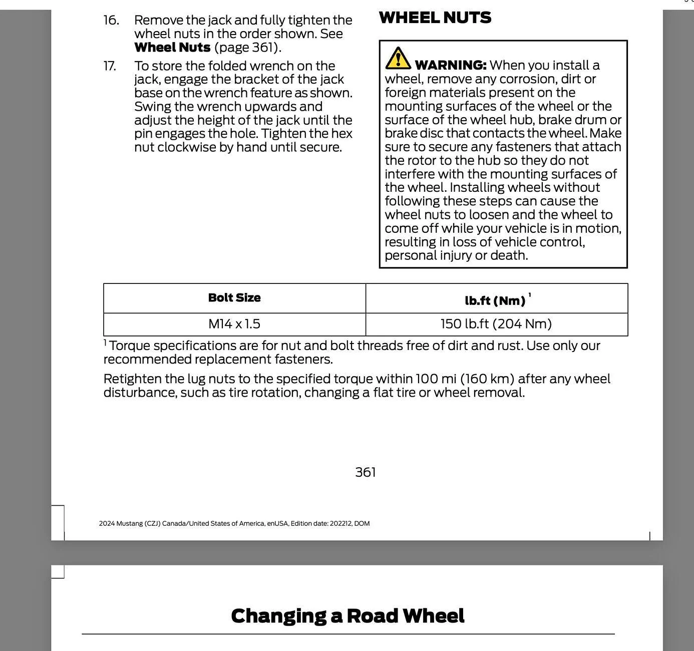

The wheel studs are bigger than the older Mustangs so the higher torque to 150flbs can be achieved. Would 100 flbs be Ok more than likely. I have a torque wrench in the tool box that I use when building an engine so why not grab it. If one has been doing wheel changes/rotations feel tightness over years will work fine.
Why would the manufacturer publish an instruction manual (aka Owner's Manual) saying 150 ft-lb if 100 ft-lb would suffice? Why use SAE 5W-30 motor oil, why not use 10W-30 or 5W-50. My point? The Owner's Manual was established with content from the experts. Who knows best?
1,252
1,004

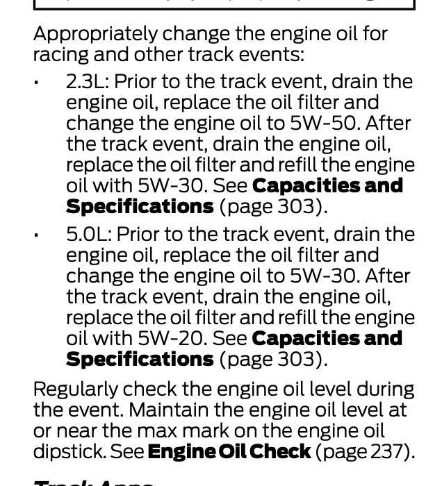

I believe all of the Coyote engines called for SAE 5W-30, the only diff being the GT350 and I believe it called for SAE 5W-50. I'm confident the oil changes came from clearance / tolerance changes in the diff Gen engines. Again, the engine builders / engineer's are the ones advising us what SAE oil to use.
1,252
1,004
I'm talking about the last couple years before they switched back to 5W-30 in 2021. Meanwhile they always said to use thicker oil 'at the track' in the manual. And the track pack cars recommended 5W-50, with the exact same engine as the regular GT.
They started with 5W-30 for the modular engines, then switched to 5W-20 somewhere around 2001, and now they switched back.
Will 5W-20 protect your engine? It obviously does. But is it 'the best' oil? No.
The engines never changed when they changed the oil specs. Remember they have more people than just the engineers deciding stuff. They probably do facepalm when an decision like that gets pushed down.
Automakers get tiny fuel mileage increases from thinner oils that multiply across millions of cars, things like that. Total Cost of Ownership goes down when they recommend higher oil change intervals, etc. Probably the same reason they have 'lifetime' fluid fills in some cars these days...
