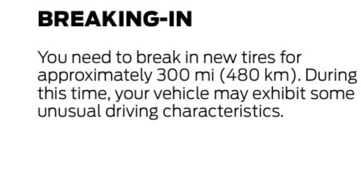

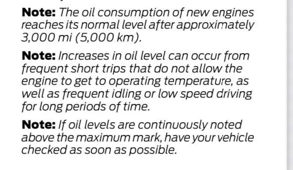

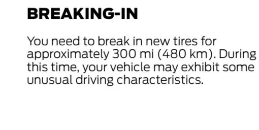

What Ford actually says in your owners manual is a little different (and also not that hard to find)
BREAKING-IN
Your vehicle requires a break-in period. For the first 1,000 mi (1,600 km), avoid driving at high speeds, heavy braking, aggressive shifting or using your vehicle to tow. During this time, your vehicle may exhibit some unusual driving characteristics.
https://www.fordservicecontent.com/...ingEnabled=False&userMarket=USA&buildtype=web
The pdf version has:
page 275:
S650 Mustang 4500 rpm limiter IMG_0248
page 299:
S650 Mustang 4500 rpm limiter IMG_0249
