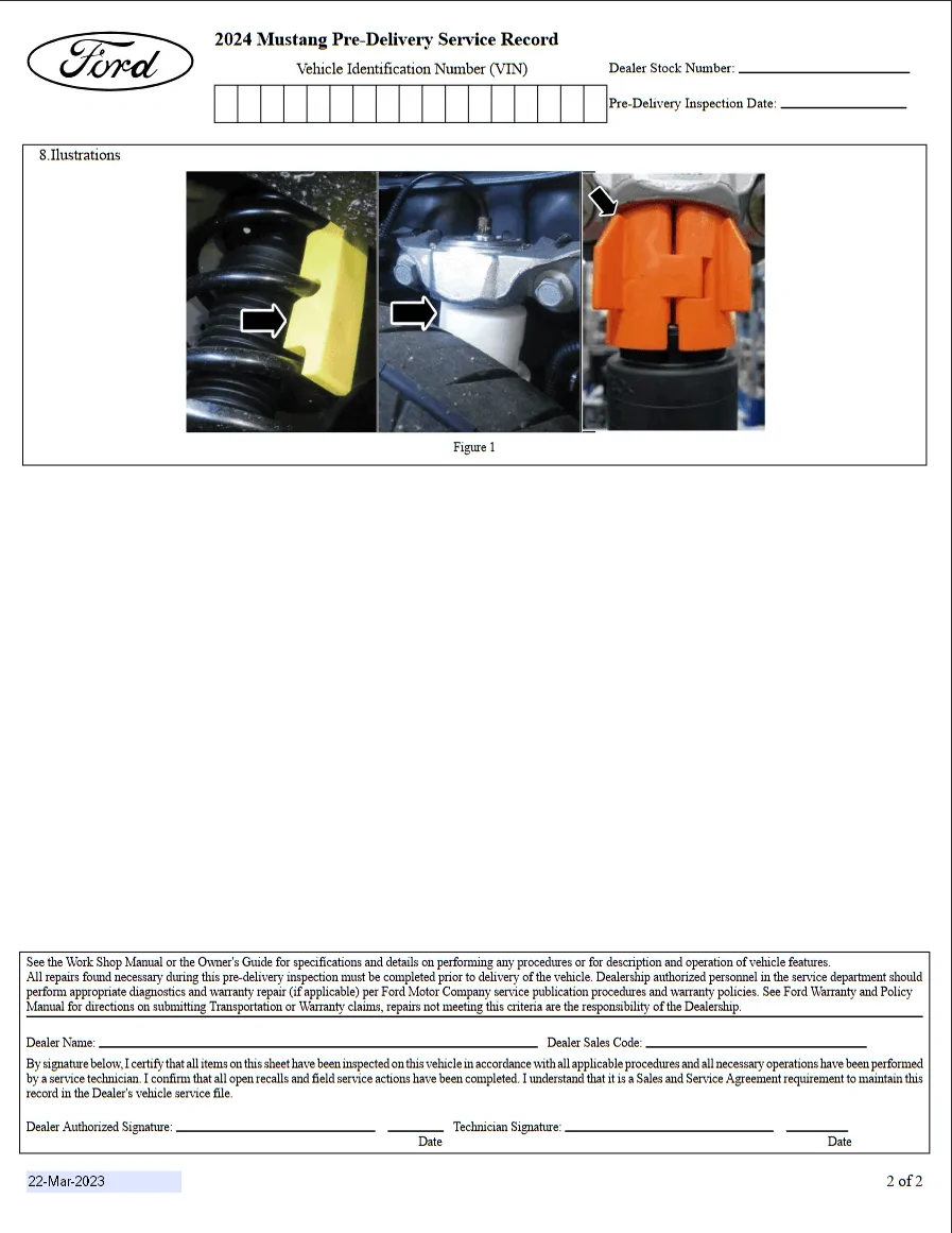

Also so many dealers left in the shipping blocks in the springs on the Mach 1s. Make sure you check everyone. I wonder how many dealers actually read this.

With respect to the Gurney Flap, in previous years, two sets of screws were involved. Short screws were basically hole fillers, when the flap was not installed. Long screws held the flap in place. Installing the long screws without the flap risks cracking the wing.
