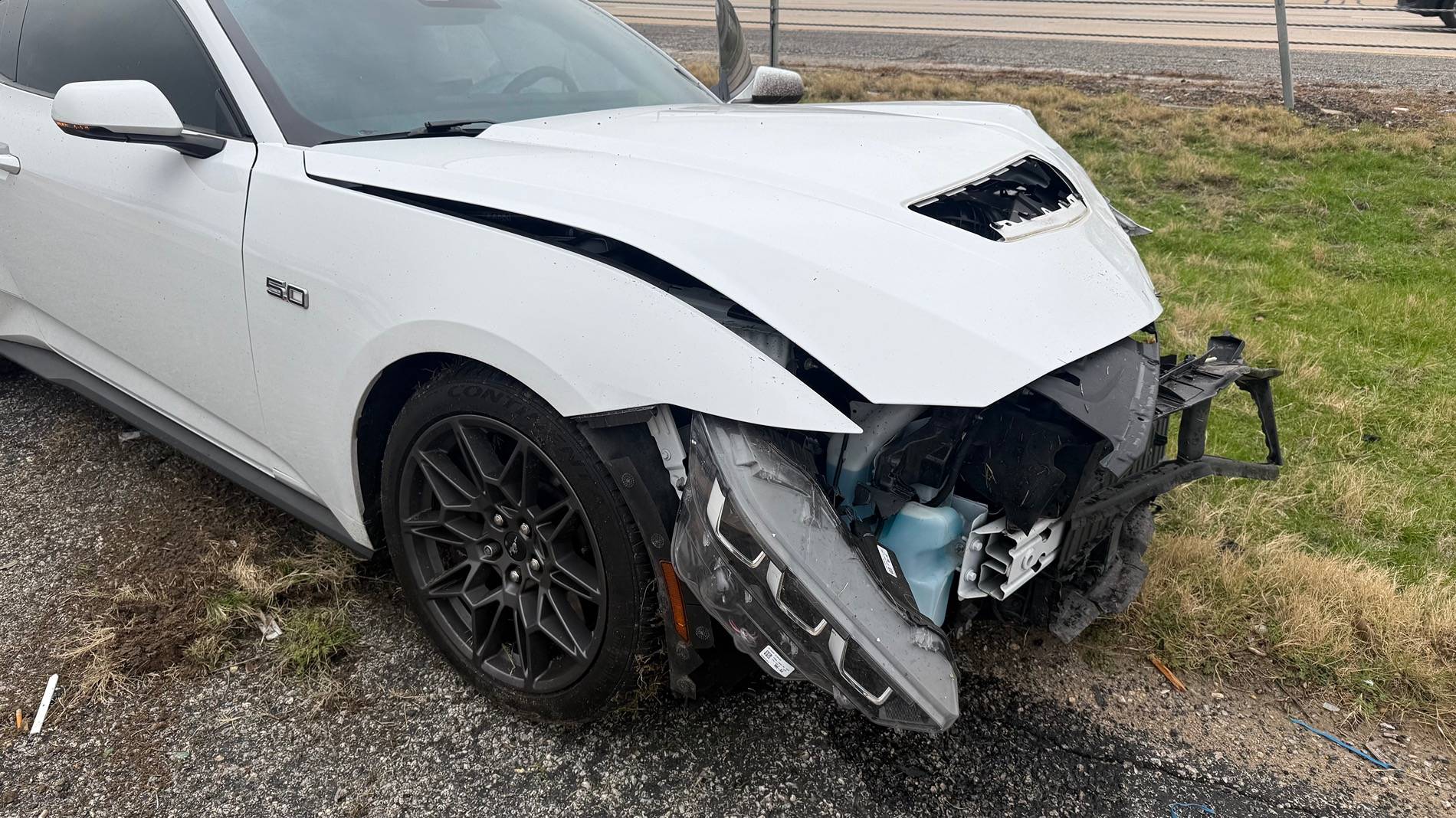

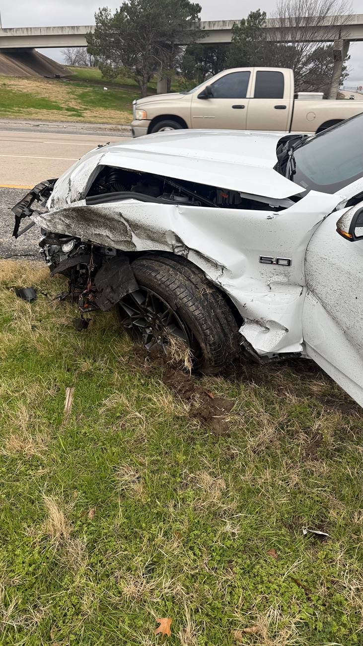

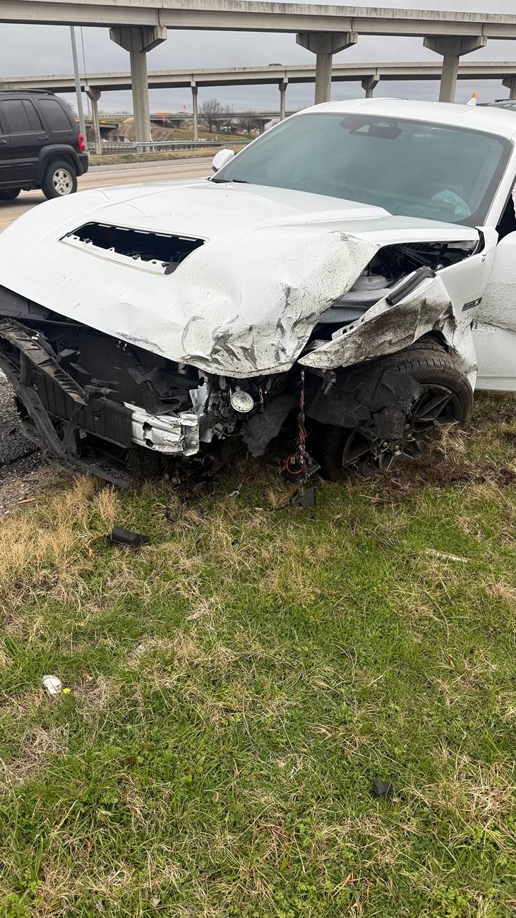

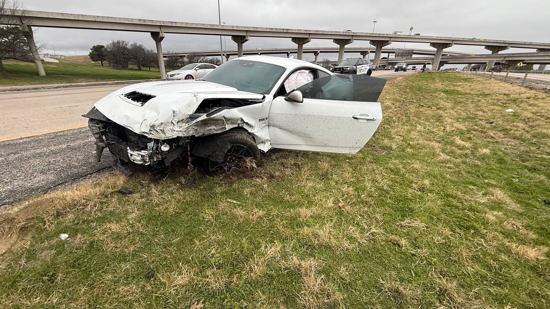

Had my new Mustang for 6 days. Owned a 2015 for years and never once had a close call, same with my 2020 Supra. First week of the 2024 and I lost control driving straight on a highway during mild acceleration in normal mode on dry roads.
Don’t know if a tire popped, wheel was damaged, tie rod snapped, or maybe some other odd reason or mistake I made. Dashcam was in the mail, and not a single car that was around me stopped to see if I was okay so all I have is a memory of hitting a minor hump in the road and then the vehicle jerked left and I was unable to get it back straight after it veered left and lost control into a guardrail.
Other odd thing was about a mile before I got a notification regarding the front camera being obstructed and collision assist wasn’t available, but not sure if this is related.
What’s everyone’s thoughts? Is she totaled? Anyone experience or seen anything like this?

@Exodrai ..... first thank God you/family/others weren't injured. The pictures gave me a knot in my stomach. I feel real bad for you but at least you are alive to drive Mustangs! Second, although some body shops can do amazing repairs, I'd want it written-off. I can't believe it will ever track right and the re-sale would be bad. Third, a couple of years ago a Porsche suv passed me going about 85 mph. Up ahead it looked like he hit a piece of 2x4 on the highway. He shot right into a guard rail and across onto the opposite lane. I'm sure it was a write-off too as one of his front wheels was dangling. The 2x4 went flying too. It happened so fast I think the steering wheel was just jerked out of his hands or the front wheel just swung it his suv around. I was way past as I was only a couple of car lengths behind him but others stopped. Fingers crossed that your insurance company writes it off.

im so glad you're alright! that sucks about your car, though. unfortunately, with damage like that, it might be better off totaled. its never going to drive quite right again, even if it looks perfect. honestly, i would recommend that (if this is even a thing) an investigation is done on the cause of failure. i am guessing here, but your description almost sounds like there was a faulty part, because most debris on the road that could do that would be very hard to miss, and the pre-collision assist message would not have done that. im hoping everything works out, man!

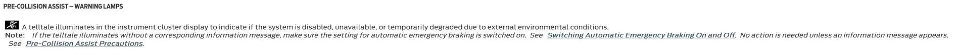

This right here is pretty scary. I know the message mentioned collision assist but did you have lane keep or anything else active which could have glitched if there was a camera or electrical issue?

Yes I believe all systems were active, and if I remember correctly when looking at all the settings the lane keep assist was set to "Aid only" at the lowest setting. Ill attach a snip from the owners manual of the error light that was illuminated. I had just picked up the car from the tint shop and looking at the camera location behind the rearview mirror it looks like it was just dirty. I didn't get a message saying anything was unavailable except for the pre-collision assist.

Usually when the system gets turned off it is due to a blocked radar sensor(located in the center of the lower front bumper). In which case it will stay off until the next key cycle for it to try again. That would indicate to me that the "driving aids" that everyone seems to credit(and want to disable) for an accident like this were actually disabled at the time of the accident. Sorry for your loss and I hope you are able to find another car that meets your desires. They are out there.
