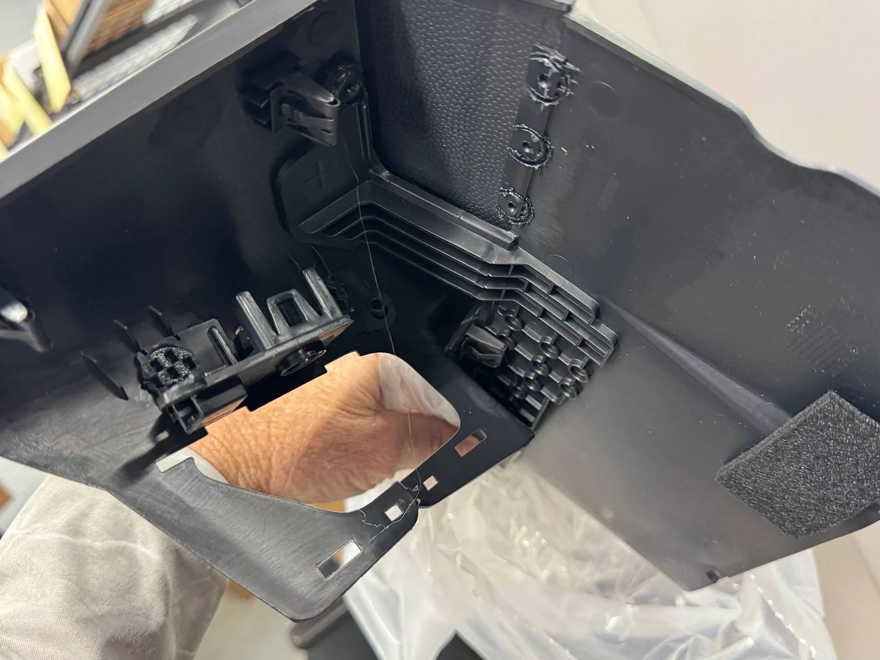

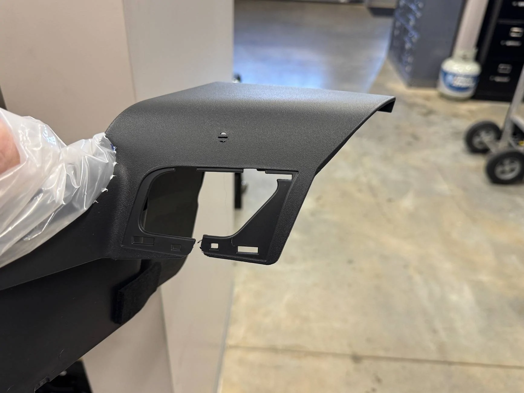

I took delivery of my car in September 2024 and after a couple weeks did a deep dive into all the aspects of ownership. While inspecting the convertible storage compartment I found a couple wires loose not connected to anything . Upon further investigation both the left and right panels where the seat belts go through where missing what the dealership calls microphones. Any body know what these ICE microphones do. Here are some pictures where the device is supposed to be installed in the panels….

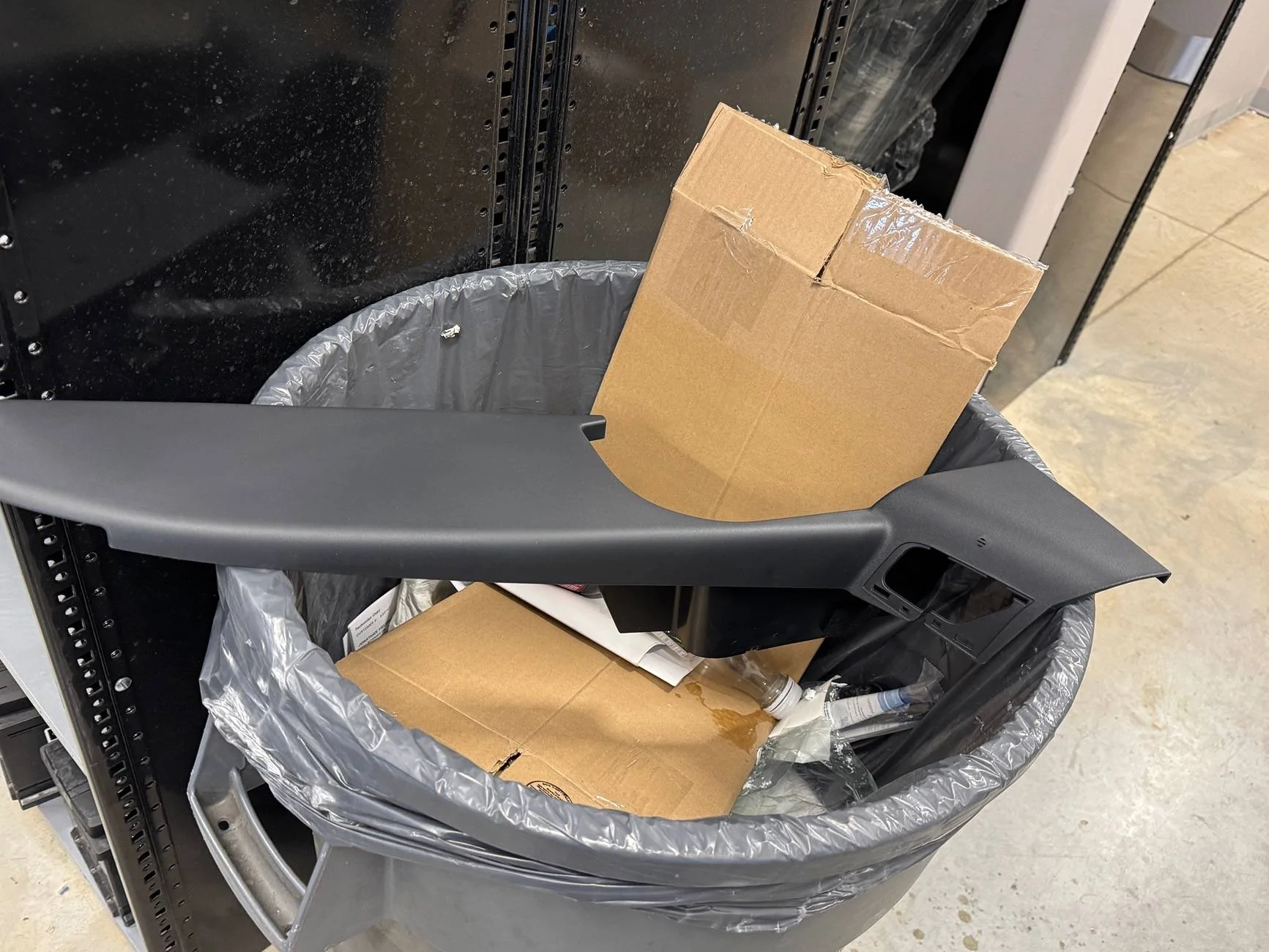

Thanks for the information. The dealer I am working with has yet to get the microphones. I find it odd that they don’t seem to know if the car should have them and what their function is!!!!!

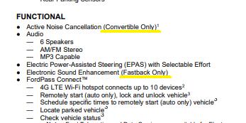

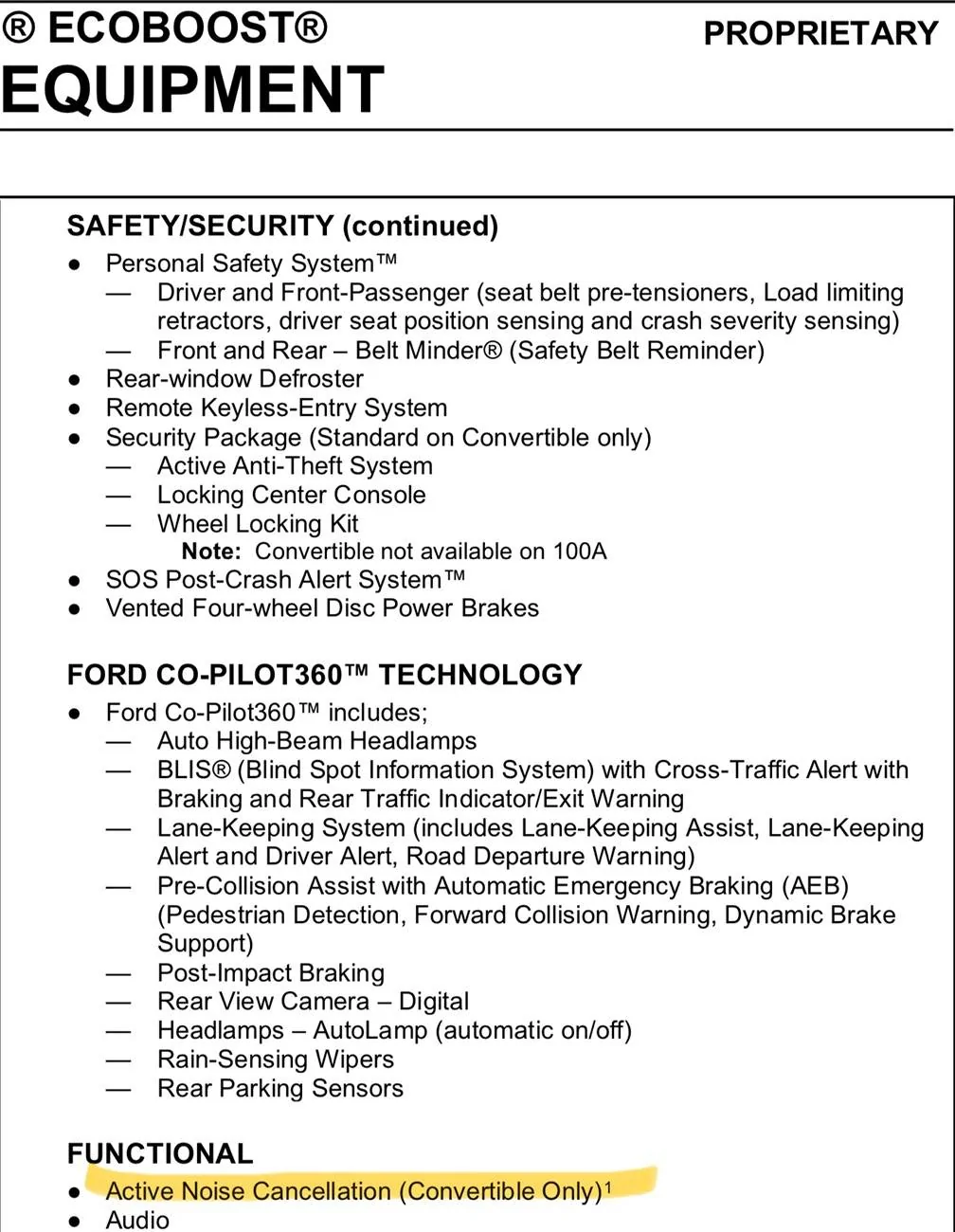

The microphones are for the "active noise cancelation".... standard on convertible only, according to the order guide. Apparently the "electronic sound enhancement" is fastback only... I guess convertibles get the "top down" sound enhancement.

I believe the order guide indicates ANC is installed on the Eco Boost convertible, but not the GT. At least that was the case when our salesman looked it up.

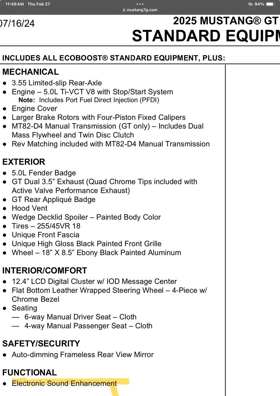

GT includes all Ecoboost standard equipment...

Lol, that's not quite right either... ANC is convertible only (Ecoboost) ESE is FB only (Ecoboost).
And appears all GTs get ESE, FB or convertible.
