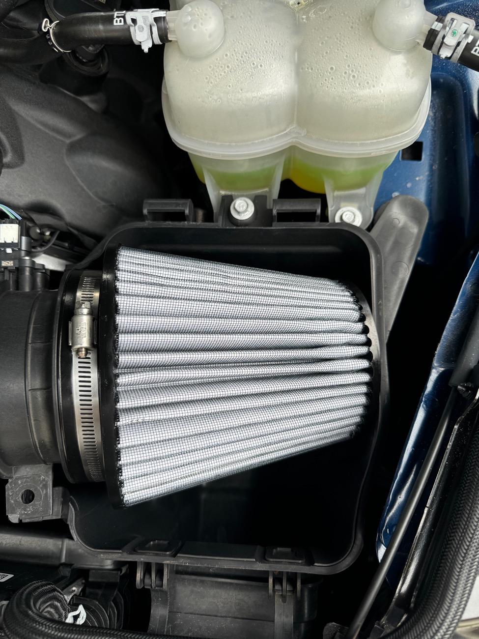

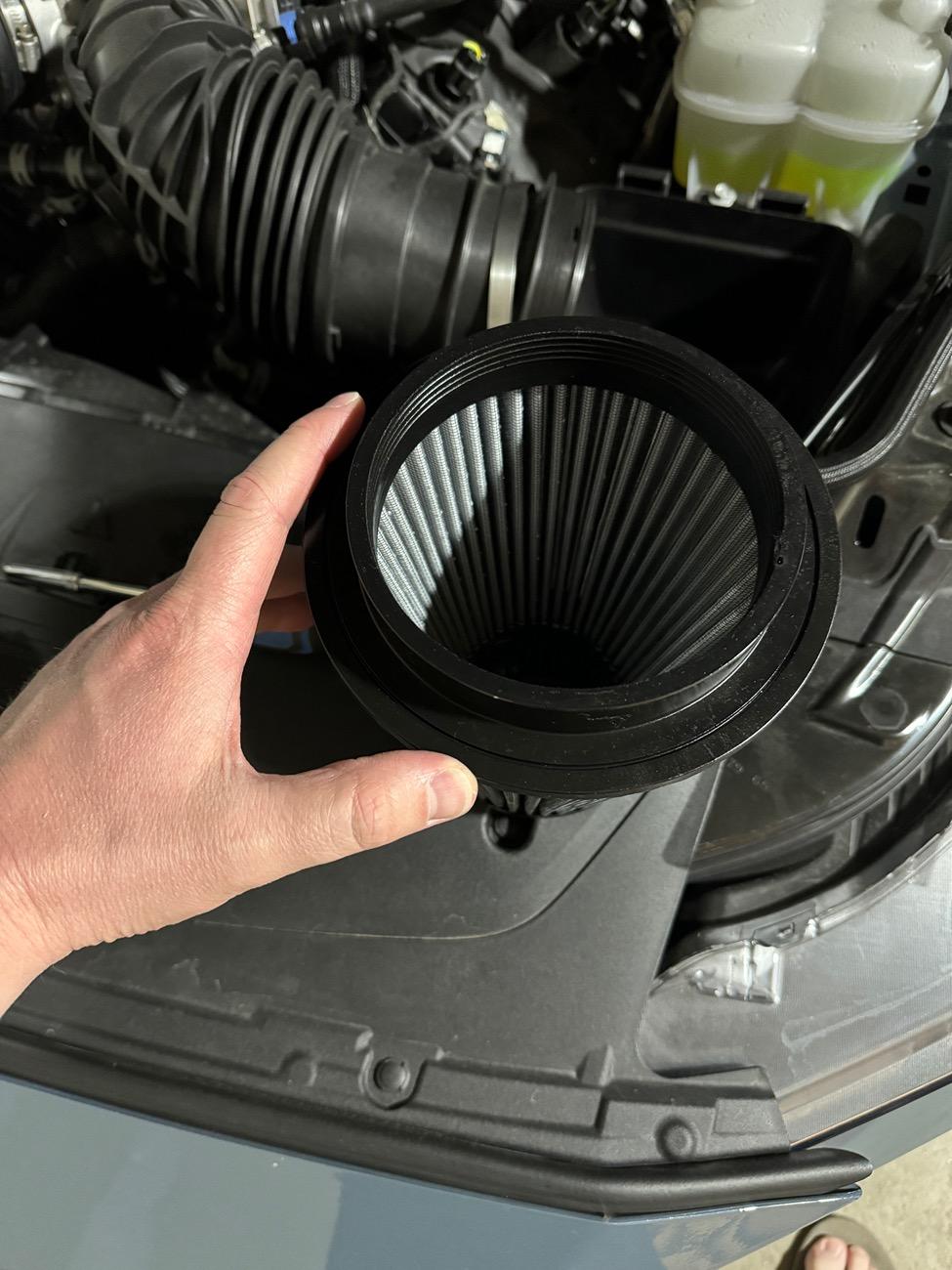

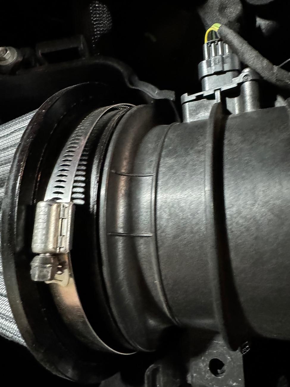

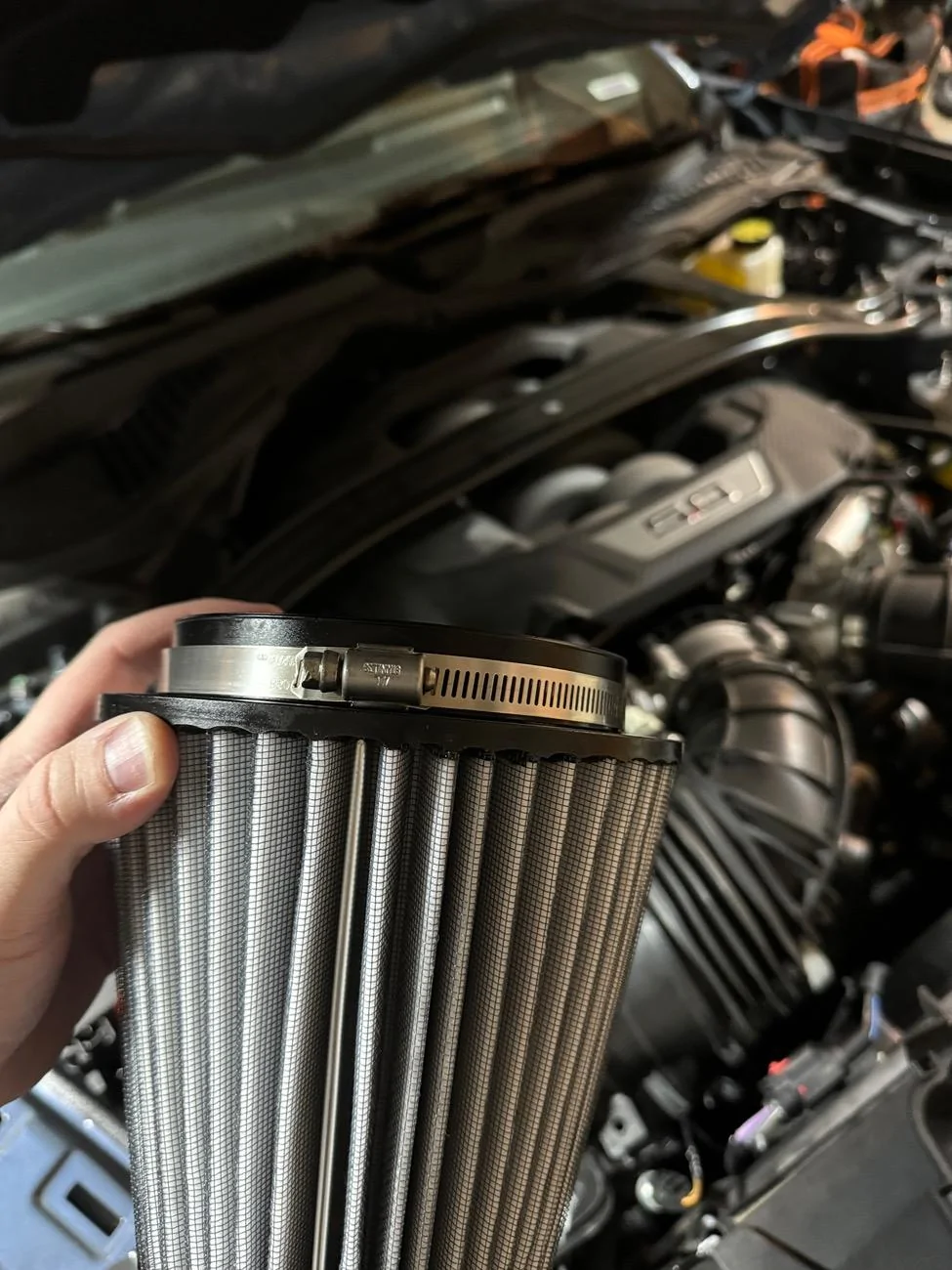

I just went out and installed 2 in my car. I have been running prototypes previously.
They are tight but will go on. I spun them a little while rocking them by the polyurethane mounting end. Please do not try pushing them on by the end of the filter as this can crush them.
Make sure to get each rib over the end of the intake before going to the next one.
They will loosen over time so I wanted to keep the tolerances tight initially. I’m trying to show in the photos how I hold the filter while installing it but didn’t have a free set of hands to take the picture so imagine both hands on it. You can also put the clamp up on the intake and then slide it over the filter once seated (last photo) to eliminate any concerns with it being too tight.

Installed mine the other day. While they are tight, a little force while turning them slightly with the clamp off works. However, being that the tolerances are so tight I don’t see how there was any way of not disturbing the media to some degree.
