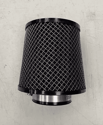

It literally looks EXACTLY like the Desertcraft filters.
Clearly, on-road vehicles aren't operating in the same dusty, dirty environments as SXS are, but the Desertcraft filter would be an absolute NO GO on my SXS if it was the primary (main) air filter.
We actually use them as pre-filters, installed BEFORE the OEM filters in the main airbox.
Not only that, but we run a Filterwears cover over the top of the Desertcraft filter -- almost like having three air filters!

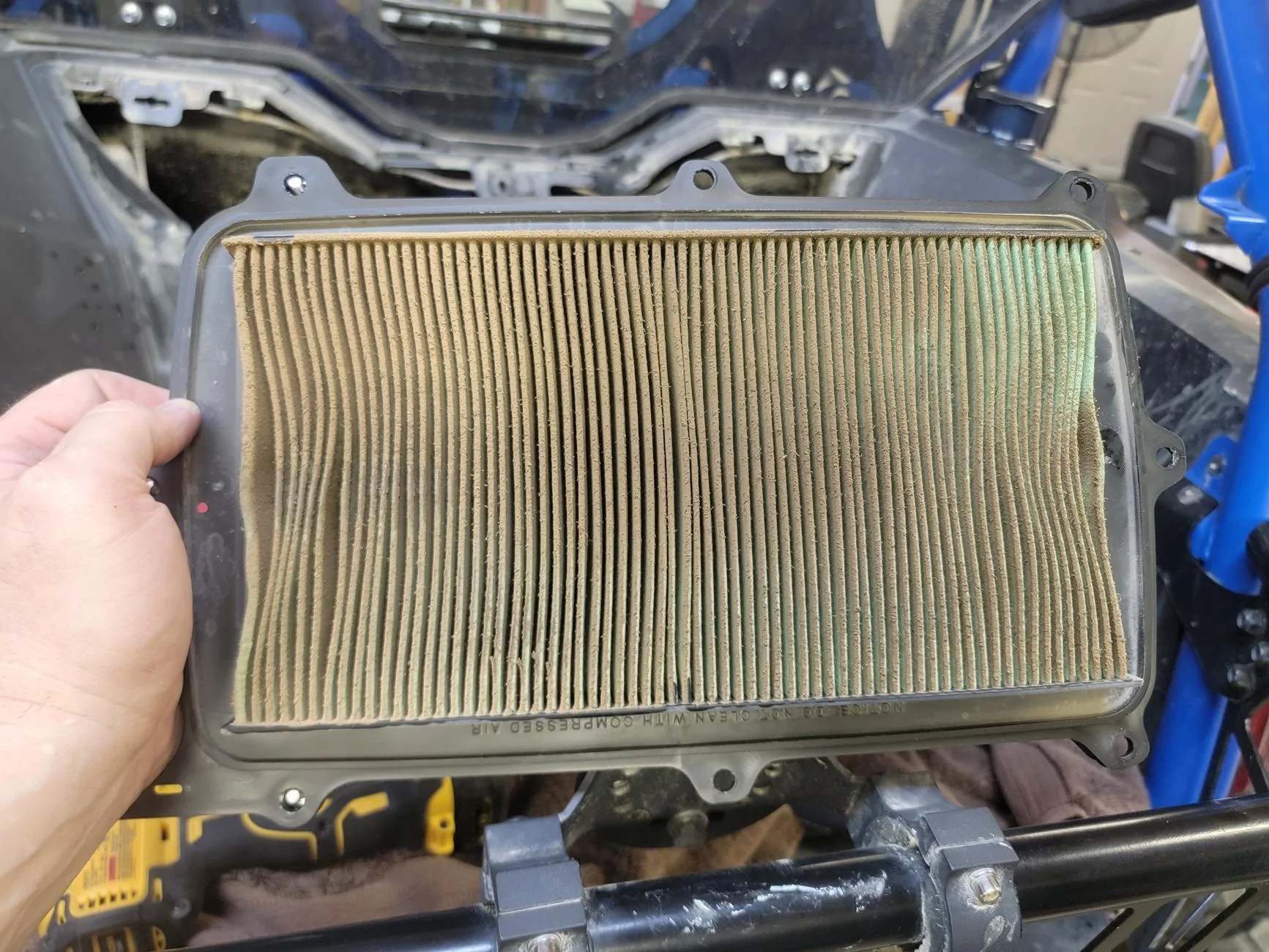

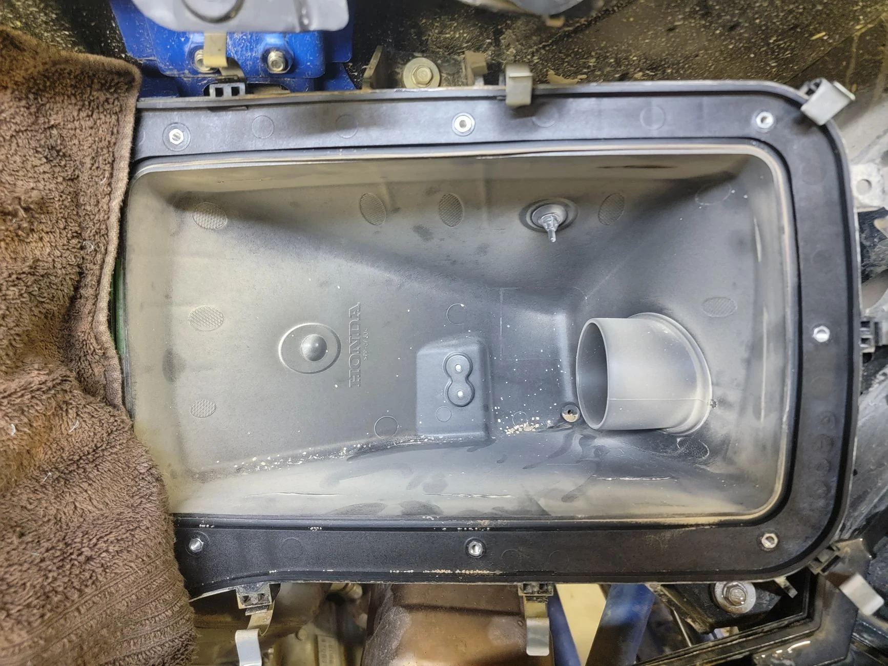

The problem is: Unless you clean these Desertcraft filters VERY regularly (every 100-150 miles) using a water hose and either Simple Green, Dawn, or something like that, the filter WILL get overloaded and let fine particles to pass from the pre-filter to the dirty side of the OEM airbox.
If you clean it regularly, you can keep the dirty side of the airbox (and your OEM filter looking brand new) for 10,000 miles or more. But if you don't, here's what the inside of the airbox and the OEM airbox filter look like:
S650 Mustang 2024+ Mustang GT Air Intake Filters 2024-06-29 21.18.19
S650 Mustang 2024+ Mustang GT Air Intake Filters 2024-06-29 21.18.30
IMHO, the main problem with dry reuseable filters is that they don't filter well if not maintained on a VERY regular basis, depending upon your operating environment.
Here's the Desertcraft (new):

That’s an interesting setup. I see a lot of separators and extra filters like that on off road racers. Desertcraft seems to be a surface blocking element versus a loading type. So these are different. These are more similar to a paper element but large particles will fall off still versus getting stuck on the surface due to the very tight structure.
The reason these will need to be cleaned more often is due to them filtering out that much more debris than other filters. I have about 1k miles on them without needing to be cleaned.

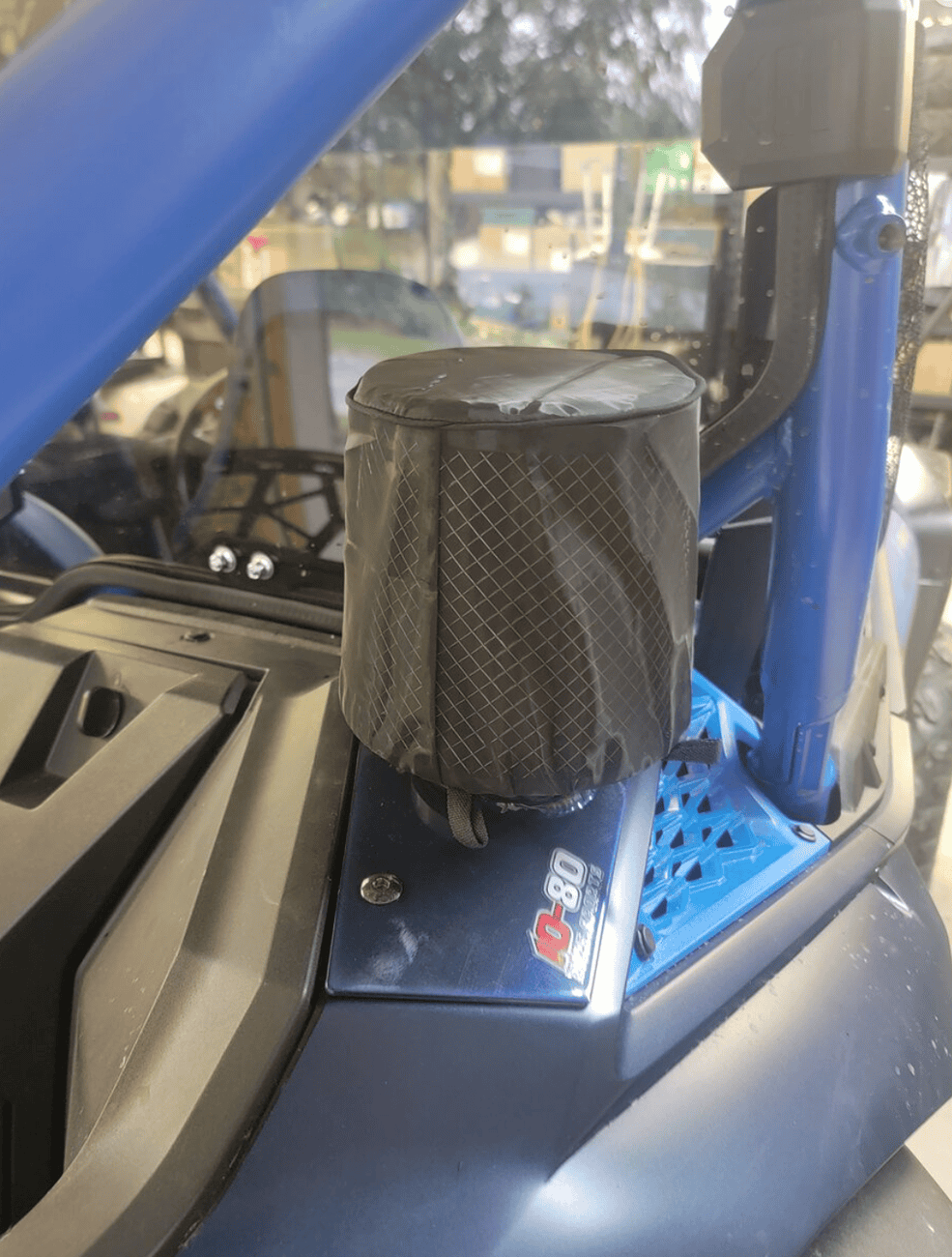

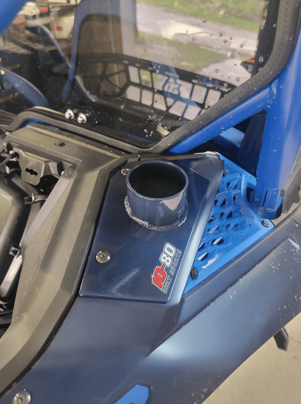

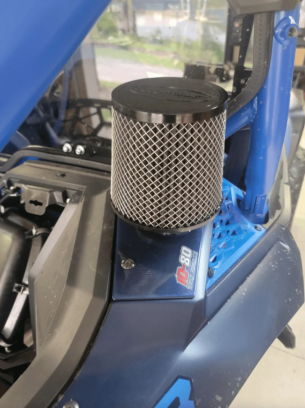

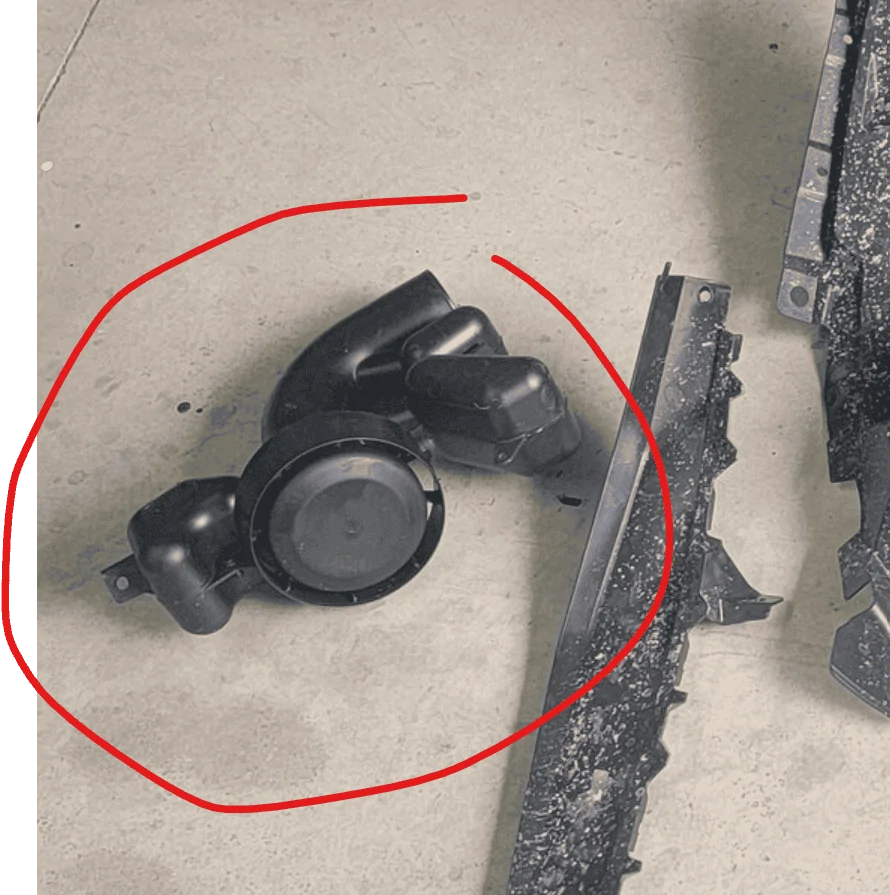

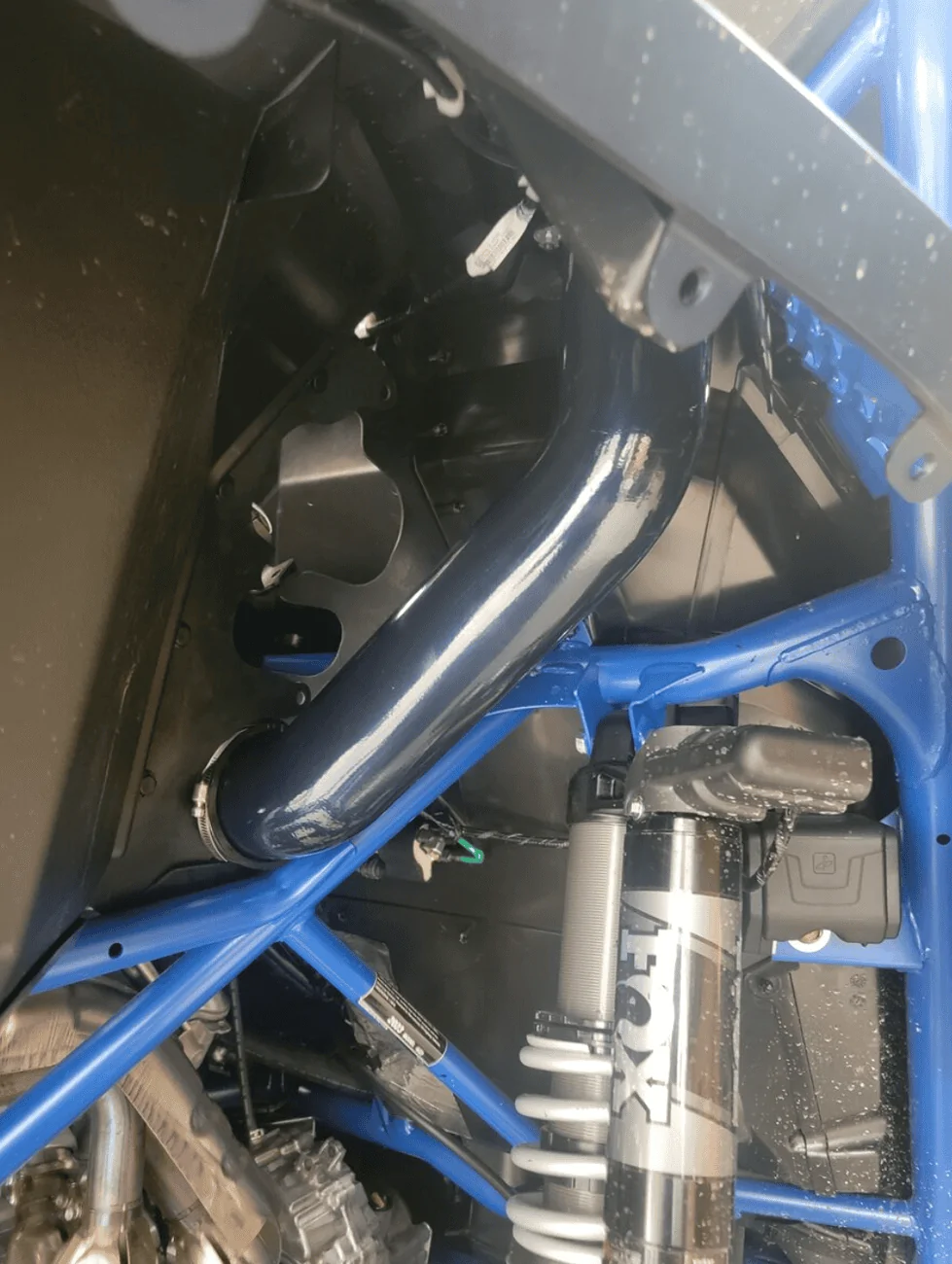

The pre-filter replaces what is essentially a tube with an ant farm looking contraption that is essentially an open hole at the end that comes out of the OEM airbox. Without it, Honda expects you to be replacing the airbox filter every few hundred miles. Totally stupid.
Here's the installed pre-filter ... most of the tube is hidden behind the plastic once it's done.
