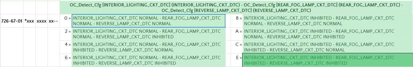

Yesterday I was scrolling through the spreadsheet and I found a second line in the BCM module that talks about enabling the rear fog light.
BCM:
726-39-01 xxxx xxx* xx--
0=Disabled and 1= Enabled
726-67-01 *xxx xxxx xx--
4=Disabled and 0=Enabled
IPC:
720-02-02 xx** xx--
4=Disabled and 6=Enabled
The one I found is the 726-67-01
And I figuree out it should be switched to 0 to enable it.
Do you have any idea what those two lines do? They seem to be doing the same thing "enabling the rear fog light".

I would assume the one in the IPC are to show you the icon that the rear fog is on and the one the BCM is to actually enable it.
GrabThatBlue
Jan 13, 2025
2,421
2,645
Between Canada and Europe
But there are two BCM lines to program and 1 in IPC.
rugedraw
Apr 17, 2024
476
594
Miami, FL
The change on 67-01 I would leave alone unless the change in line 39-01 alone doesn't enable it. I'm not sure what this does, but line 39-01 seems to make more sense in terms of what you want to accomplish here.
