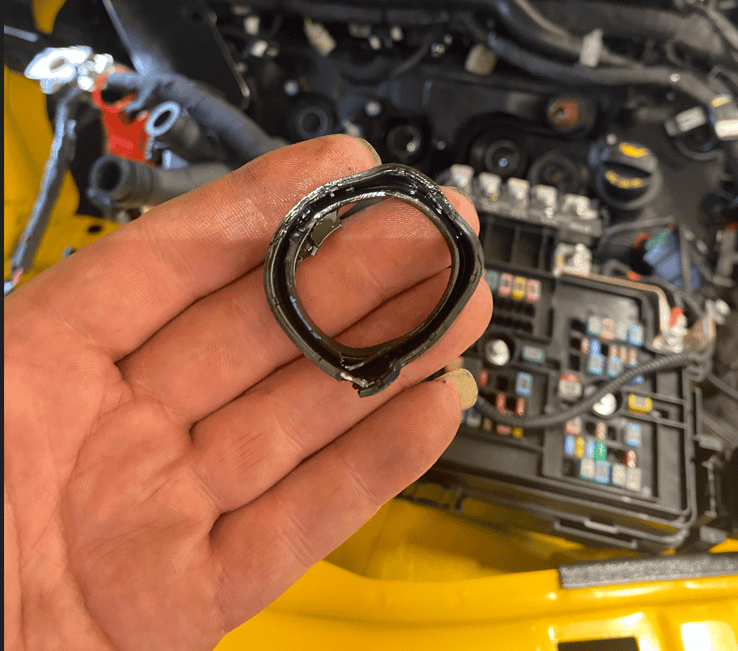

I need help. I saw that there was an oil leak and started checking everything on the car, the problem was one of the spark plugs had oil, checked the seals one of the seals was broken therefore I ordered the seal and replaced it. Had to remove the fuse box as it was on the way, and all the necessary hoses. Once I placed everything back, the car won't crank, the lights inside the car are turning on but the car won't start. Do I have to reprogram it with a computer or what do I need to do, I am double checking all the wires right now.

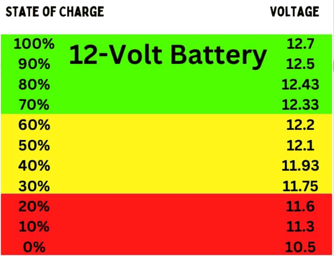

If the fuse box was removed does it loose its programming? All cables ate connected, battery was taken off 2 days ago and is reading 11.8 amps just started to charge it will let it charge for 3 hours see what it does

The car was running until we removed the fuse box, battery and took off the valve cover replaced the spark plug valve seal, installed everything back and the car just wont start, checked the fuses, charging battery right now.

I assume you meant 11.8 volts?
If so that is low, let us know what happens after you charge it.
From experience, bad grounds will ruin your day, best to just check things over.

... battery ... is reading 11.8 amps
I think you mean volts, not amps ... LOL.
That battery is close to completely discharged if you're only reading 11.8V at rest.
