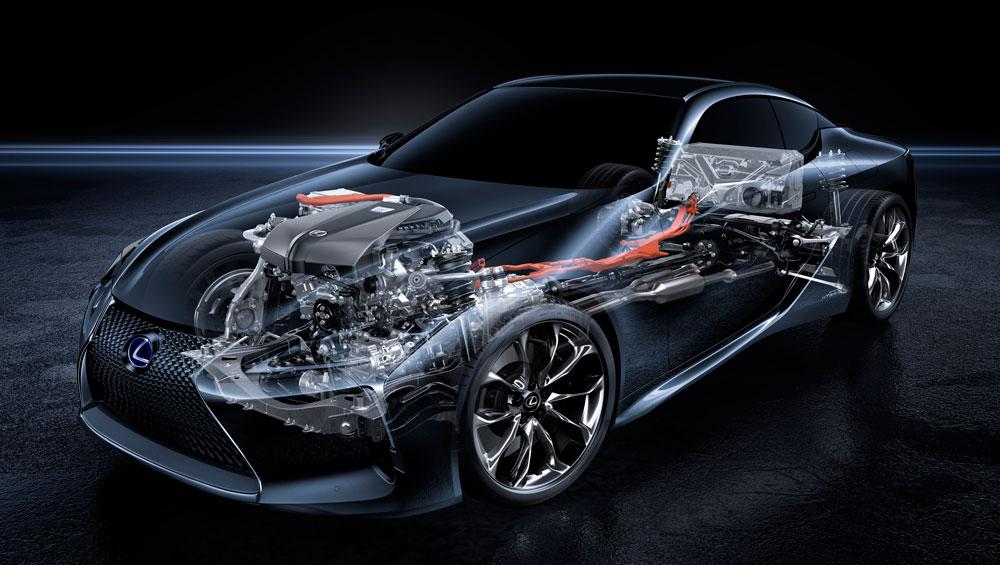

Most longitudinal hybrids have inline motor generator units, which are ideal if you don't want to tear up a body structure. Generally a small battery in the trunk, under or behind seats, with your HV wiring running up the tunnel to the MGU sandwiched between the engine and transmission which complement delivering power to the rear. Some cars have separate MGUs that do regenerative breaking and stop start, while the other is for propulsion. Like the Lexus LC500h which is what I imagine the Mustang will most likely be like to keep things as common as possible with the ICE Mustang if it's not AWD.

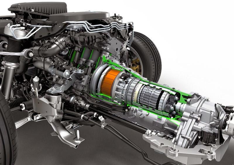

More than likely since its a new platform they could packaging protect for a front differential mounted to the engine, and do an inline setup like mentioned above with a 1 spd transfer-case and a drive shaft sending power to the front when needed...
Similar to new Hybrid BMWs.

Thanks for that info! I'd be bummed if it wasn't an AWD hybrid, but this route would make more sense. Either way, it'll be interesting to see what comes of this.
