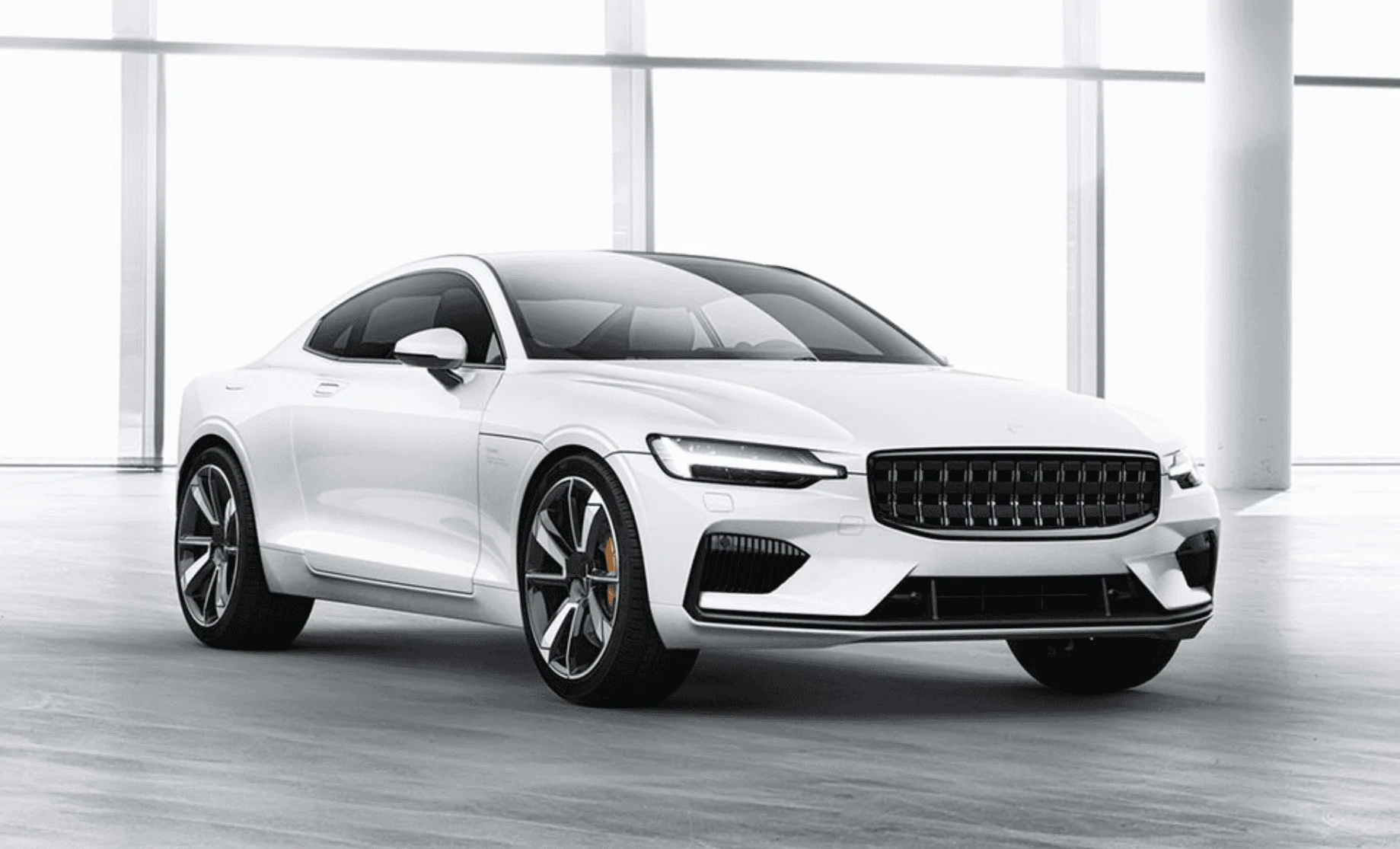

This is how you design a car. Not the crap Ford is experimenting with these days. What the new Mustang should have looked like from the front.

[MENTION=30916]Spirit Of Fire[/MENTION] that needs more mustang design cues. That is more Audi than anything.
