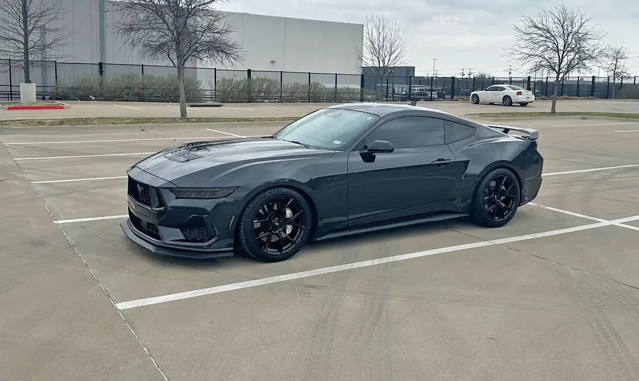

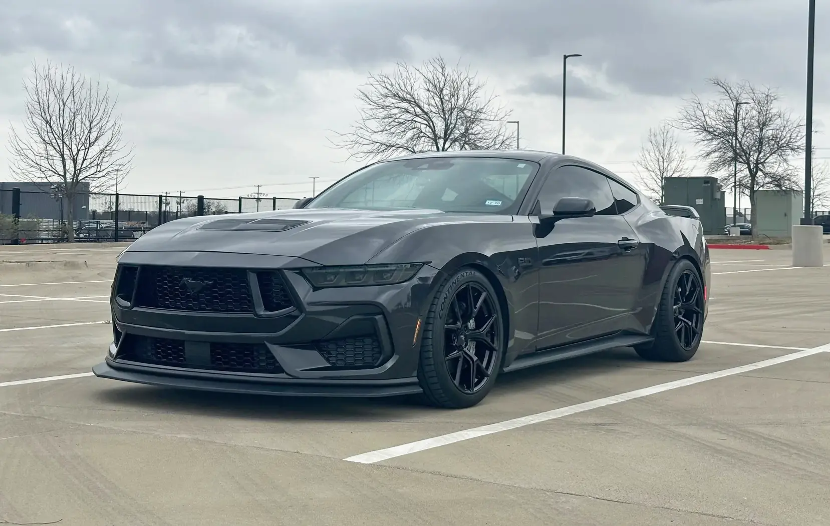

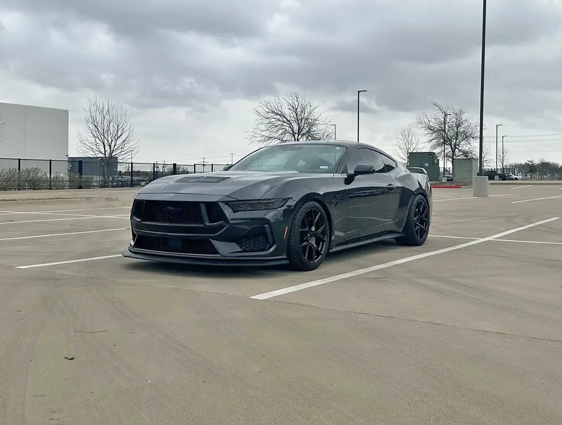

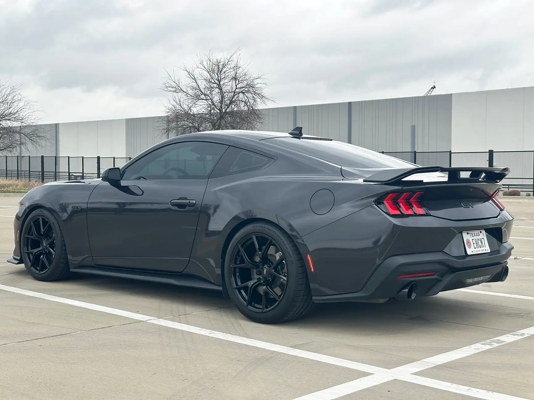

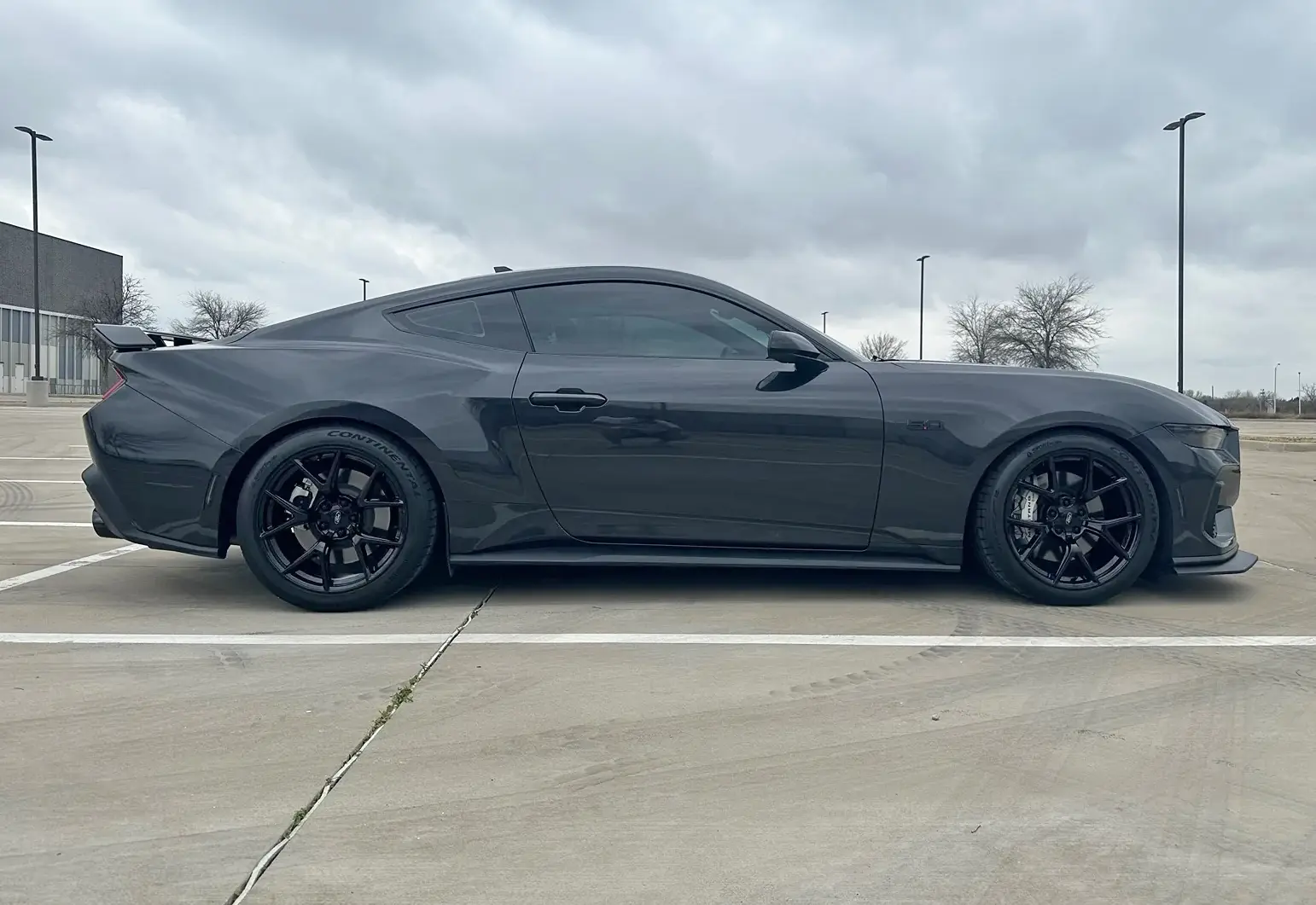

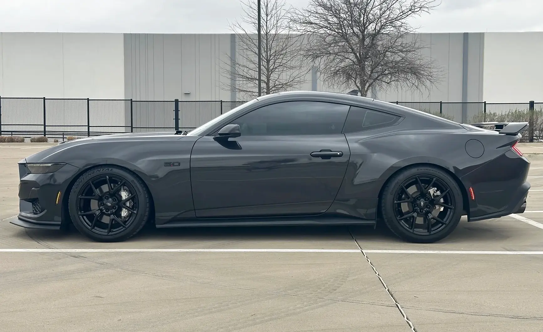

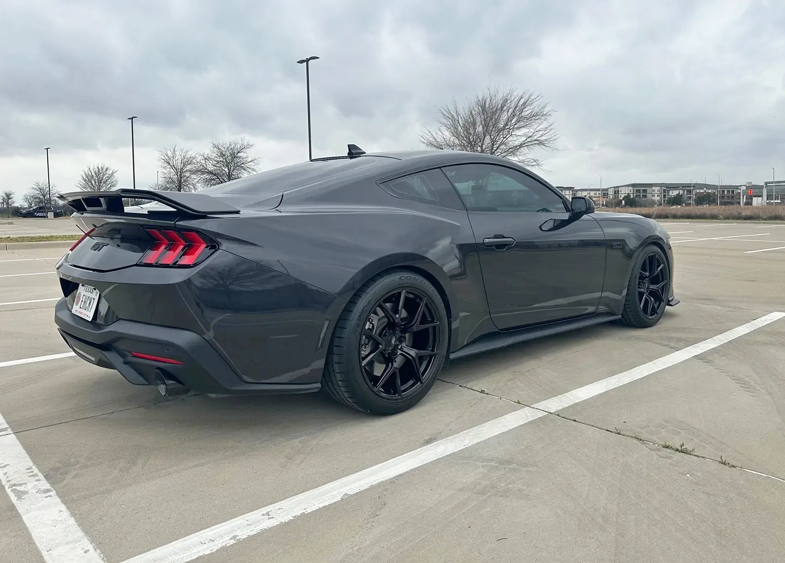

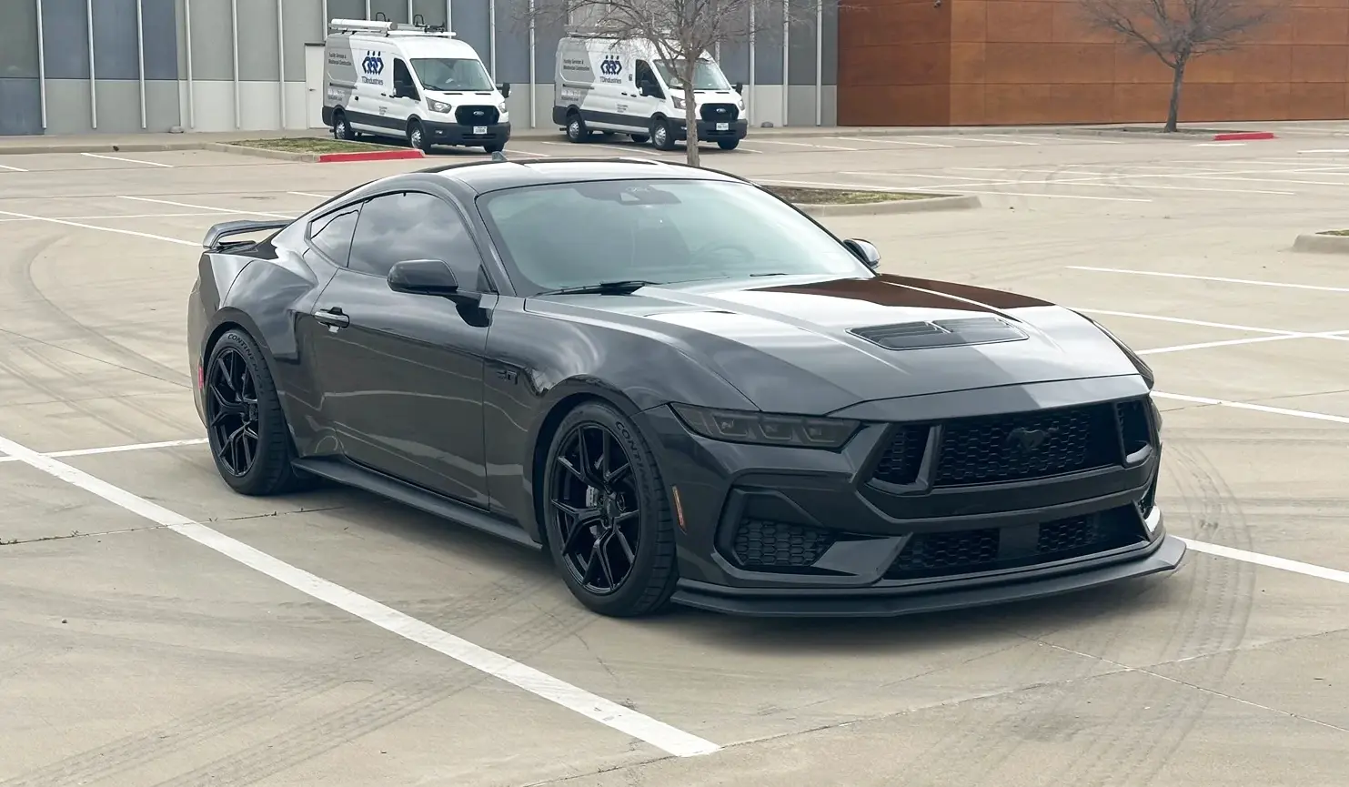

Hey everyone! Thought I’d post a review that could help people going forward for a more street friendly setup on their S650 along with some pictures of how the car currently sits. First off I have a base 300A 2024 GT. Only options are the 10speed, and NPP.
Suspension Set Up:
-Ford Performance Street Lowering Springs
-Ford Performance Strut Tower Brace
-Ford Performance Track Sway Bars
-Ford Performance Camber Plates
-Ford Performance Rear Toe Link Kit
-Steeda Pro Action Non Adjustable Shocks and Struts
-Steeda IRS Subframe Alignment Kit
-Steeda IRS Subframe Bushing Support Kit
Wheels:
SVE SP2 19x10, 19x11
Tires:
Continental Extreme Contact Sport 02’s in 285/35/19, and 305/35/19.
After having this completed (to me) set up for maybe a month already I can say from stock, to just springs, to what I have now is wow! The car has a less bouncy/floaty feel. It feels way more planted than before. The ride is a bit more harsher but it’s not bad whether you drive the car as a daily or weekend driver. Now when it comes to driving spiritedly and on the twists and turns the car handles amazing, there’s hardly any body roll and I feel like I can actually keep my speed on turns without feeling like I’m about to lose control. The FP sway bars are adjustable and they only have 2 settings/holes which is stiff and soft. I have mine on soft for both and even then it still feels great when pushing the car. Haven’t tried it on the stiffest setting or messed around with different set ups to see how it changes the way the car feels and handles but so far I am loving this set up. It isn’t too much but just enough to where if I want to take it every once in a while to the track I am sure the car will do well. I figured I’d post this for those who would rather have a street friendly set up without doing too much or get inspiration from it. I made this somewhat based off what Ford offered for a street handling kit on the S550 but I did add a few things to it. Any questions ask away!

How much front poke with those tires and what offsets? And does it need extra front camber to prevent rub? Car looking good.
Edson8r
Edson8r
Sep 9, 2023
238
269
Dallas, TX
2024 Ford Mustang GT, 2000 Ford Mustang GT
It’s not too much poke. It sits flush with the fender. They’re +35 fronts and +50 rears. I didn’t have any rubbing issues before the camber plates at least not with these springs. Thank you!
