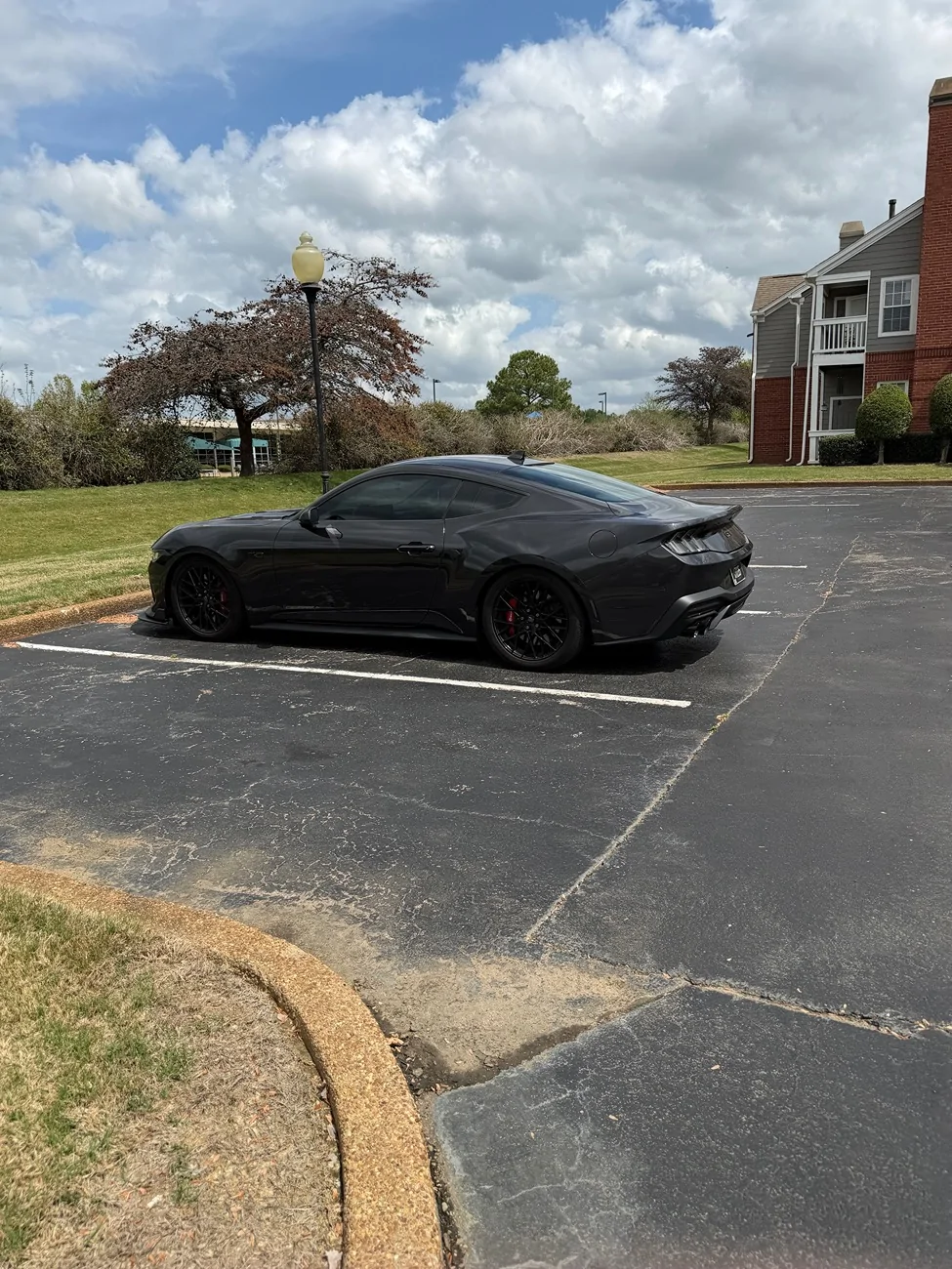

Hey everyone! Thought I’d post a review that could help people going forward for a more street friendly setup on their S650 along with some pictures of how the car currently sits. First off I have a base 300A 2024 GT. Only options are the 10speed, and NPP.
Suspension Set Up:
-Ford Performance Street Lowering Springs
-Ford Performance Strut Tower Brace
-Ford Performance Track Sway Bars
-Ford Performance Camber Plates
-Ford Performance Rear Toe Link Kit
-Steeda Pro Action Non Adjustable Shocks and Struts
-Steeda IRS Subframe Alignment Kit
-Steeda IRS Subframe Bushing Support Kit
Wheels:
SVE SP2 19x10, 19x11
Tires:
Continental Extreme Contact Sport 02’s in 285/35/19, and 305/35/19.
After having this completed (to me) set up for maybe a month already I can say from stock, to just springs, to what I have now is wow! The car has a less bouncy/floaty feel. It feels way more planted than before. The ride is a bit more harsher but it’s not bad whether you drive the car as a daily or weekend driver. Now when it comes to driving spiritedly and on the twists and turns the car handles amazing, there’s hardly any body roll and I feel like I can actually keep my speed on turns without feeling like I’m about to lose control. The FP sway bars are adjustable and they only have 2 settings/holes which is stiff and soft. I have mine on soft for both and even then it still feels great when pushing the car. Haven’t tried it on the stiffest setting or messed around with different set ups to see how it changes the way the car feels and handles but so far I am loving this set up. It isn’t too much but just enough to where if I want to take it every once in a while to the track I am sure the car will do well. I figured I’d post this for those who would rather have a street friendly set up without doing too much or get inspiration from it. I made this somewhat based off what Ford offered for a street handling kit on the S550 but I did add a few things to it. Any questions ask away!

Made an account just to ask this after I saw your review on the ford lowering springs and went looking for a post like this lol. I’m looking to get rid of my sr performance springs and am gonna get the fp street ones you have and figured I’d get the steeda shocks and struts while I’m at it. Do I need the camber plates and rear toe links you got or am I good without them? I’ll be running the exact same wheel and tire sizes as you as well if that help's

I have the Ford Performance camber plates on mine but you don’t really need them, but I do recommend them just in case and also rather pay once cry once. As far as the rear toe links I replaced mine with the FP ones as well which are the same ones on the PP mustangs. You don’t need any adjustable ones for the rear, it has plenty adjustment unless you want excessive camber or something like that. Lol

Does adding the shocks and struts and new springs affect all the alignments? I know the shop had an alignment done when I got the other ones done but if it changes camber and all that I guess I’ll have to, at the very least get it checked. I also never saw the specs sheet of the alignments so I have no idea what it’s sitting at right now

It will affect alignment and highly recommended to get it done especially if you’re taking apart, shocks, struts, springs. I’ve had mine taken apart multiple times and needed alignment always. Also they should be giving you your alignment sheet when they do it so you can see what it was before and after.

Gotcha, guess I’ll bite the bullet and get some camber plates while I’m at it. I still have much to learn it’s my first time doing anything like this.

I understand man! I recommend it cause I’ve changed my suspension stuff so many times and I agree when people say to spend it now all at once instead of doing it over and over. It adds up. Also why I share my experiences so people can make their own opinions and see what they decide to do. If you go camber plates I recommend the ford ones personally.
