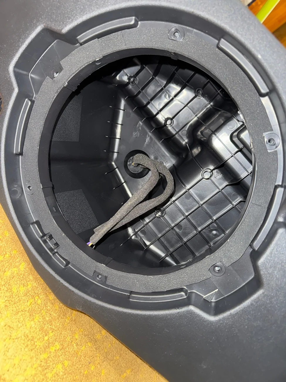

I know a lot of members here swapped their stock subwoofers with the Pioneer option, however due to the low efficiency numbers of the pioneer sub I decided to go with the Kicker 48CWRT104. This kicker not only has a much higher efficiency per watt number, it also lists sealed enclosure volume as a perfect fit for the factory box, which means more kick and less boom.

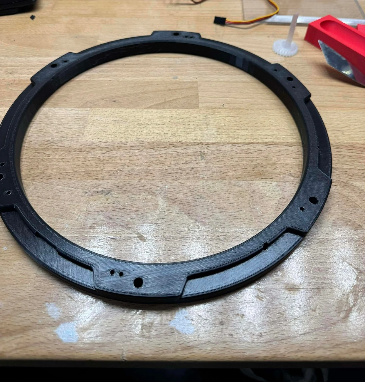

However, it’s not a drop-in option like the Pioneer, it requires new holes to be drilled in the factory box. A Mustang6g member designed a 3D printed adapter ring that alllows the installation without any modification (in case you wanna revert to factory when you decide to sell the car). I found a guy on Facebook marketplace who printed the ring with ABS plastic for $26. I also had to add closed cell foam gasket to seal between the ring and the box.
Progress pictures and results here. This thing moves! Any questions let me know.

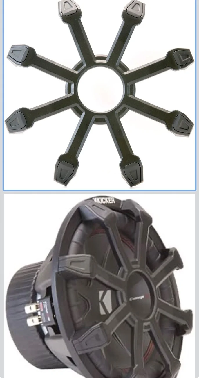

Are you going to add a grille?

I’m gonna add the kicker grill that attaches to the sub itself. It’s coming mid next week. Looks awful but any protection is better than none.

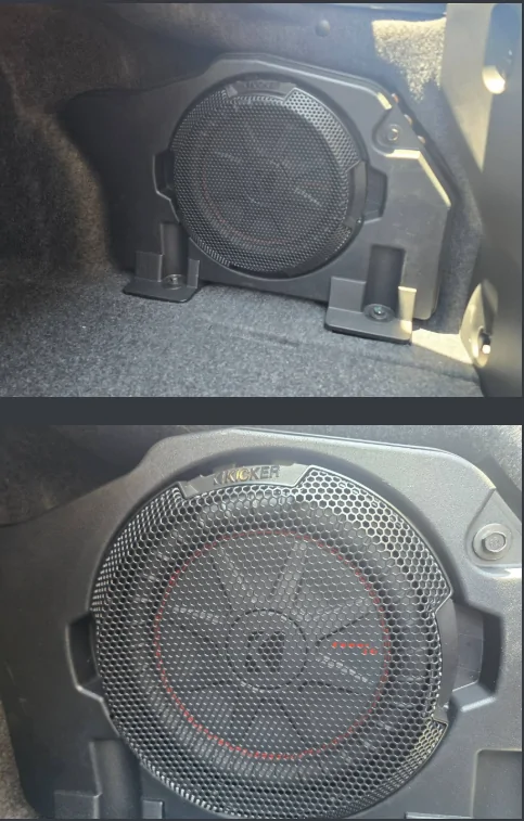

No grill no go, my trunk gets used

I’ll post a picture with the grill next weekend. It has not arrived yet. I needed all of this to be reversible so i got the kicker grill which attaches to the sub’s ring with no drilling required anywhere.

Nice!

which grill is this? The one I ordered looks like a mutated starfish
Post the grill you receive next weekend. I have to see what a mutated starfish looks like.

Good description!
