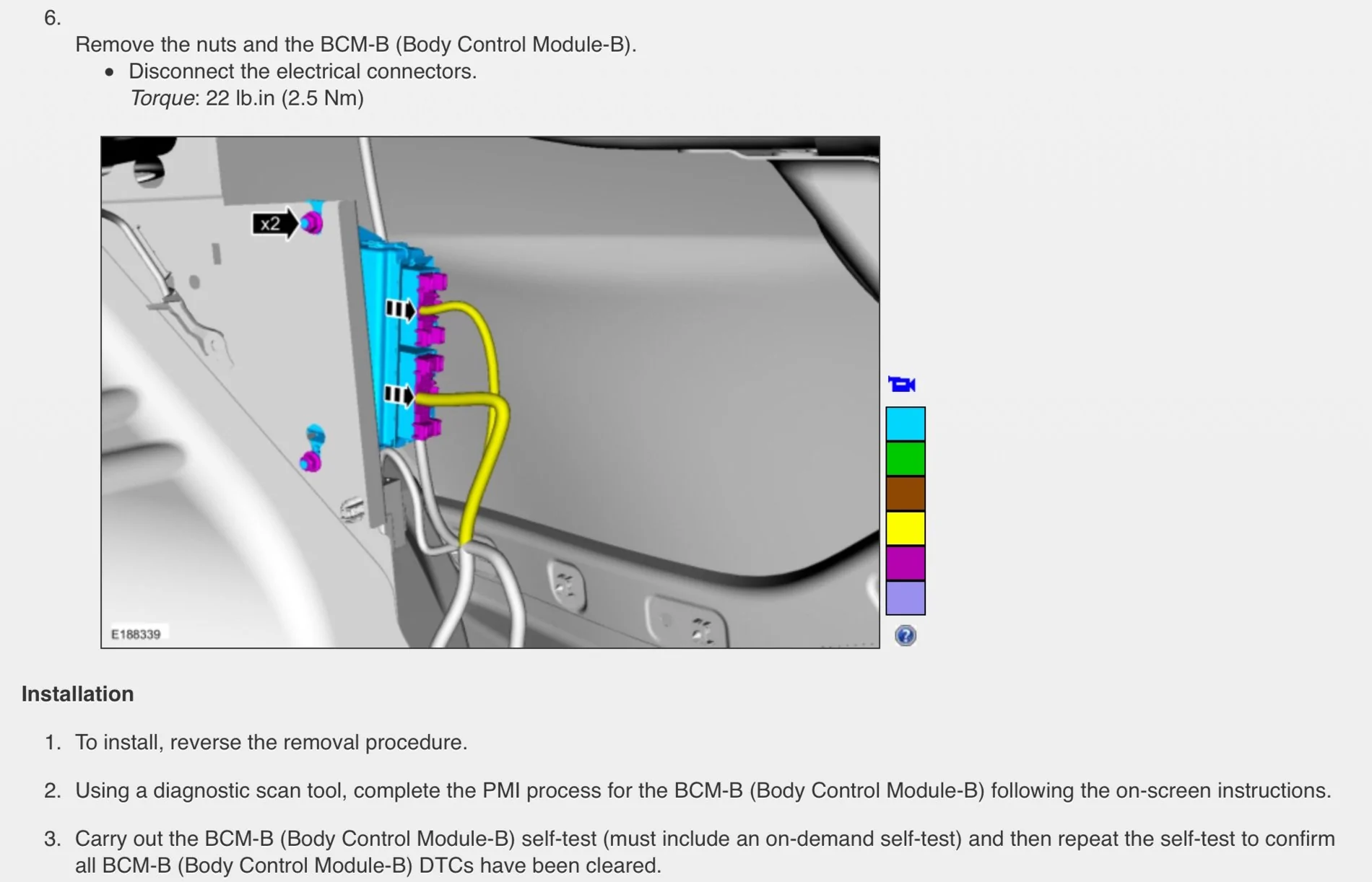

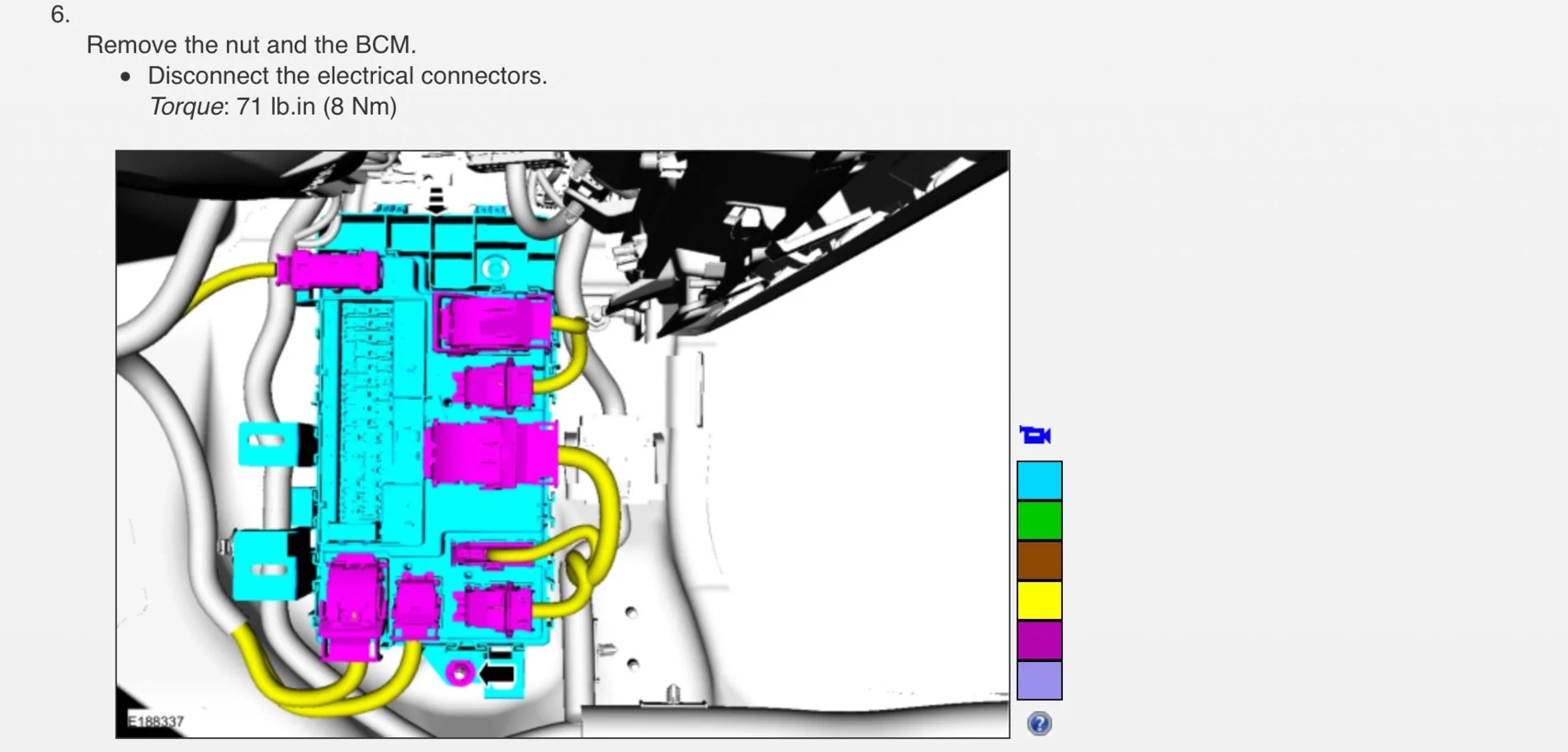

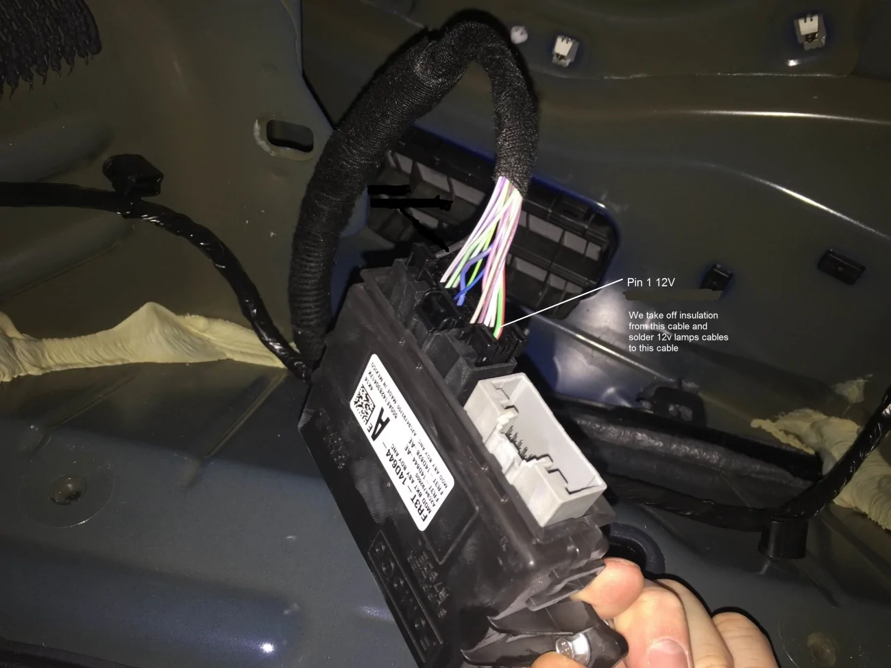

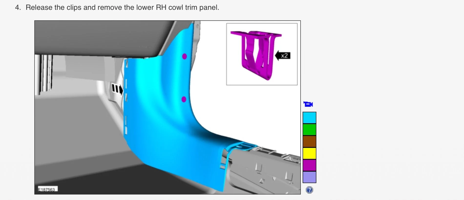

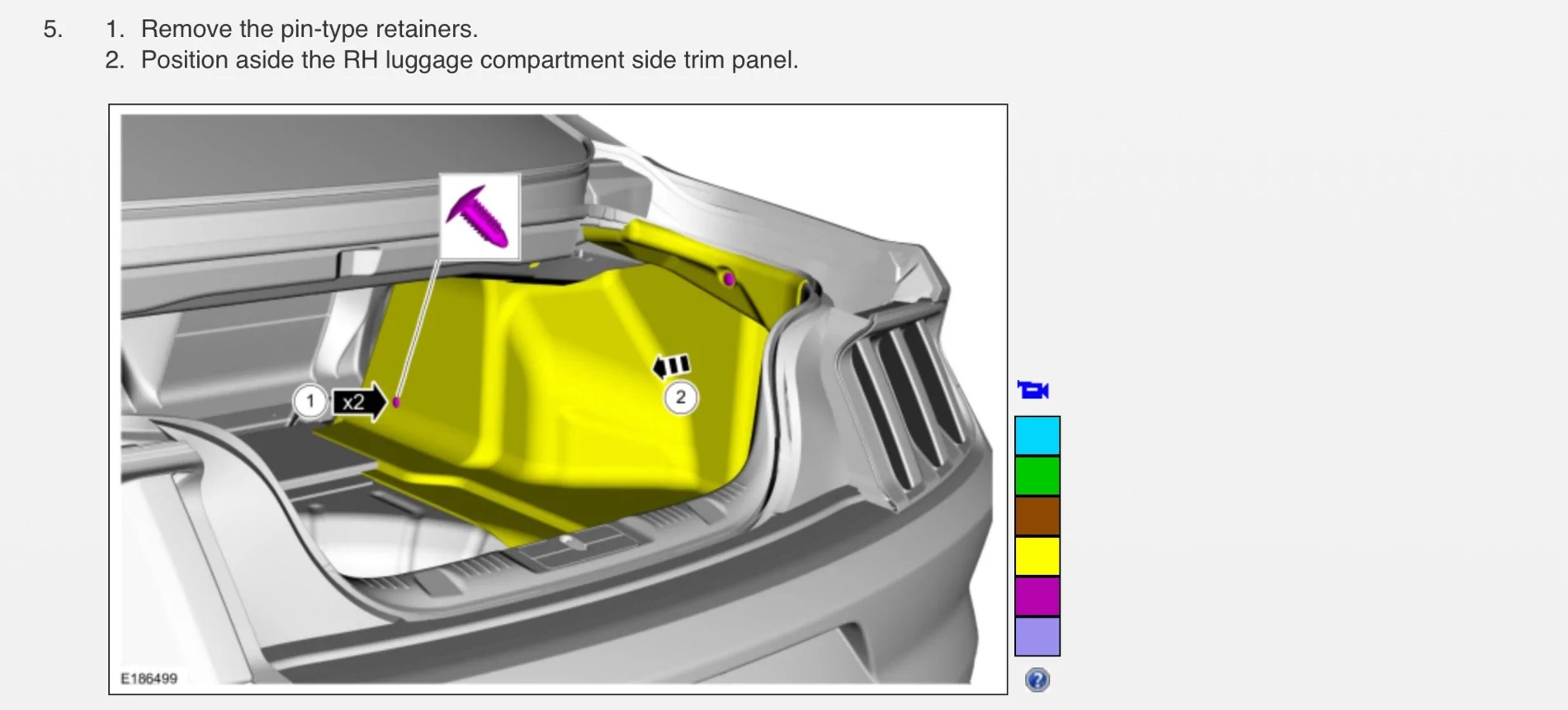

Anyone know where the BCM is located?
The car has two Body Control Modules.
BCM-A: Interior cabin, passenger side, next to where right (US), left (AU/NZ/UK) foot would be placed.
BCM-B: Interior trunk, right side of vehicle, in the general area of the wheel well.
Attached are images for the S550.

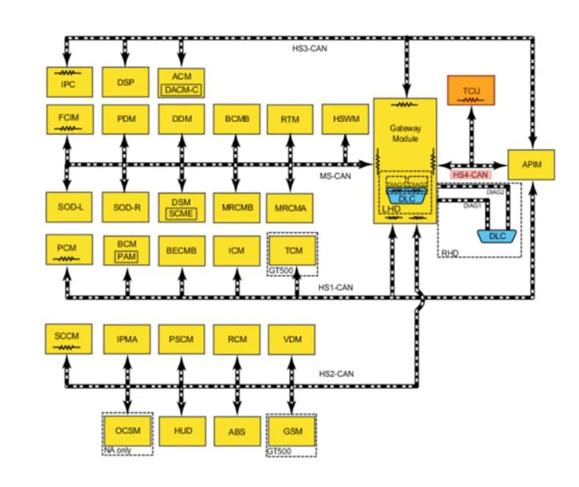

While the Powertrain Control Module is the main computer responsible for the drivetrain, BCM-A and BCM-B are the core computers for all other functions (lights, instruments, security, entertainment, environmental, safety, etc.)
