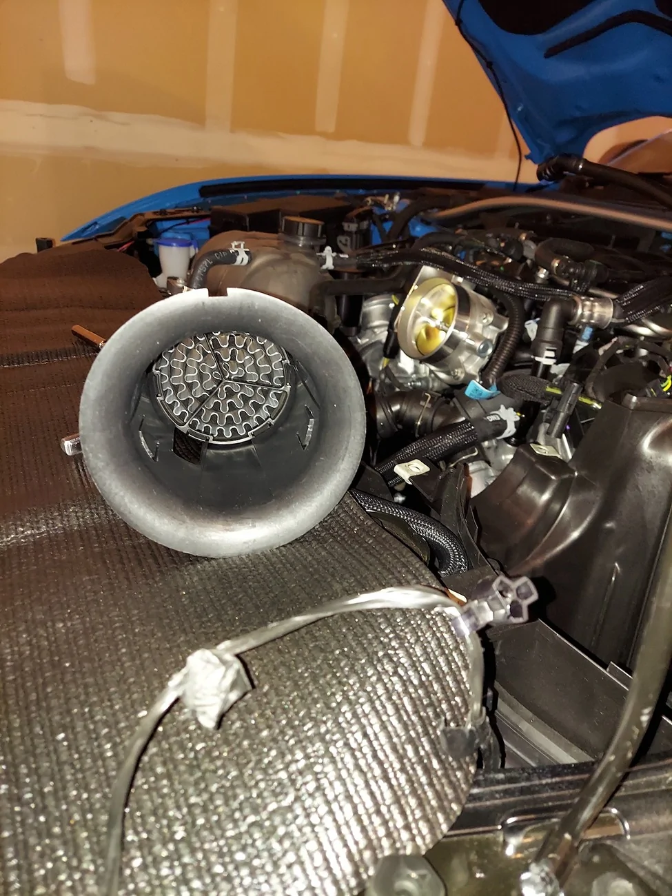

I think the intake sounds normal.
Attached is a picture of what these filters look like. At shutdown, there is still some unburnt fuel in the intake system, gasoline which can vaporize and escape to the atmosphere. The material of the trap captures and absorbs those fumes.
Removing the trap/s and installing an aftermarket Cold Air Intake will change the sound. Installing the CAI by itself can also change the sound.
