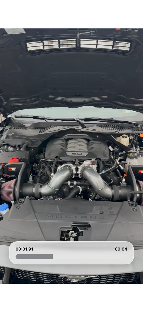

Post a picture of the intakes. Are they just filters, or tubes too?

Bingo. Thats the whole CAI kit. Is the car tuned?

I asked about the tune because most aftermarket intakes kits require it. But I googled that K&N kit and it doesnt say seem to require one. They are boasting 18.84 hp which is ridiculous. And it looks like the PO spend over $800 on that. 🤦
Keep an eye out on marketplace or offer up for a take of OEM. Im sure they can be had for cheap.
