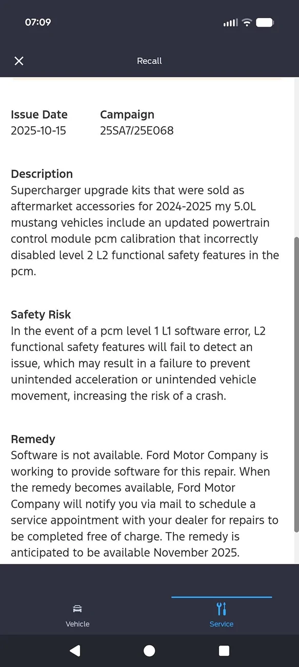

Is this why it was on hold? Someone posted this in another forum (not my pic).
S650 Mustang Whipple Calibration On Hold 1760713882189-xs

  1. Dealer replaced my cats and spark plugs under warranty at FP's recommendation and the repair ticket says that this problem is known by FP
  2. FP had the dealer do a BUNCH of testing on my car to gather static data and a bunch of live freeze frames before replacing cats and plugs
  3. Dealer said that FP told them that the 25SA7 recall listed in the post above from @DarkMatterGrey does NOT fix the melting cats issue
