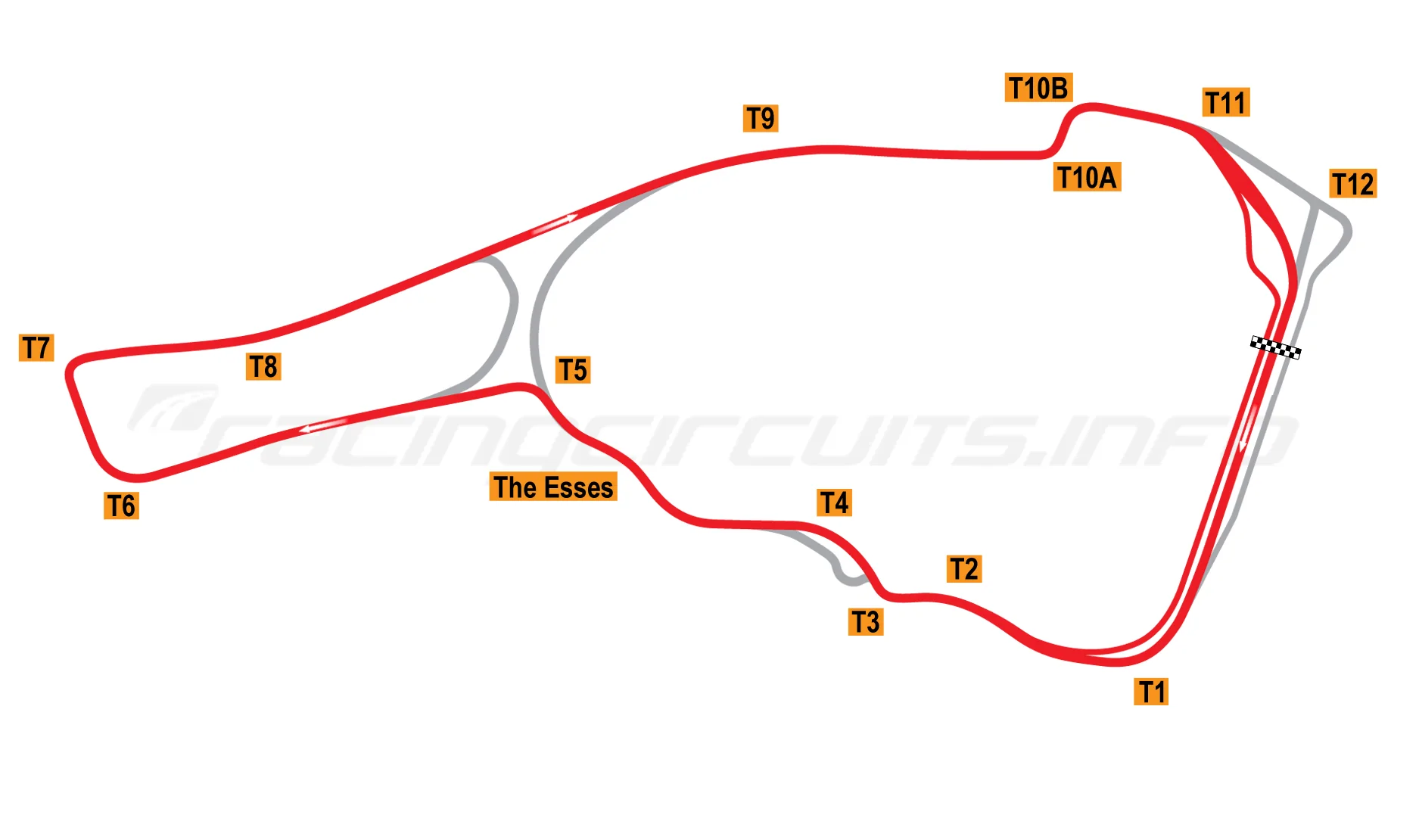

I had in mind something like Michelin Road Atlanta, from Turn 7 to Turn 10A. Turns 10A and 10B are the chicane that they added way back when because the really fast cars were bottoming out at the bottom of a hill before proceeding uphill at over 200 mph, and the downforce from aero and speed and G force from being in the bottom of a U shape, was shredding tires at the bottom of the U. So the solution was to take the big, wide "straight" from Turns 7 through to Turn 11 - what is today Turn 11 - and narrow down the track at the bottom of the hill and make a 90 degree, narrow left turn at the bottom of the hill (10A), then an almost immediate right hand turn to start back uphill (10B).
The track is uphill from turn 7 to turn 9 and then peaks after turn 9, going downhill toward turn 10A. You still have the throttle matted to the floor proceeding downhill until it is time to brake for Turn 10A, where the big wide track suddenly narrows and turns hard, 90 degrees left. There is a huge gravel runoff there at 10A for the cars that go straight off track instead of turning left.
Most HPDE guys coast over the hill and down.
My stock Dark Horse was over 130 mph prior to turn 9, but my instructor had asked for a cap of only 120 mph in the morning and then raised it to 130mph later in the day, so I was doing the same, staying part throttle to maintain 130mph or so. A C7 Z06 Corvette that was solo on the track with me that day had to be well over 140 mph cresting the hill after Turn 9.
S650 Mustang Whipple Calibration On Hold 1762449963259-k3
I do not know how long it would take to go from Turn 7 to Turn 10A with a Whipple supercharger, but 60-130 times on some flat surface somewhere are not going to answer the question. First, you are not going to be anywhere near 60 mph (100 kph) exiting Turn 7. Second, it is uphill once you are able to get on the throttle fully. Third, you will have a hot engine at this point, so you will not be getting full advertised horsepower like your perfectly timed 60-130 flat highway run for bragging rights. Fourth, staying on the throttle through Turn 9 and downhill toward Turn 10A is probably going to be well over 140 mph even on a stock Dark Horse - like I said, my instructor had not loosened the reins on this particular horse on day 1 over 130 mph, so I was part throttle at that point maintaining speed around 130 mph up over and down that hill.
Twenty seconds may not be right, but it is going to be a lot more heat generated on this track than ripping a quarter mile at a time and going back to the pits to cool off.
