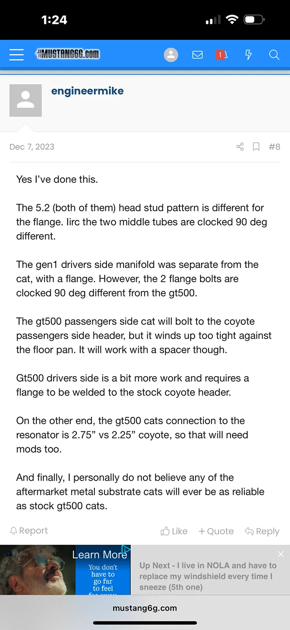

on the predator/ raptor R they have a much stronger honeycomb construction and are larger 2-3/4” so they are able to flow much more and are less prone to collapsing
as a matter of fact for cars that DO want to run cats those would be ideal, I’ve seen someone on mustang6g iirc run GT500 cats on their GT, cut weld BS… more trouble than it’s worth though

excellent info!
sounds pretty darn pricey, but, probably good insurance if you must have cats.
