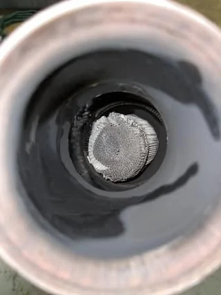

random post on FB:
"I put Kooks catless on my procharged GT and it was great accept my wife complained how bad the car smelled at red lights and how rich it ran so I put the kooks Greens HO on and it took care of the richness at the lights but they only lasted about 6 months before the insides turned into a ball and clogged my exhaust."
S650 Mustang Whipple Calibration On Hold 1760134846106-n0

What causes this?
Ugh. Did cars smell like that before cats?
random post on FB:
You were running rich at red lights? Where did you get your tune?
