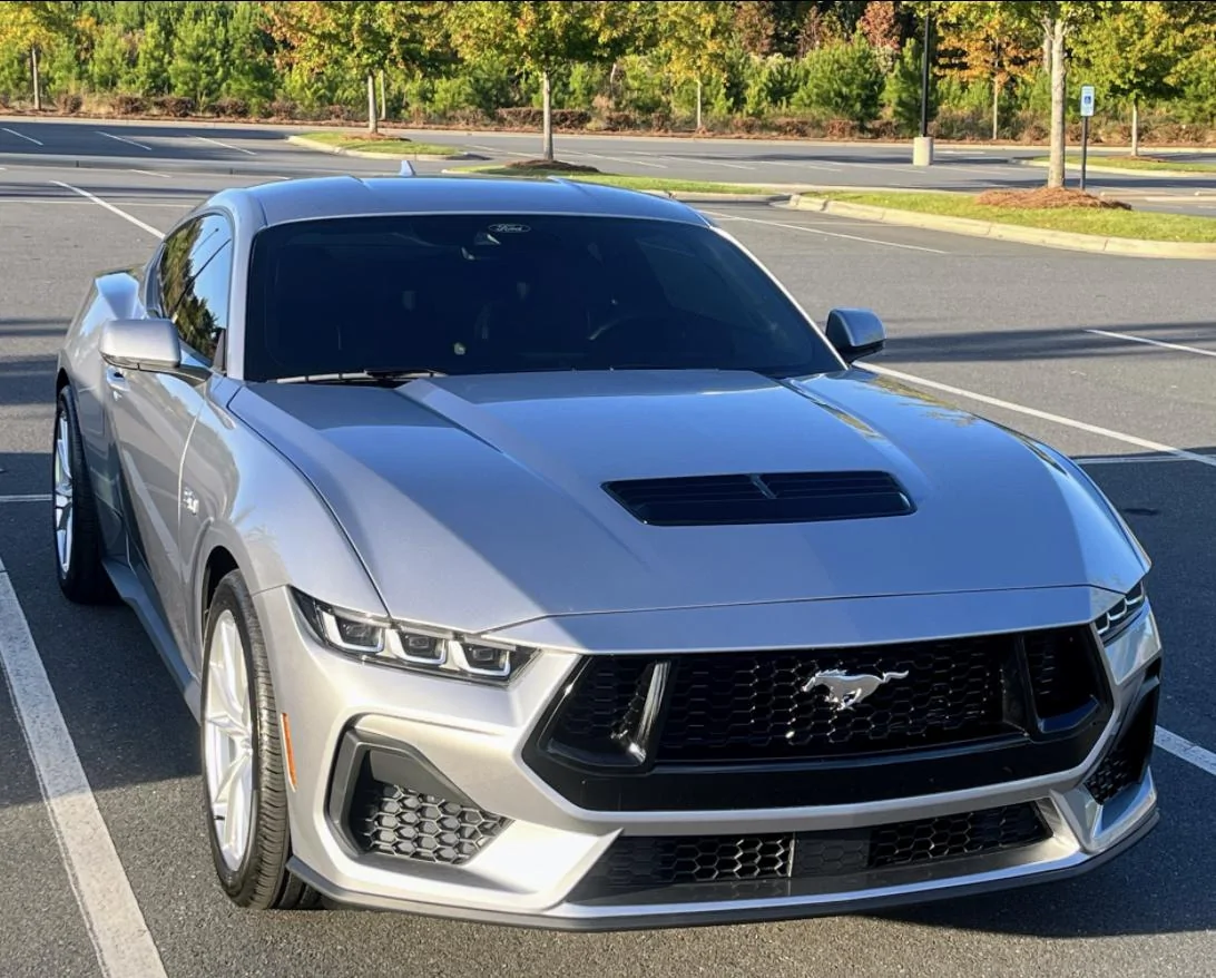

you added those or the dealer put them on? Cause those aren’t an OEM option from Ford on the S650.

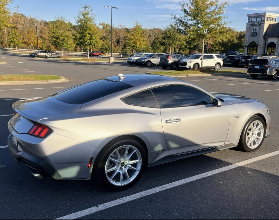

I bought the car brand new with 11 miles and the Goodyear F1's were on the car. I didn’t special order the car and I highly doubt the dealer put them on. All 4 corners 265/35/20.

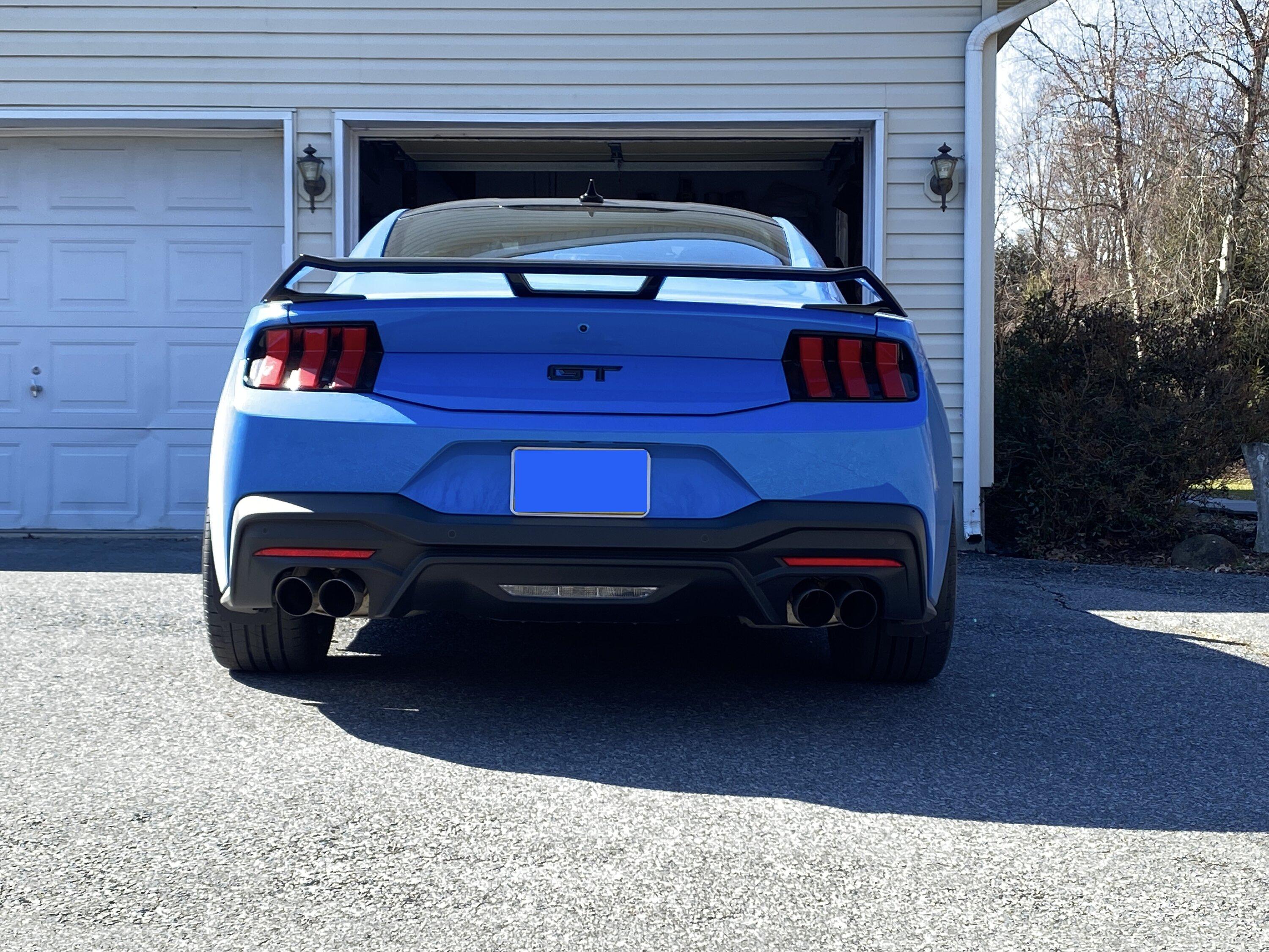

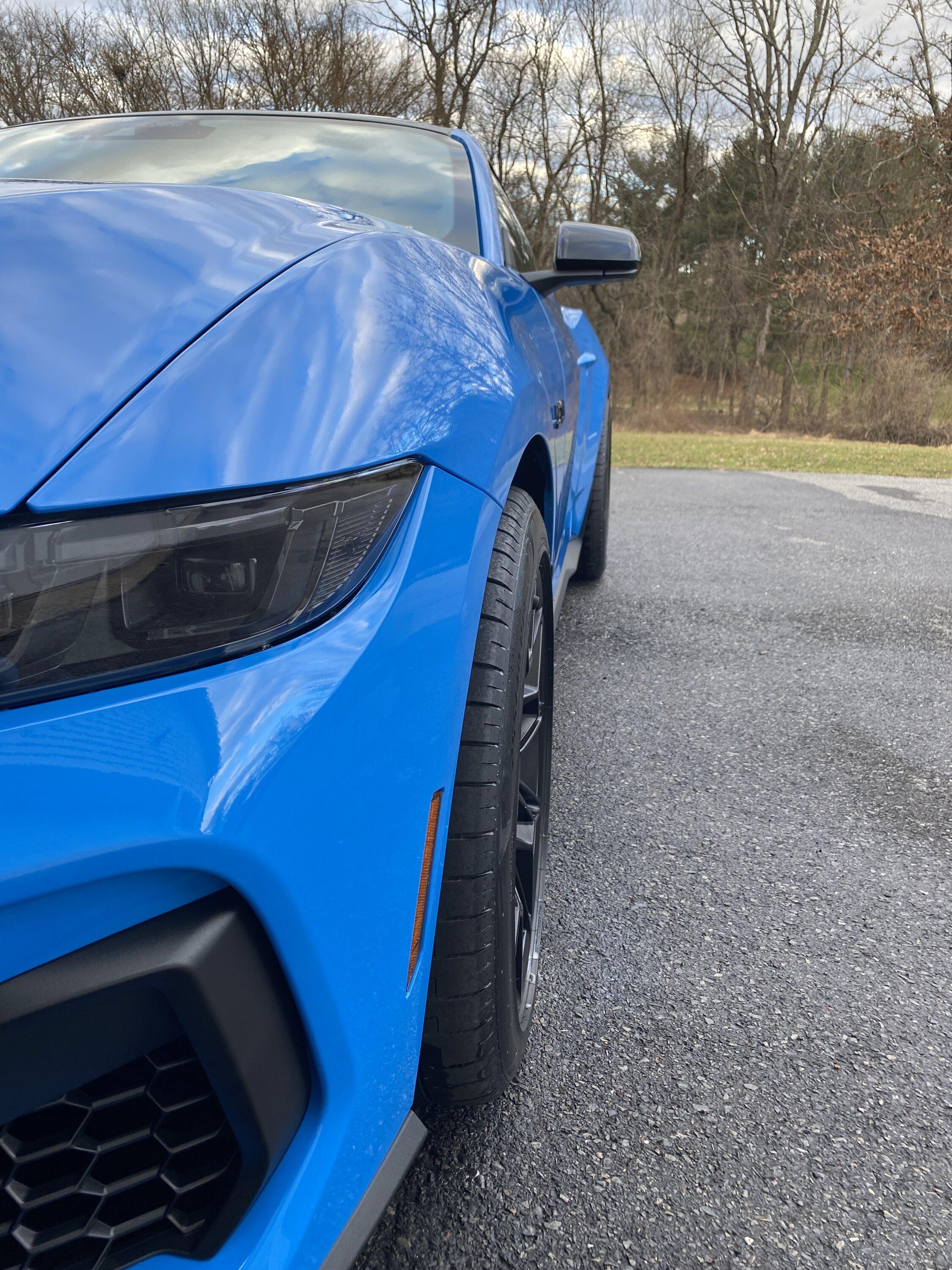

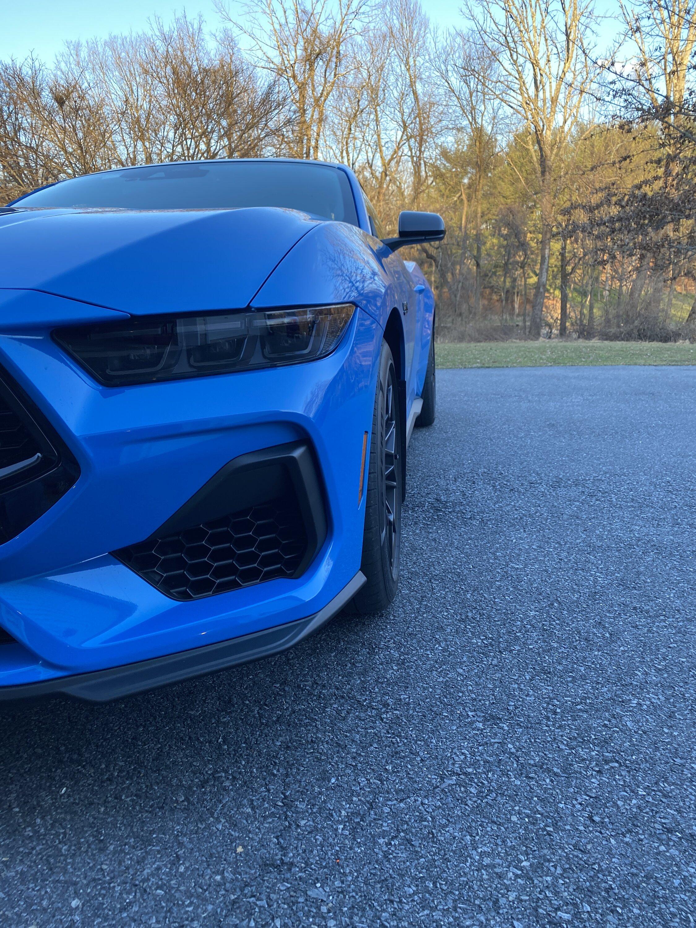

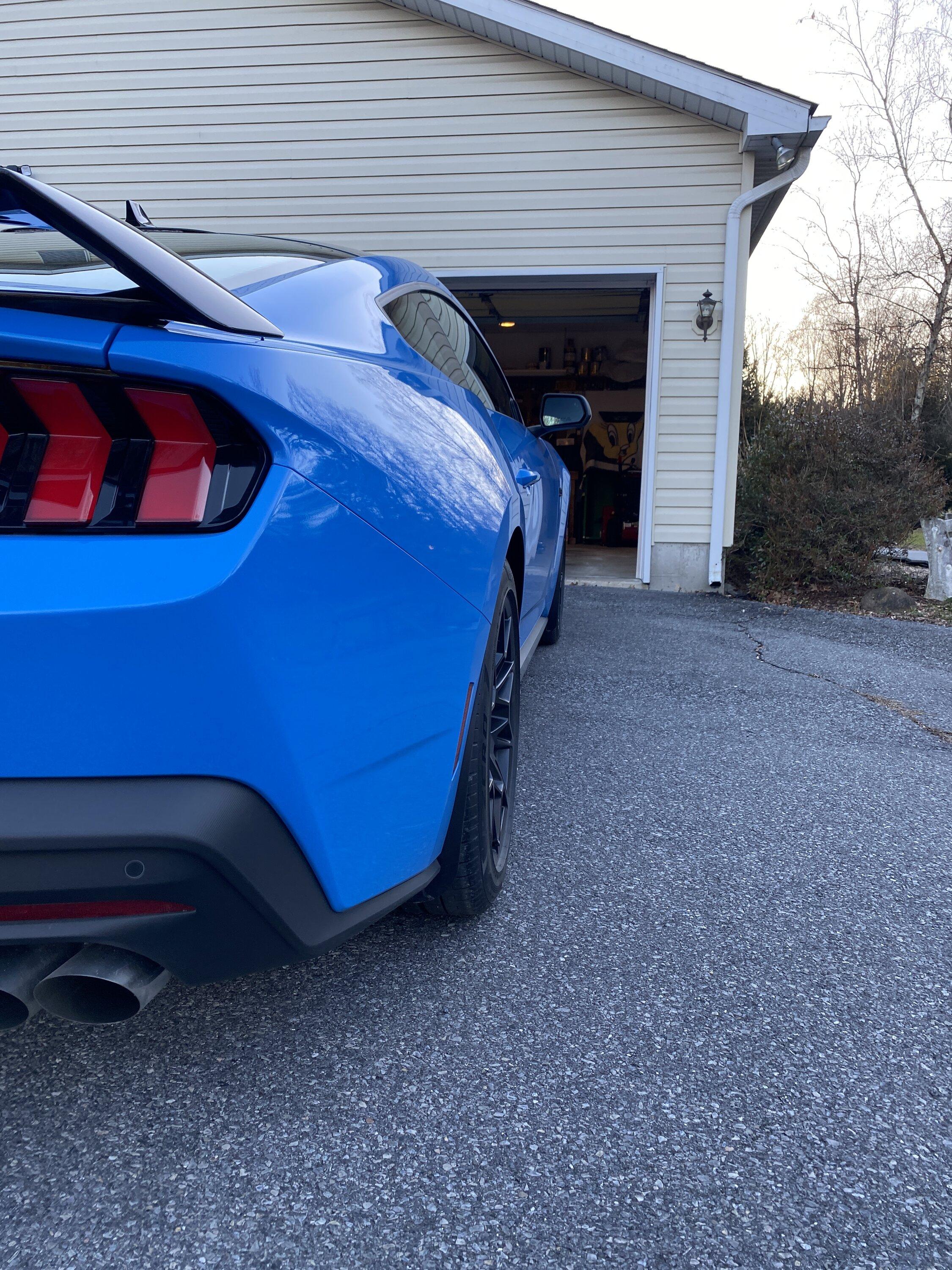

Hello, been looking for a definitive answer and have yet to find one. I originally bought 20mm spacers for the rear and 1" spacers for the front, as I saw it recommended somewhere. I had the wheels off to fix the front inner wheel well opening issue and measured the studs to see if 20mm and 1" spacers would sit flush. I have a GT Premium with PP so it has the stock 19” x 9” (F) 19” x 9.5” (R) Black Painted Aluminum Wheels. I did not think there was enough notched space behind these particular wheels to accommodate the length of the studs when putting on the 20mm spacer set. The 1" spacers looked like they would just barely fit without having to cut the studs so I kept the 1" spacer set. Before I order another 1" set and put 1" on all four, can anyone confirm that 1" spacers WILL fit flush for a GT Premium with PP that has the 19” x 9” (F) 19” x 9.5” (R) Black Painted Aluminum Wheels?
I'd appreciate any information you could offer. Thanks.
Woobar
Nov 1, 2023
PA

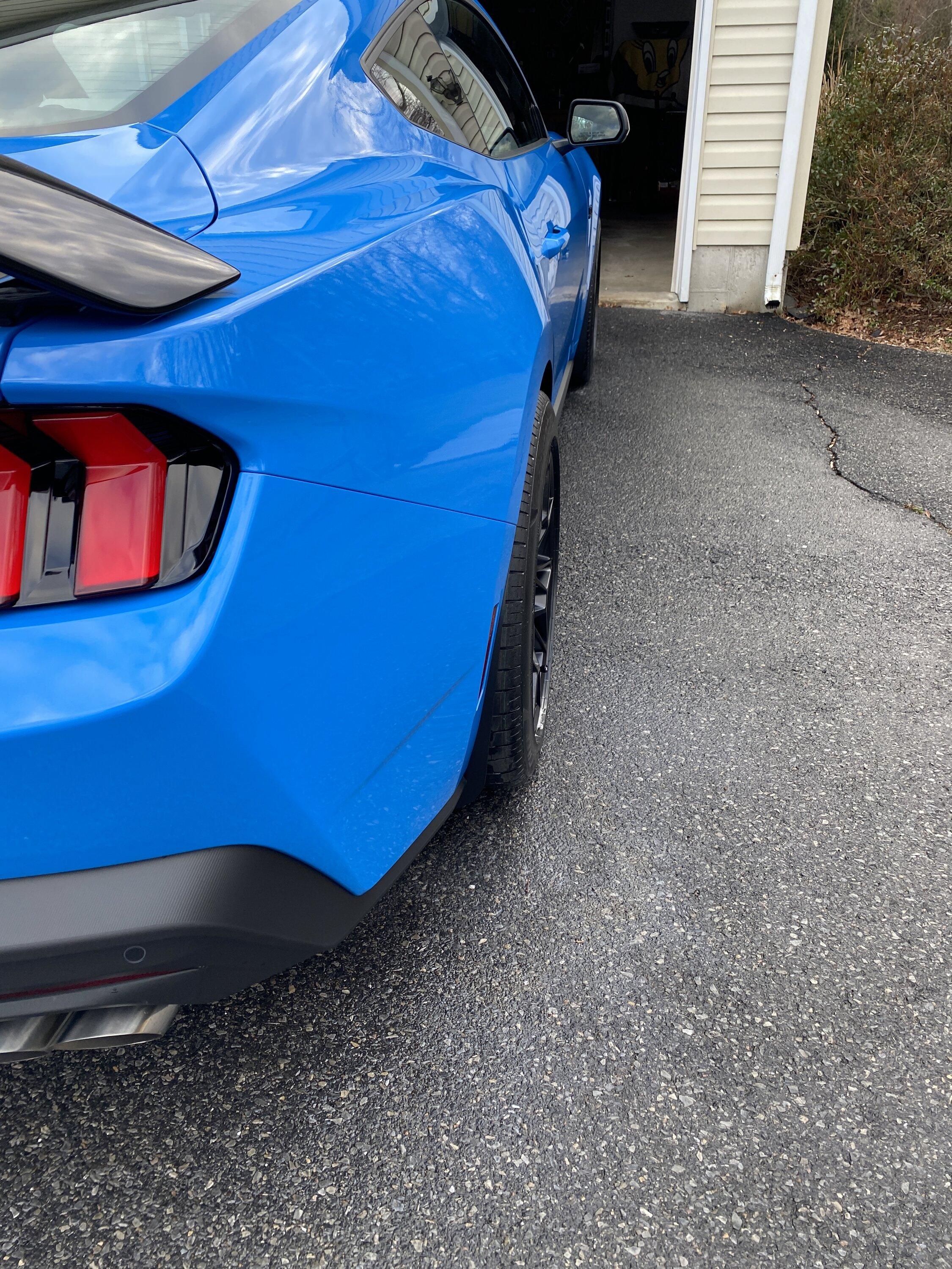

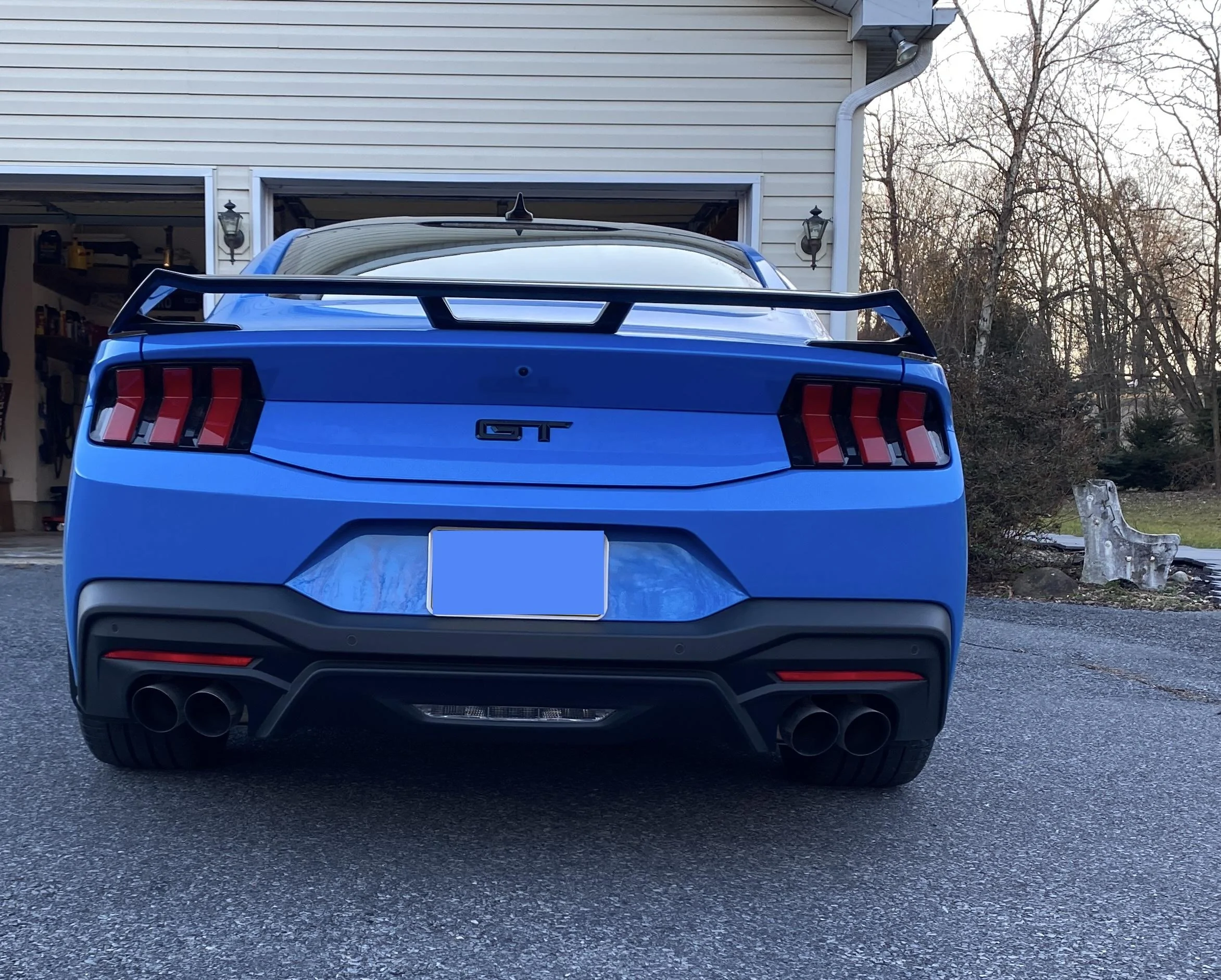

Found a video stating the 1" spacers do fit the stock PP wheels...and they did. Here are some pics in case anyone wants to see what they look like before doing it. Wanted 20mm on the rear but they would not work on my wheels so I went with 1" all around and I am pleased with the look at the moment.
