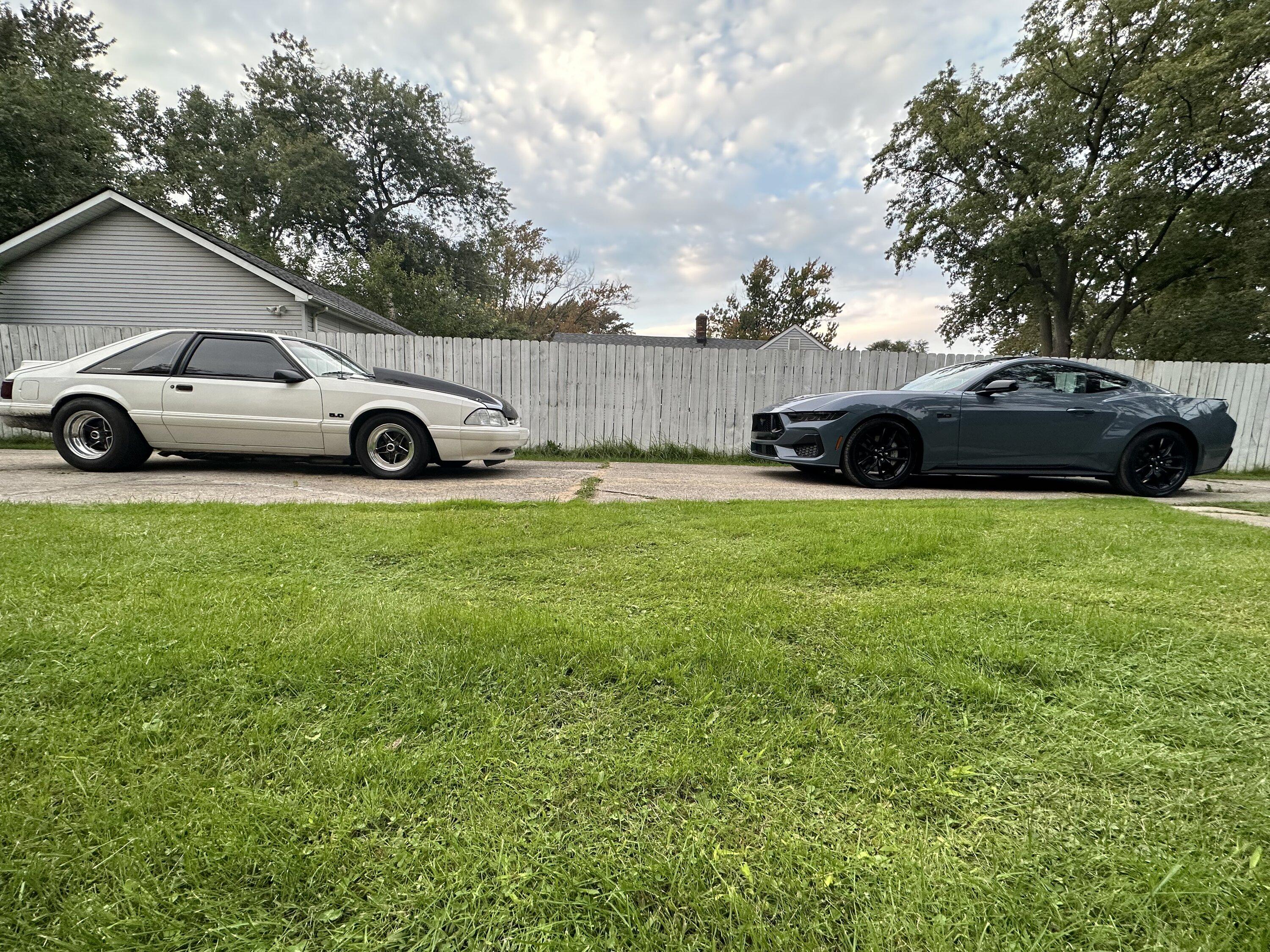

25mm is 1 inch I think, I haven’t had any issues with driving or turning.
the Only comparison I have is my fox and this car does NOT scrape where my fox scraped exhaust
S650 Mustang Wheel Spacers!! IMG_0891

Ok, so with 1 inch on the front you don't worry about space when wheels turn that is good.. now for the rear, considering that the tire is almost sticking out of the actual frame (which is what makes this thing look so awesome) when you hit a bump or anything, you don't get any scraping of the wheel against the top part of the wheel cavity in the car frame?? that is my major concern.. i have 1.5 inch rears, but i am worried that hitting a bump while driving will strut the car down a little and it will connect with the frame..
Doug
based on what you said, i might just try the .25 in the rear and if that works just get it for the front also.. and keep them that way..
